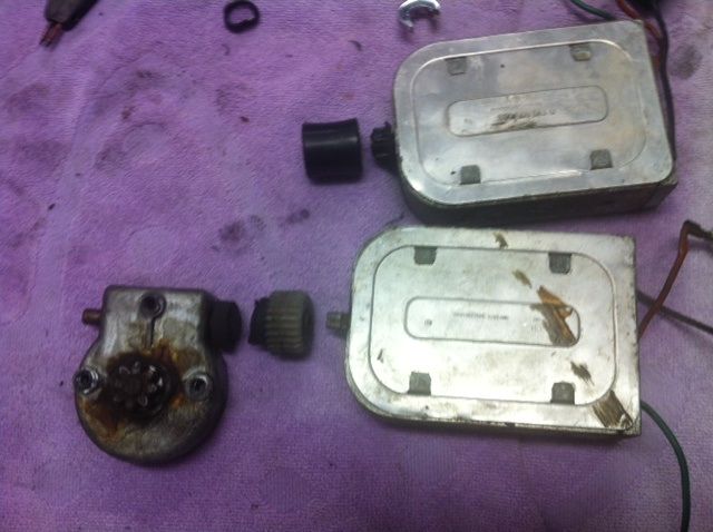

Well 3 weeks before Monterey and my rear right window stopped at the half way point.

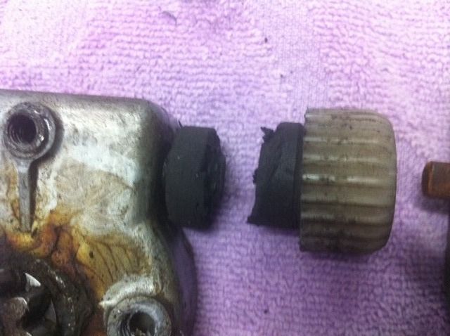

Using deQuinicy great write up I got the window out and apart and this is what I found. The rubber between the window motor and the gear housing is split into two. There are 4 bolts the hold the Sardine can motor in place 1 bolt was missing so someone was in there is the past.
The rubber looks like it was glued in.
I have this motor but it has a different end piece.
So guys what are my options?

I would think Carl N or Coupeking or Double 02 Salvage would have a replacement rubber piece for you.
Call Double 02 and see if they have it. I drive up to Fairfield two days a week and pass Double 02 to get there. If they have it, I'll pick it up for you and we can meet in Fairfield. Less of a drive for you that way.
Christ alive they want $100 for that?!

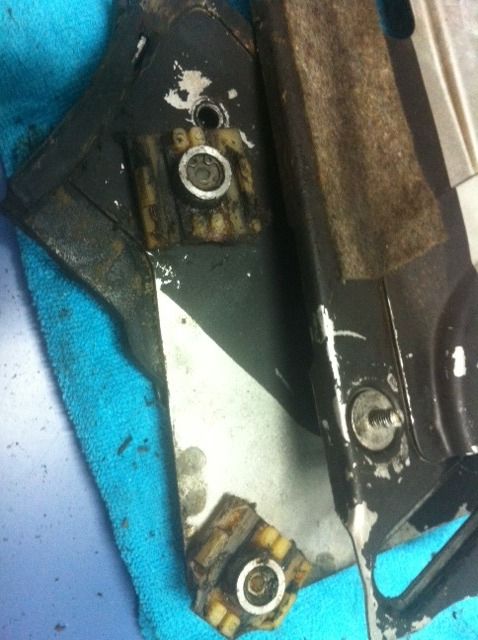

those nylon runners look as bad as they did in my car. Took a good amount of time to clean all of the old **** out of them.
When you call them see if they have the rubber stoppers that set the travel limit. Two of mine were destroyed, and as a result my windows sometimes stick in the up or down position. New rubber stoppers would fix that. Hopefully I can grab those while I get your parts.
