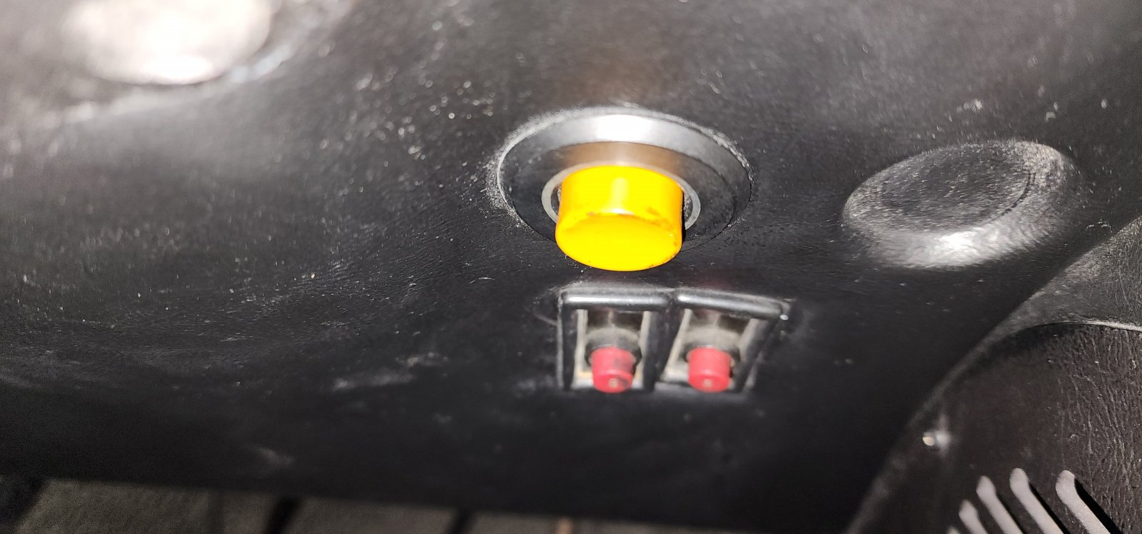

Have you checked the 2 red fuses under the dash?

GOD BLESS YOU. It was the fuse. TIme for me to stop working on car! I should have thought of that

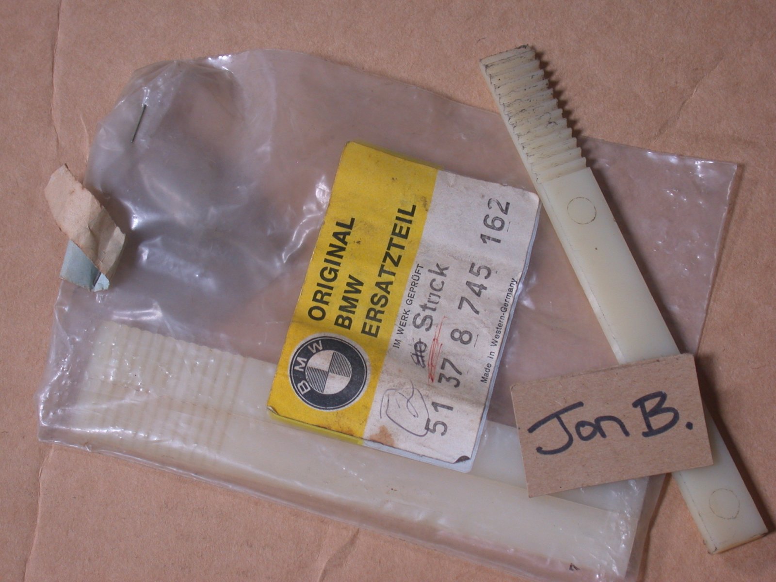

I know that realization all too well. Sometimes the hardest part of solving a problem is knowing when to give it a rest. It does take forever, which I think must be why they made a tool to do it. I'd never actually seen the tool, which made me go look for one in the FAQs. Of course @HB Chris had posted a nice picture of them in the tools FAQ. Even with the tool it still looks like it would take forever.
The window "comb" reminds me of a series of toys from my childhood. I am a child of the 70s, and there were these toys called SSPs. They were cars and motorcycles that had a relatively heavy flywheel in the middle that had a rubber "tire" around them. You would thread a toothed ripcord into the toy and pull it out as fast as you could. The teeth on the ripcord engaged with teeth on the flywheel and spun it up to a pretty good speed. Once going you'd set it down and the energy in the flywheel would power the car forward (for a while). They were pretty cool and very robust. Also ambidextrous if I remember right. The ripcord could be threaded into a hole on either the left or right side of the car.
