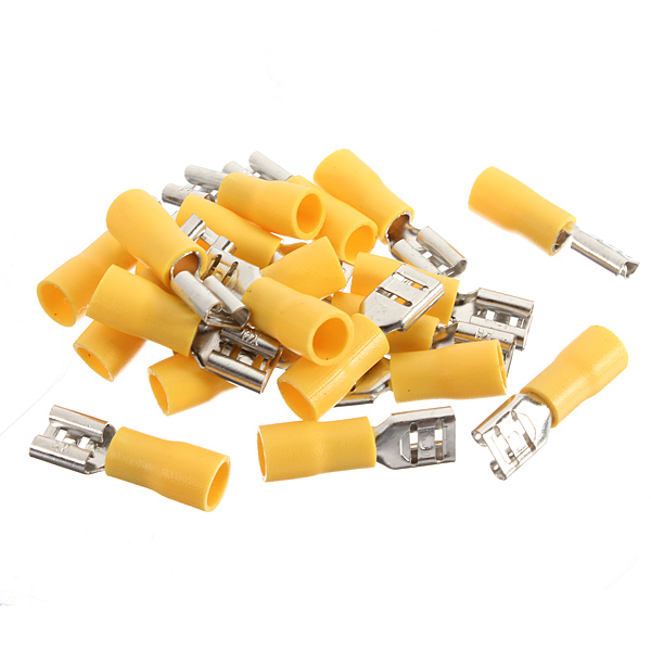

Your last comment suggests you have the newer, round pin-type switches available. They can be adapted to work with common connectors. Not the most elegant solution, but a fix nonetheless.
