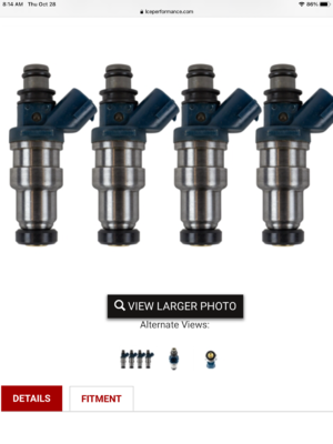

Have you considered the new electric carburators?

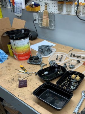

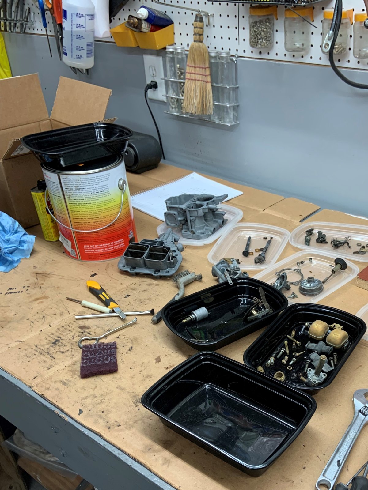

One of the DGAV32/36 Webers is apart and cleaned while leaving the second one assembled. The parts will be in this week and when the first one is assembled, I will attack the second one. I have fixed the sticking secondary throttle shaft. I will be using the Pegasus throttle shaft bearings for the primary shaft bearings.

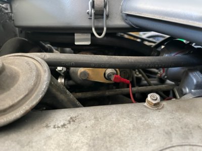

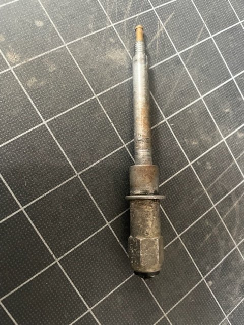

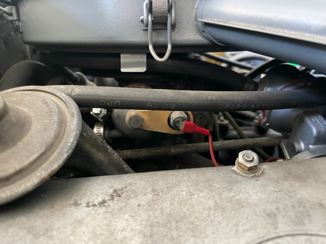

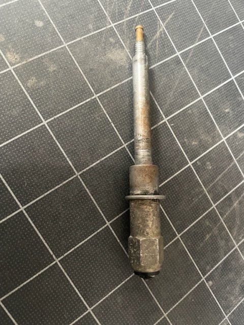

I have 32/36 DVAV33A weber carbs on my E9 as well. Are your idle valves being replaced as well? The reason I ask is one of my idle valves (solenoids) on one carb has broken off the metal tip that connects it. So my car will not idle (runs great other than that). I am looking for another idle valve. If you know where I can get one or have one for sale that would be great (I've attached a photo of the idle valve I need to replace). Thanks and hope all goes well with your rebuild...E

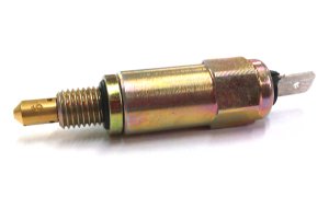

I saw your previous post and the pic you posted is different from what I have on my Webers.
This is one I ran across while searching for parts and looks similar to what I have.

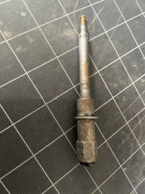

Looking again at your solenoid I am trying to understand how it is held in. Does it unscrew at the silver washer from the long tube?
The end with threads screws into the carb. That's all that holds it in. But at the end that handles the wrench, there is a metal piece with a hole in it that the solenoid goes through that gives some support. Maybe you can see it in photos...red wire goes to solenoid

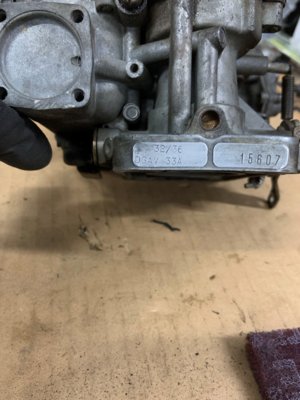

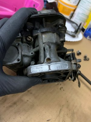

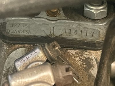

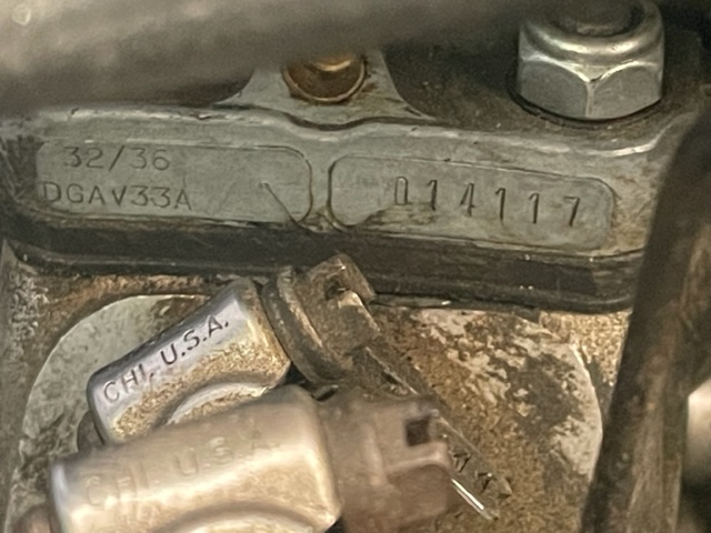

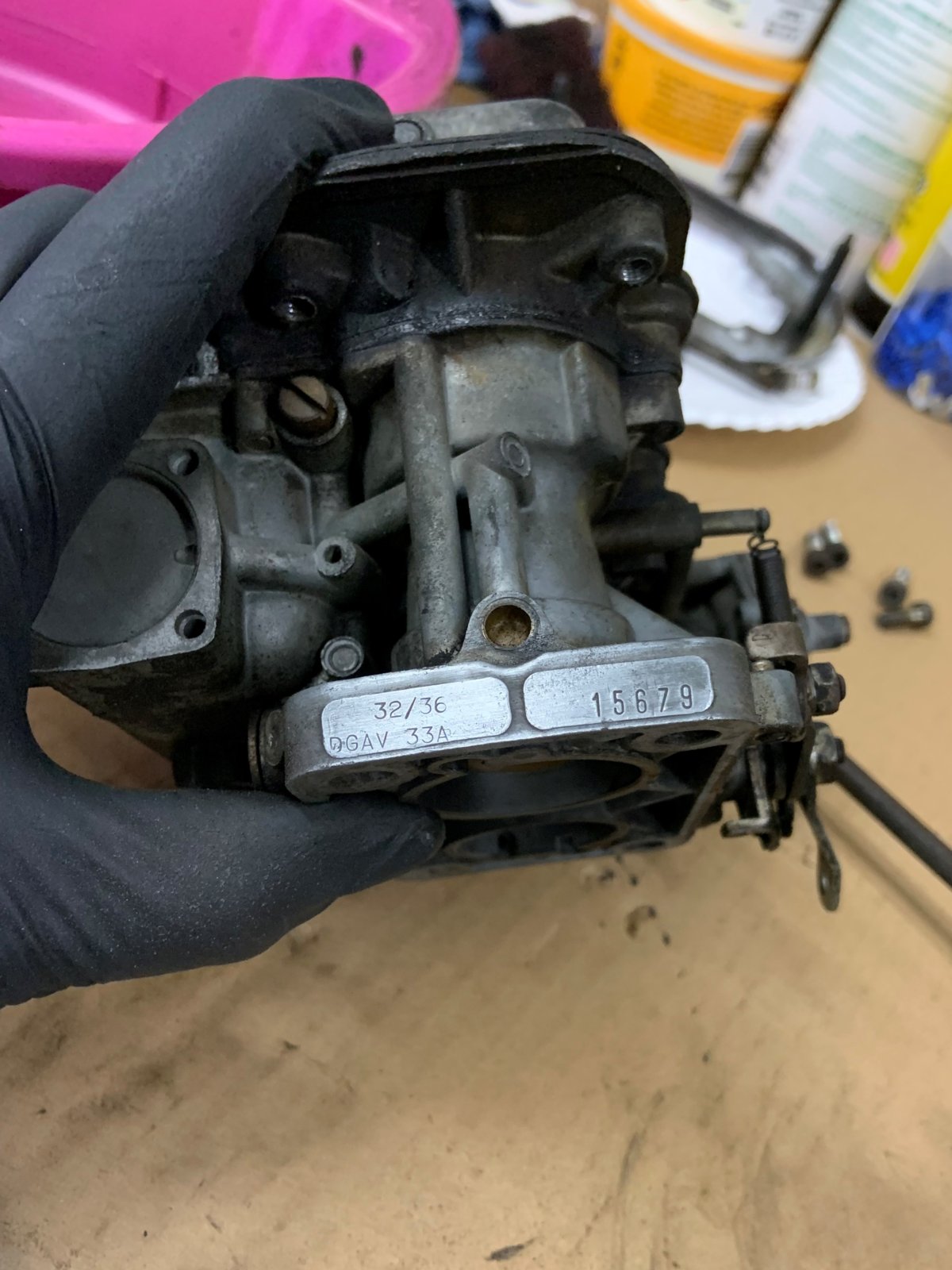

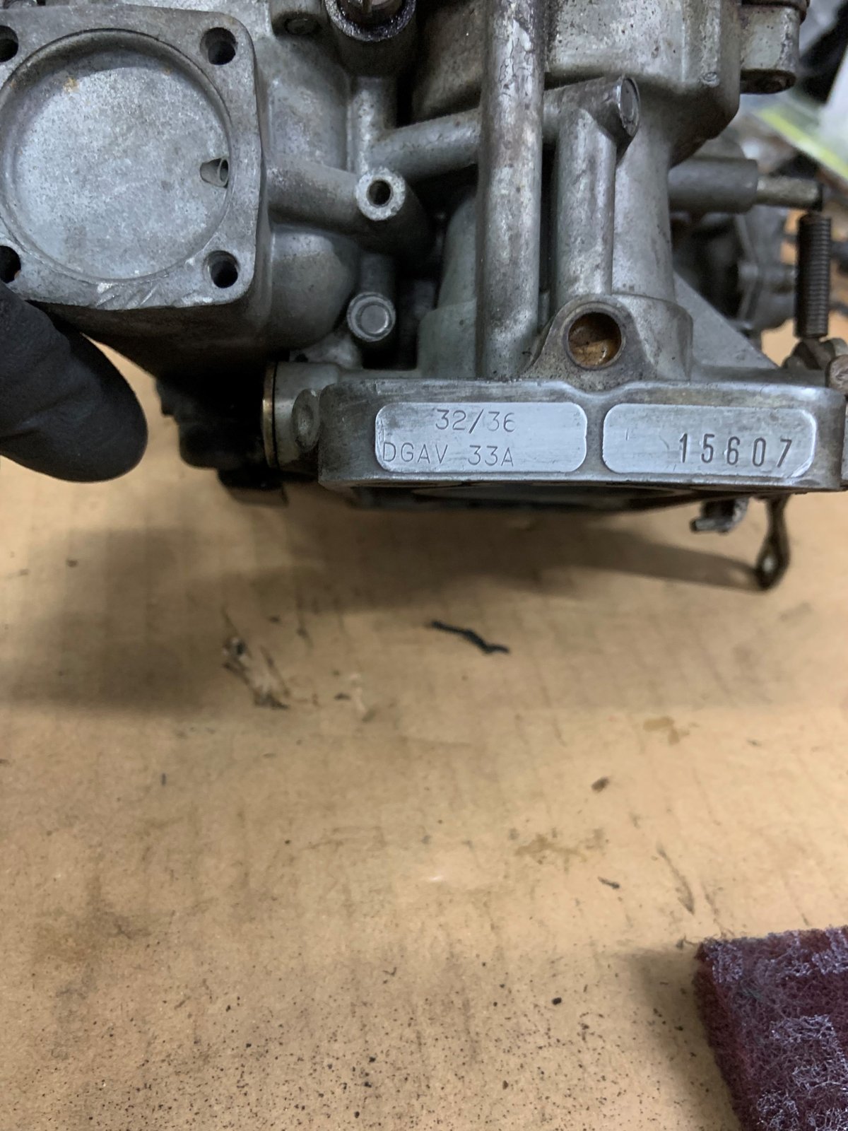

OK, I see the threads way down at the end. Not sure why it would be that long. On the shorter ones on my Webers the brass end piece will pull out. I wonder if the long piece will unscrew from the solenoid at the silver washer. Also, on the ones I have the brass plunger will pull out from the solenoid. My serial numbers are 15607 and 15679. The stamped numbers look different from yours.
I would just spend the $30 to buy a new solenoid and try it. They are short and do not need a support plate like in your photos. Normally the short solenoids are not accessible when the air cleaners on, so maybe Weber made these long ones so you could test for cutoff with the air cleaner on.

FWIW, I spoke with a Weber expert at Worldpac yesterday and he did not recognize the picture of the long idle solenoid valve on the @ECA90049 carb. He suspected it isn't a genuine Weber carb. Edit: However I do have a Weber from a 2002 that was made in Italy with the 3rd mounting point for the water thermostat that has the smaller hole for an electric idle valve for that carb. I do not have an electric valve.
On top of the carb should be a Weber emblem with either Made in Italy or Made in Spain. Weber manufacturing moved from italy to Spain around 1992.
I ordered another, shorter solenoid I found online for the 32/36 carb (can't find the long one anywhere) but it has a larger thread so won't fit. I've looked all over the USA, Australia, England and Italy and been told consistently that the carb I have has not been made in decades and nobody can help. In fact, you can't even find it on the historic parts list for Weber. I give up. After the first of the year, I think I will just pop for new carbs. Any recommendations?

Got the new solenoid, but the treads are larger. At this point, it looks like new carbs are in my future...
