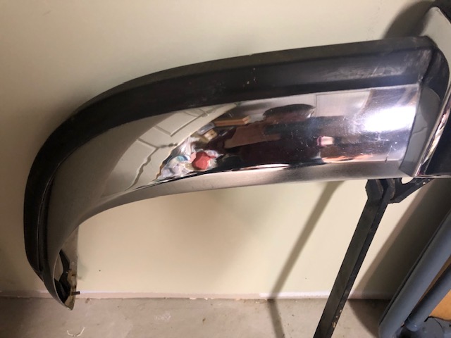

I am sure many of the products suggested here will do the job, I tried several of these for on my Vent window, outer wdo. belts and both bumpers. The white vinegar with the aluminium foil wad (pour the vinegar on the foil) scrub hard and rinse with lots of water produced the best results. It took a lot of foil and a quart of white Vinegar. This was completely corroded when started. I used a two part grey epoxy paint on the inside of the bumper looks like new. Lots of good advice and experience here for me it's trial and error and preference. Good Luck!
