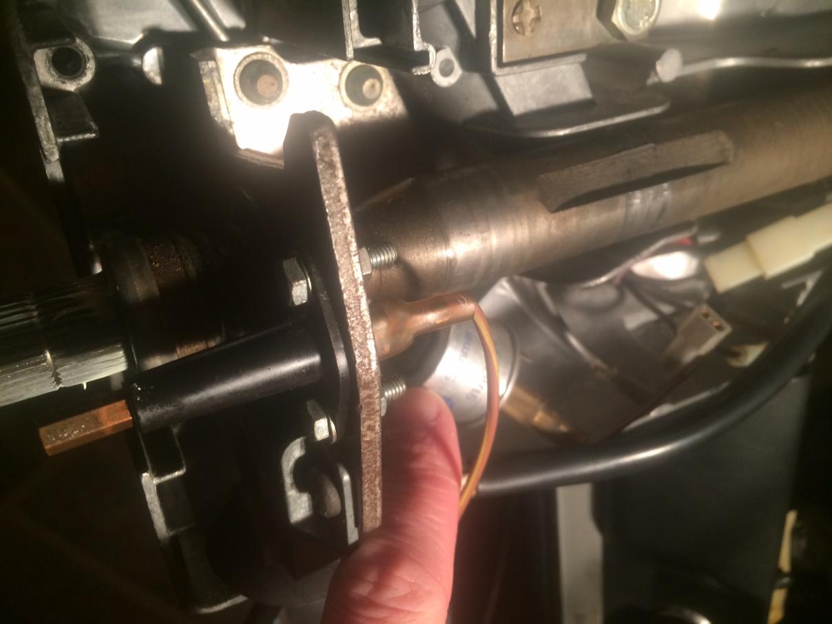

Working on my 73 3.0 CS: I had the dashboard speaker out today and noticed a relay behind it with wires unplugged (previous owner unplugged it, i guess). It's a silver hella, and it says "Summer" on it. One of the wires in is hot (12V) and one is not. It's not truly a relay since it only has two plugs (one in and one out). Any ideas what this is for? I have searched forum and haven't found anything...

Any chance of a photo to help?
relays/switches
Here is the fasten seat belt switch in the left hand picture.
What is the switch under the steering column in the second picture? It was unplugged. Same Hella type switches.

the one behind the speaker is the annoying fasten seat belt buzzer and the other is the annoying door ajar/key in buzzer
