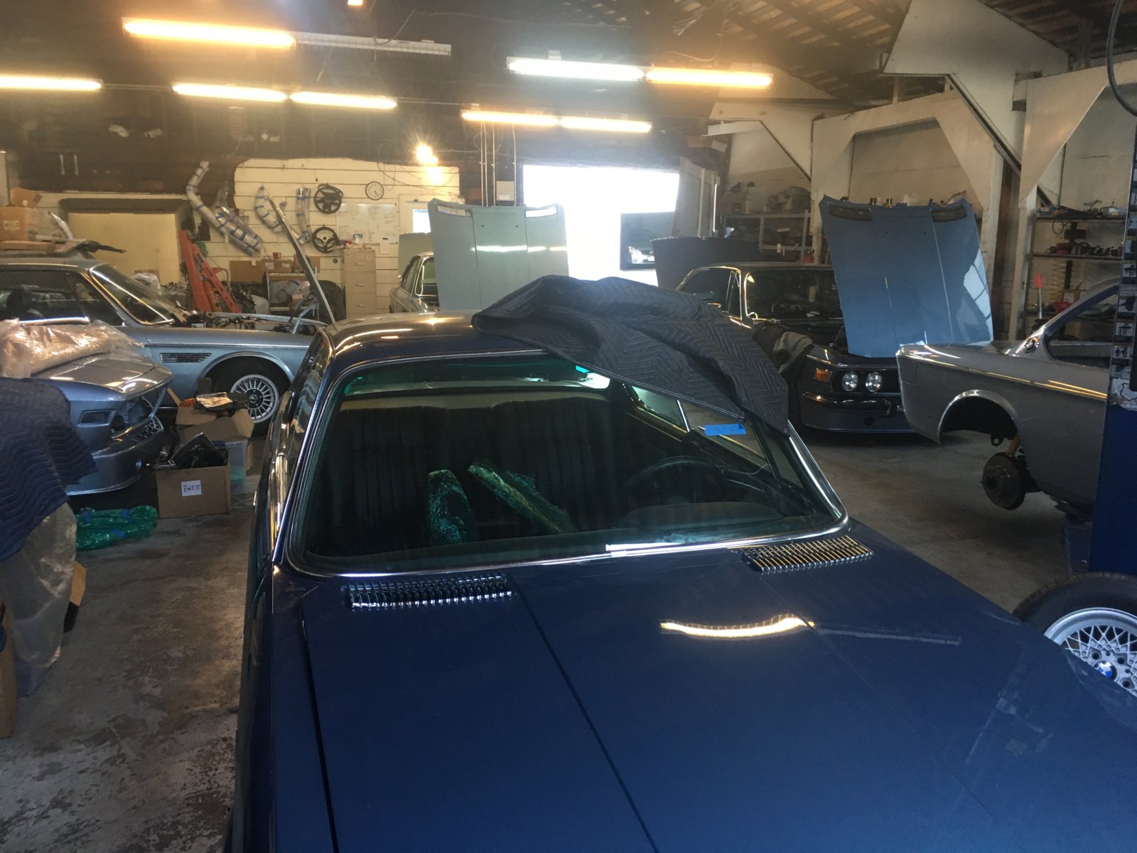

Don’t expect a miracle... they all are different. 8FF8DB81-4DF8-4E2A-B050-842551E582E0.jpeg

I have not found any match for Fjord, my coupe has a little more blue. The color changes with every mix & brand of paint.

As above, fjord is many colors depending on who mixed, what paint system, how good their eyes were, age, etc. It's not straight out of the can and onto the car.
