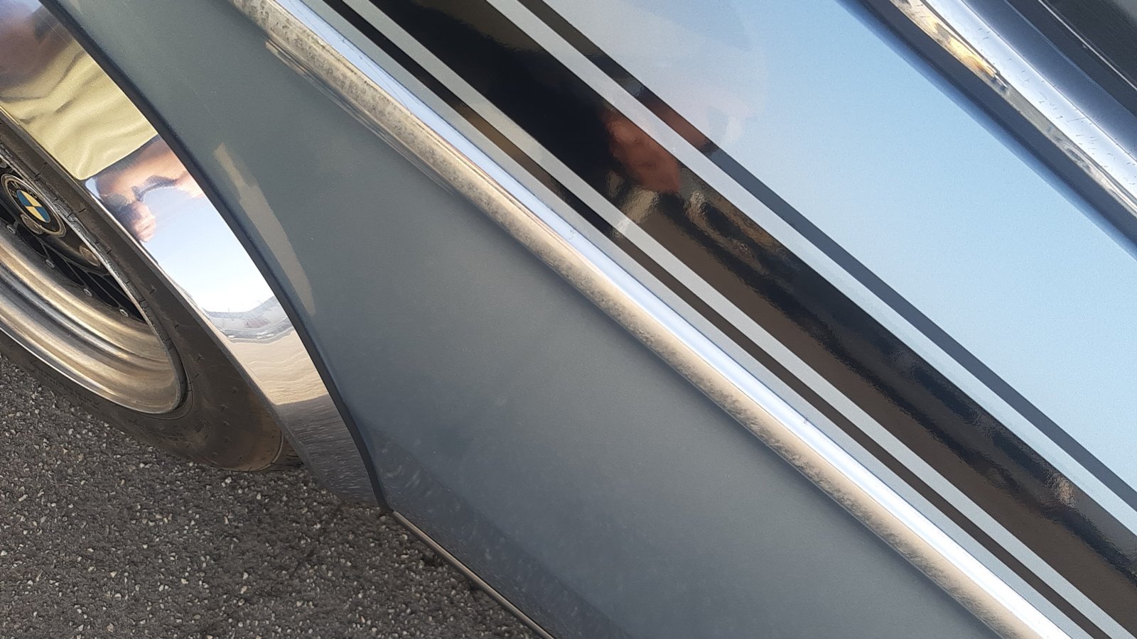

how to remove stains from the glass frames and the aluminum moldings that are around the machine .... after washing some whitish stains came out .... I am angry.

Hey Gianni, sorry to hear about your experience.
Are the spots only on alu parts? no white spots on other materials (chrome, rubber, glass, paint?)
are you sure these aren't spots of dried calcium from hard water (i guess not, as the rest of the parts on your car seem still nice, but just checking)
It would be important to know if your trim is original, meaning bright anodized, or if they have ever been restored. If restored, then usually 3 options exist: 1. keep them as polished bare aluminium. Option 2. is to use some sort of protection: wax or paint. option 3 would be bringing them back to anodized.
You can check if it is bare aluminium or anodised/painted by trying to run a current over it: Anodising and paint will act as isolators. If it is just polished aluminium, then you can let a bulb burn using the trim as a wire.
Knowing what surface we are looking at will make it easier to identify the failure mode and to start digging into a 'way back'.
Assuming your trim was still original (anodized, then look for ingredients of the used soap such as NaOH (=Caustic Soda=Lye=Natrium Hydroxide), KOH (=Caustic Potash=Potassium Hydroxide or (not common in soaps): chromic acid or phosphoric acid.
If your spots are only on bare aluminium, then I would suspect ingredients being (slighty) alkali or acidic.

Wait. The car got washed and it did that to the trim? I would definitely start with different types of cleaners before going to acids, solvents or sanding. What was used to wash it? Ingredients? Maybe some macro photos to see what's going on with it.
Just as @Dan Wood suspects, I really think the trim was sanded and polished during the restoration, which is quite common due to the trouble of getting new good looking anodizing on the trims.
The trims could have been left without anything to protect the aluminium. Depending on what were used during the wash, raw aluminium can get spots and stains. It could have had a little protection from the polishing compound for the first couple of washes, but now it wasn't enough anymore.
The alternative is that the original anodizing failed, but all beltline trims + window trims at once? Hmm.
Gianni, are you 100% sure the trim wasn't touched during the restoration?
I sanded, polished and put on a ceramic coating on my beltline trims, and that has hold up very well since 2017.
All you have to do to determine if the anodizing is there or if it was stripped off before is to take some metal polish (or wax/any type of polish) and test buff a 6 inch portion of the trim. If the cloth comes away black, the factory anodizing was removed. If you don't get any color on the cloth, then it's still anodized. Take you 10 seconds to find out one way or another...
If you've taken it to a car wash they've probably used tfr (traffic film remover) to quickly blast over the car before washing and aid in removing grime off the car.
TFR needs to be diluted an incredible amount and I refuse to use it on anything I own. The dealership I used to work at had used it once and it promptly stripped the black coating off my waistline trims on the golf and marked my plastic trims similar to your ally. The one I now manage I have banned its use in our Valet bay after we had to replace a set of side steps on a customers car having had the exact same thing happen, only for the valeters to wash the car and the exact same thing happen AGAIN!
Long and short of it, metal polish probably won't do anything as it is chemical staining, there is no real quick fix as it has damaged the anodised coating. Only way to restore is strip the anodising and polish/ reanodise.
