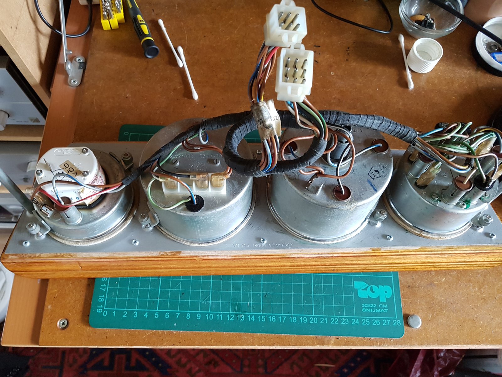

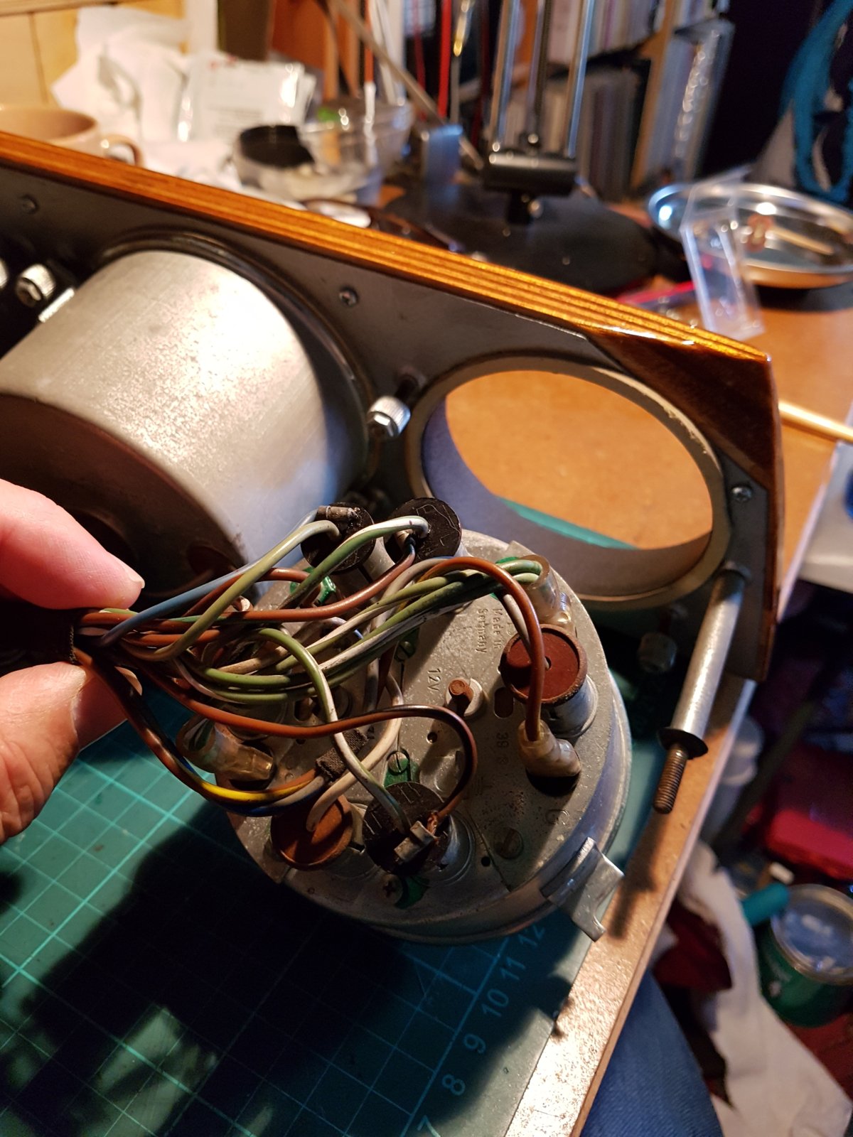

Thanks for that insight Thomas. Though there is a lot of discussion about removing the gauges one at a time, I couldn't find one article about removing the entire cluster at one go on the '74s. There also seems to be a paucity of photos of the actual locations of the connectors that must be removed in order to accomplish a clean removal.

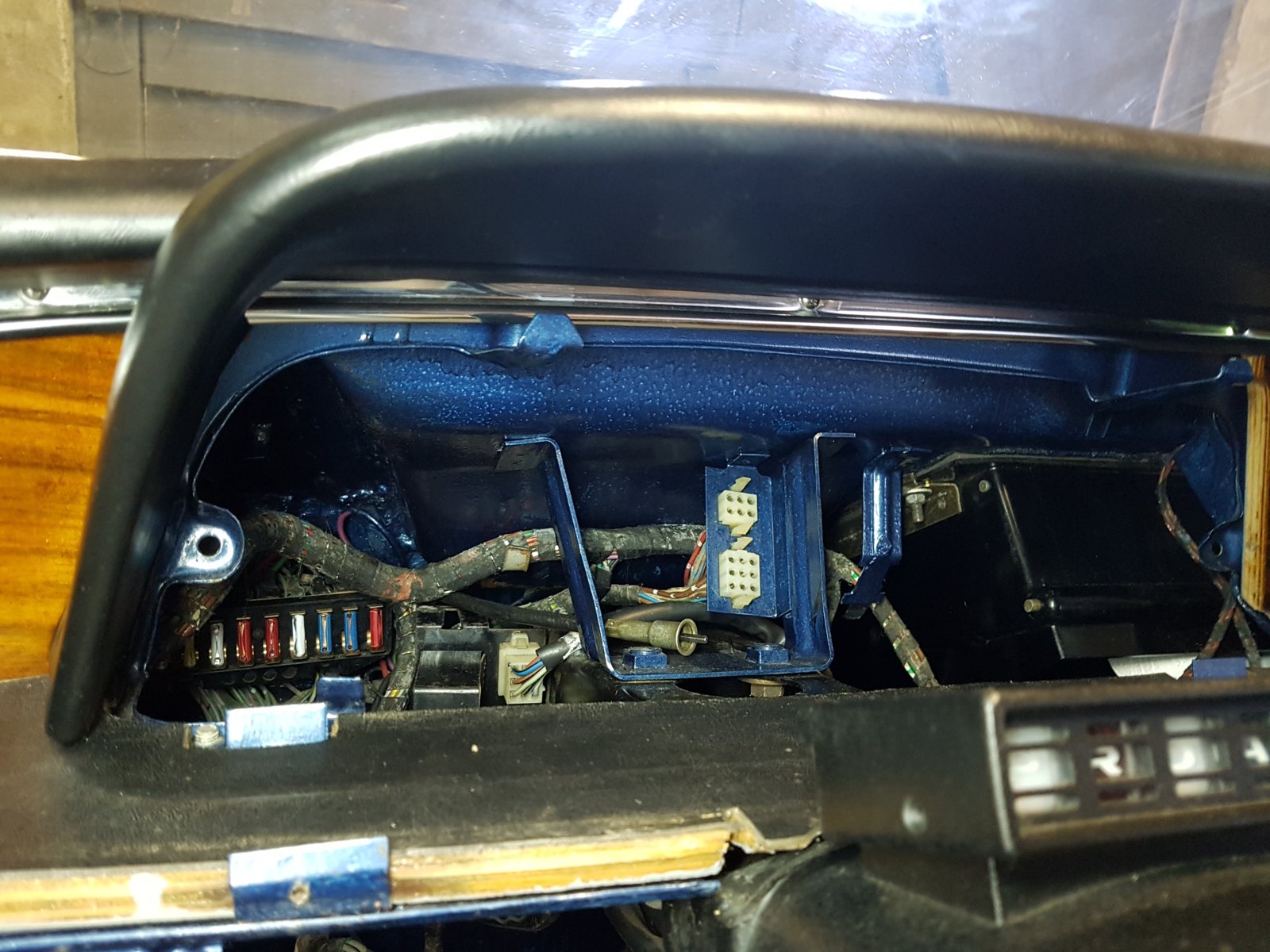

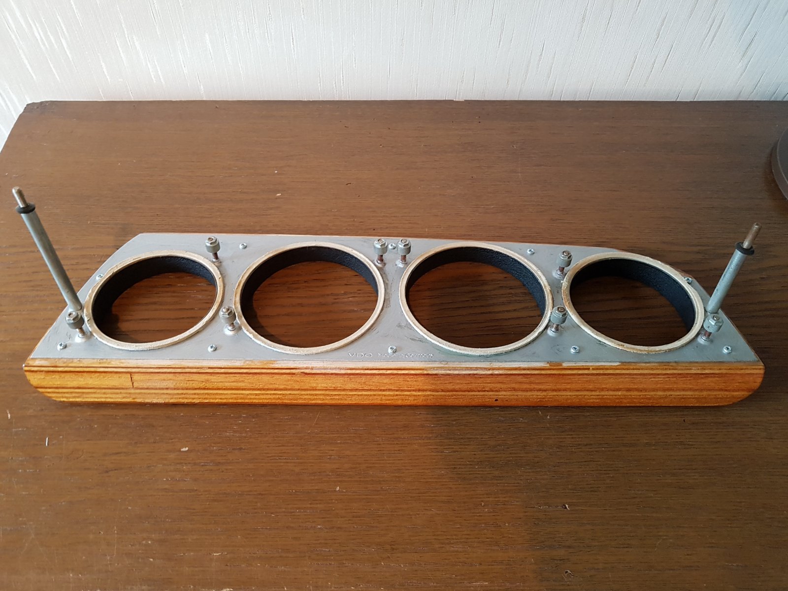

There are two studs with nuts at the instrument cluster you must remove. Also two vertical screws must be removed of the black dash cover to create some space to remove the cluster. And the steering colum with steering wheel has to be lowered to get the cluster out of the dash. A tough job

Besides the two vertical studs in the binnacle that point downwards, I think there is one or two screws at back of binnacle.
Thank you both. These are the most explicit answers to this question and I believe exactly what I was looking for. It seems to be slightly more arduous than removing the cluster from the 2002s. But that only requires the loss of a square inch or so of flesh so this shouldn't be more than a two square inch job.

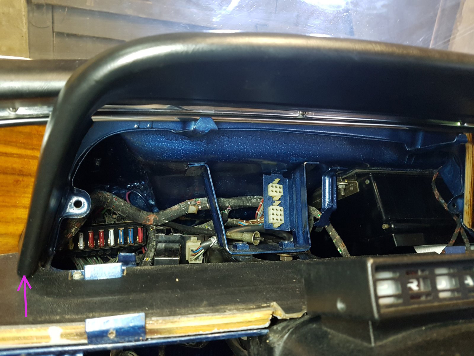

Not sure this was covered, to take the instruments out, you loosen the fasteners on the vinyl hood and the wood part and you sort of wiggle both of the out a bit at a time
As mentioned, the hood has a screw up from the bottom that is not real obvious, near the front of the hood, near where I drew the magenta arrow
I have a 72, but I think it is the same as a 74, Chris can tell you, I think that was your original question
