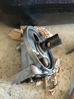

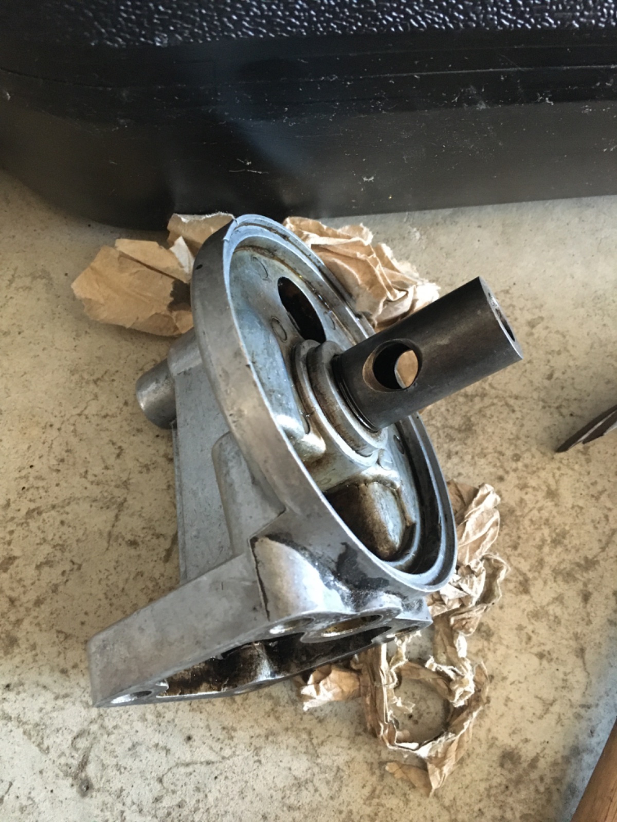

Has anyone had any difficulty trying to remove the steel insert in order to screw in a spin-on oil filter conversion kit? The steel insert is so tight it just won’t budge. Was considering if heating up the aluminum to expand it enough to unscrew the insert would help. Thoughts?

Hello from Sunny Florida, I put the housing upside down, With the insert up into a vice. Then a long punch into the hole and turned it anti- clockwise to remove. If you don't want to use a torch, Use your oven after washing real good. 350F for a hour. Put the new filter on before you bolt onto the block. I couldn't find a oil filter wrench to remove filter while mounted to block, Alternator gets in the way. Bought a dozen oil filter to block gaskets.

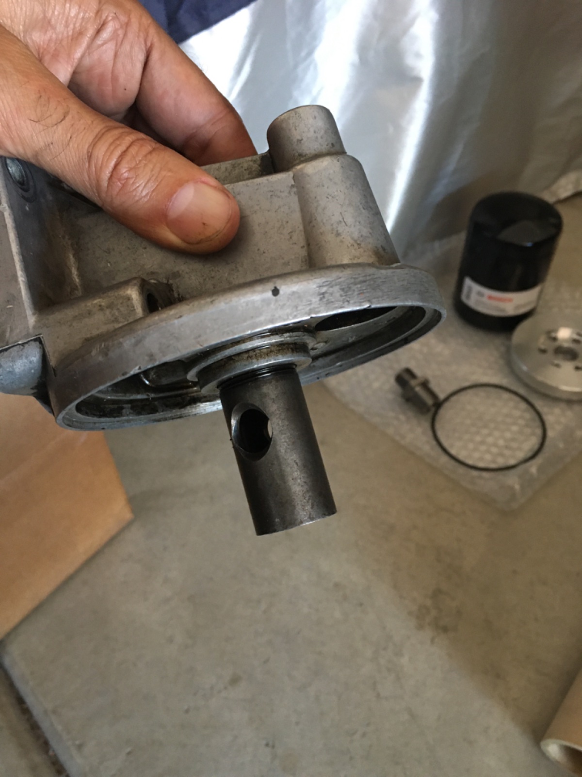

Got it off after putting it in a vice, wasn’t too bad.

Thanks again Larry. Was able to remove the post by clamping the housing in a vice. It was not that bad.
Putting the housing back in the fit seems to lend itself to remove/install new filters pretty easily so hopefully I don’t have to keep removing the housing. We’ll see how it goes for the next oil change!
