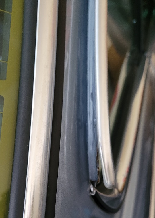

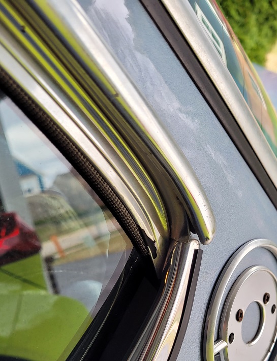

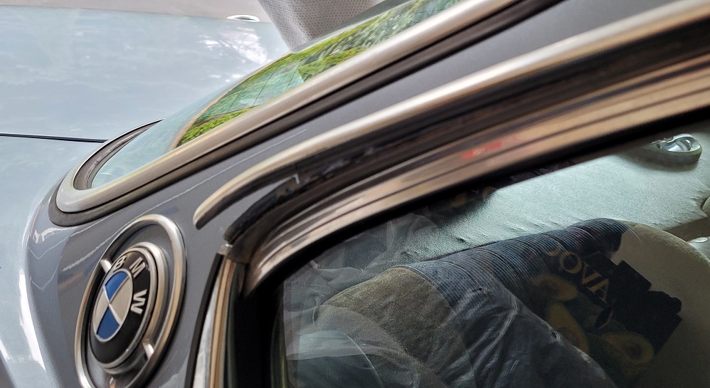

As requested, pictures. How does the vertical trim actually stay attached to the body? Rside2 shows how it is sticking out, like I said in the original post.

It may be that the flange which holds the trim has been compromised or the gutter trim has been compromised.
If the flange on the car is damaged, it may need to be glued & clamped. If going the glue route, Locktite makes a heat tolerant adhesive.
If the trim has been "stretched" or is too wide to stay on the flange, carefully 'pinch' the trim with protected pliers.
The flange on the car is like a "T" and the gutter trim fits on that flange by fitting the top edge firmly first, then snapping to the bottom with a firm smack with a length of wood & a rubber mallet in a downward motion rolling the trim onto the lower/inner side.
@x_atlas0, after visiting VSR today, & discussing this with one of the craftsmen, you will either need to find good used gutter trim & replace both sides or glue the failing pieces back in place. Where yours is failing is not meant to catastrophically fail like that.
I'm going with flange ok, trim was removed once which requires rotating the back or front end to start the removal process. I would ask if the flange on the troubled part is intact and just the entire back part of the trim has been rotated and that is why it is popping off. Regardless, entire piece has to be removed. I would love to see its shape once removed.
I too suspect that the Alu trim has deformed, and not the steel flange on the car. After all its thin alu vs steel in roughly the same thickness; I know who will win that arm wrestling contest.
And fully agree with @bavbob; what you see (in pic Rside2.jpg) is likely the place where the removal started, therefor the most deformation on the Alu trim occurs on that end. In my car it was also sticking out a bit, just like yours, as my trim was removed at least once for a repaint.
Now for the solution: luckily Alu is quite ductile, meaning it can be bend back into shape for it to just grip the roof edge again. Downside is that, for a nice presentable car, the deformation will ( perhaps already ) have caused cracks in the anodizing layer; the anodized layer is quite brittle. You will likely notice small hairline cracks. The only way around that is new part, or de-anodize (use the chem power of over cleaner), polish and re-anodize or Cerakote the part.
Best to pop the entire thing off and torque it straight. I have mentioned a bunch of times on here that Minwax or equivalent floor restorer which is nothing more than watered down polyurethane, can be used on these parts to markedly improve their look and all you have to do is wipe it on. It will last a few years as well. Fills the fine scratches. Also use on the black plastic hood and fender vent/trim parts.
Had the same problem upon trying to “re-snap” over the sheet metal edge, just kept popping off. I injected a small amount of epoxy in the female groove of the Al trim and used 3 small rubber cushioned wood clamps, presto, problem fixed. Don’t inject too much epoxy as it will be very difficult to remove. Success for over a year now and looks perfect.
One more thought on this problem, it is very likely by taking the entire trim piece off again you will likely distort other aspects of the long linear pre fabricated line of the piece. Sometimes less is more!!
