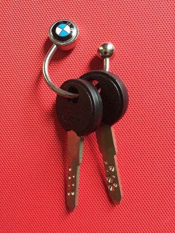

I just sent Stuart at keys4classics a pic of the code from rear of my glove box lock (iPhone wedged up there with a flashlight). I'll report back once I have the keys. He's been v helpful
keys4classics did a set for me and they work perfectly.
