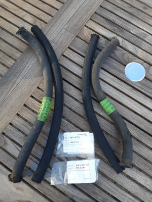

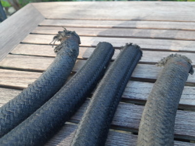

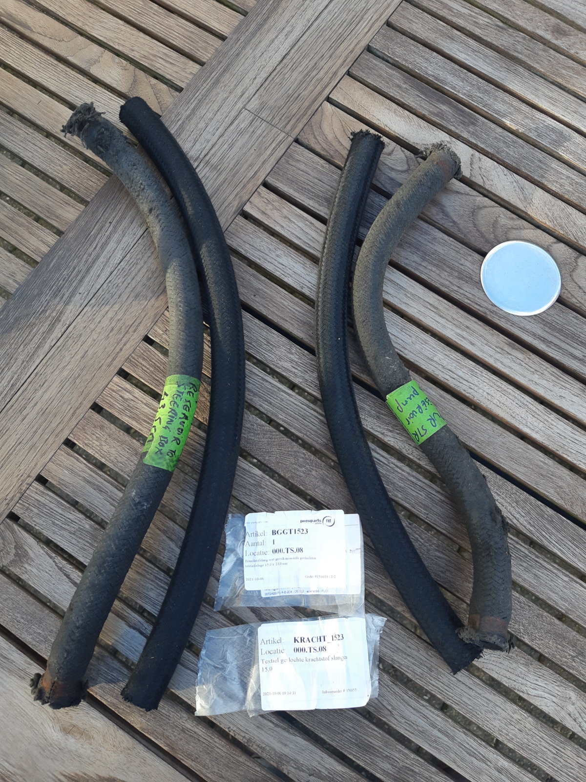

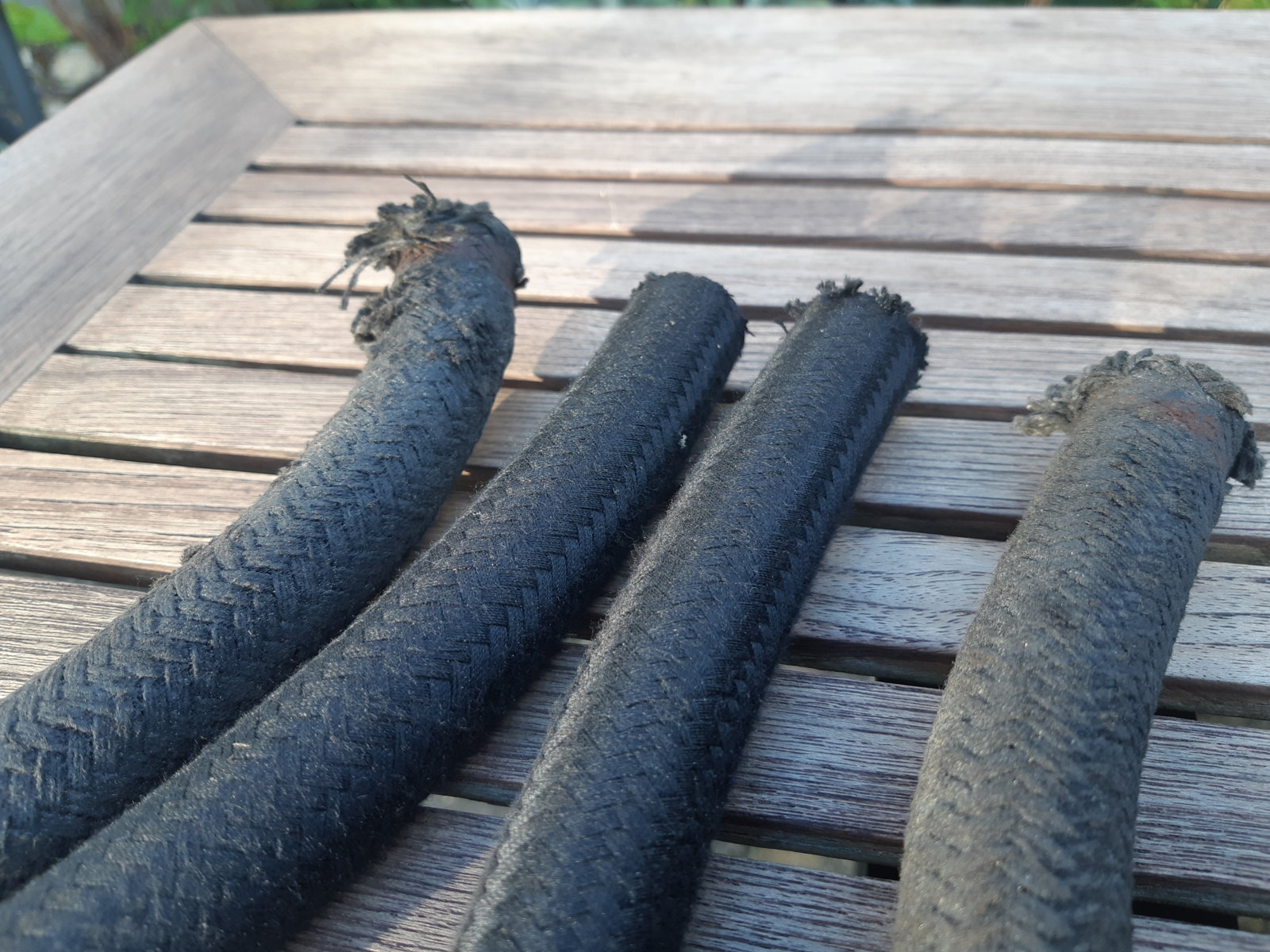

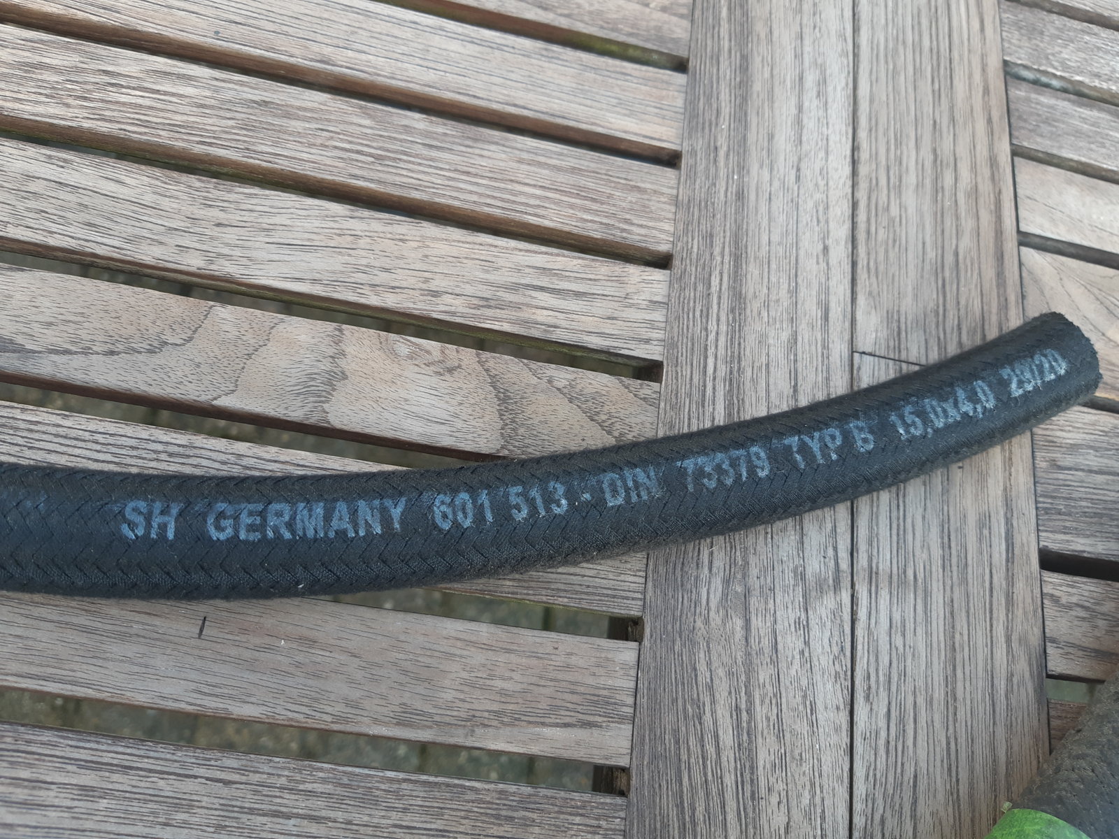

Not seem them before on this site so I thought I'd post it here.
I've found a matching replacement for the textile covered rubber hoses that are installed in the low pressure side of the power steering system, the 2 hoses from the reservoir down.
The material is oil and fuel resistant, so they should hold up well.
The diameter is I think 1 mm too small, 15 mm instead of the 16 mm ID that I measure on the old hoses.
Pressed on to the reservoir / canister however they fit nicely.
I also purchased a smaller diameter that can replace the vaccum line to the front carburetor.
I paid 45 euro for the 3 small pieces, not cheap...
