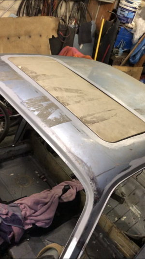

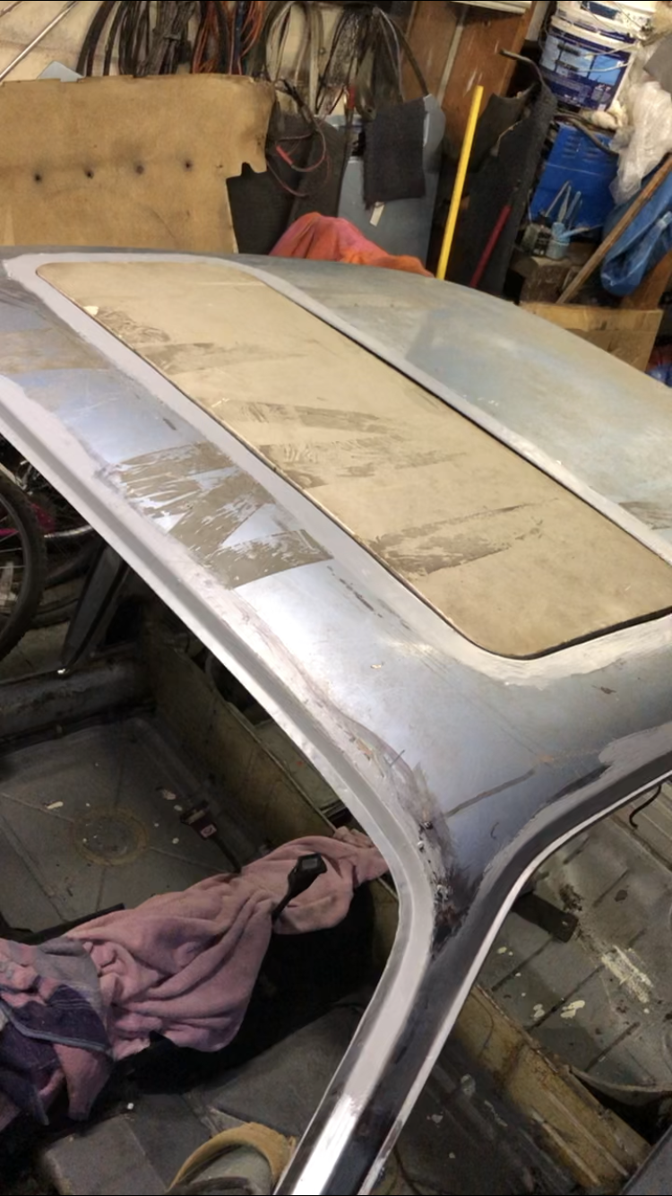

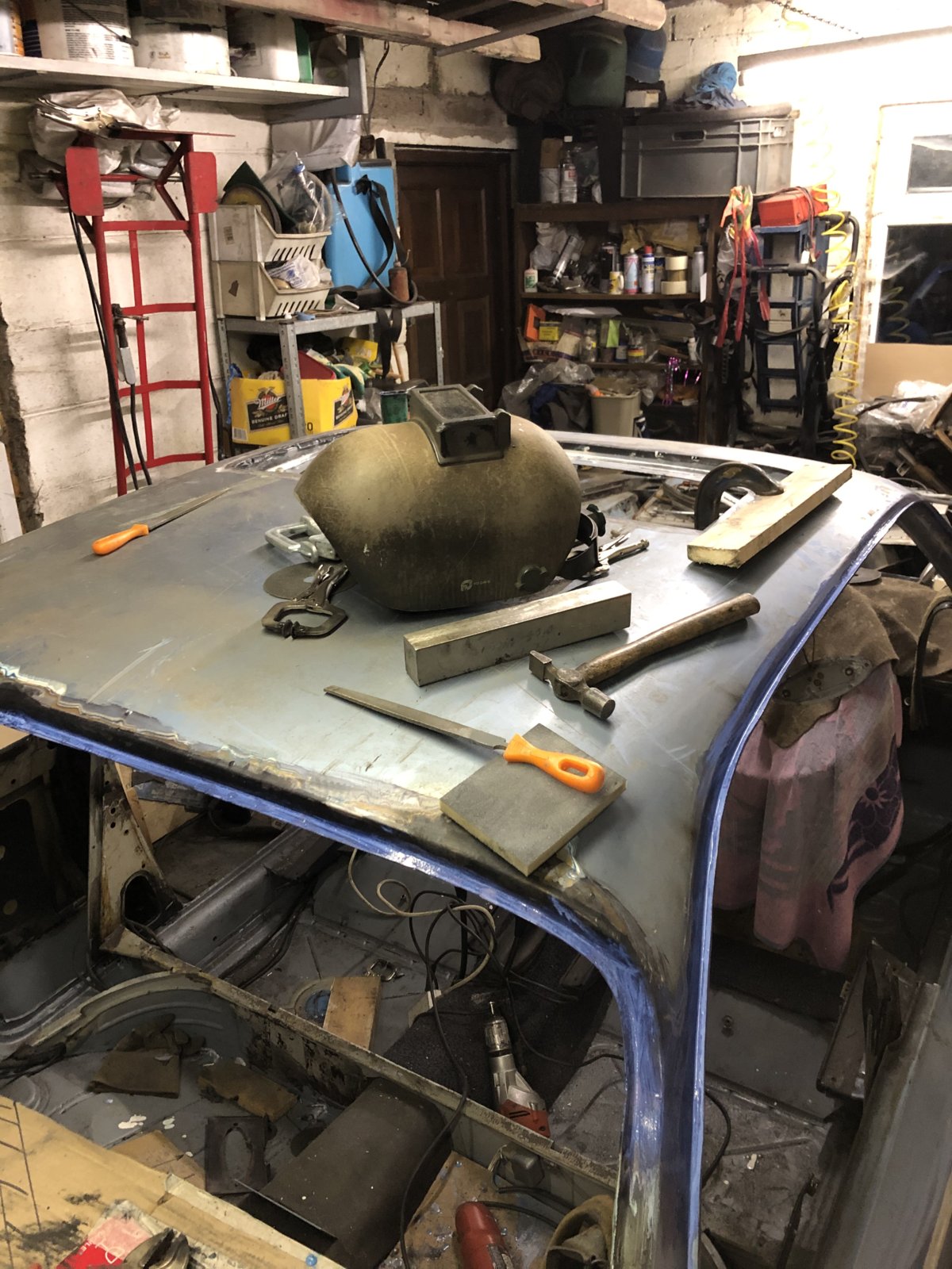

Hi there
I just replaced the roof on my car .
It was covered in a thread called : windscreen removal.
I put a lot of photos and some advice in there to maybe help others out a bit.
If your car has an aftermarket sunroof, I would think it would be easier to go back to not having a sunroof , as you will not have the golde frame in your car either to take the sunroof . It is a lot of work swapping over , but worth it , to save the car obviously !!!
I don’t know how to attach a link here to what I posted previously, but if you search windscreen removal, you should find my posts
I personally would not like a webasto sunroof on my car so I would not recommend one of those and I would imagine in Australia that you would simply cook yourself in a car that is covered by a bit of cloth draped over it .
Anyway if you want have a search for my stuff.
Ps if anyone knows how to link a previous post feel free to let me know! Thanks
