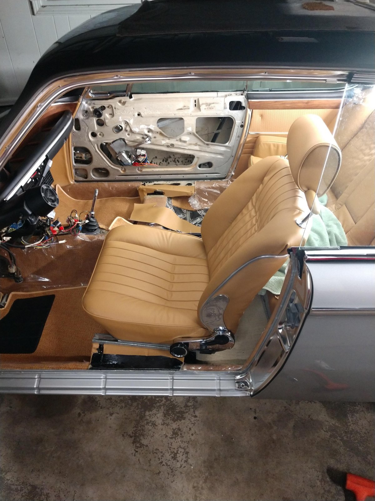

I just installed the world upholstery kit with no experience whatsoever. I would recommend going for it if you're patient and like to learn. No special tools really. Quality of world uph is not as nice as nice as gahh. Price reflects that but I'd be tempted to spend more if doing another one

I did replace most of the foam using medium or high density foam, was able to source high quality foam through local uphulstery shop and some on Amazon.
Hiring someone to do this would be much faster, pros already know the tricks but learned as I went. It's not like wrapping a Christmas present where if you get it wrong the first time you reach for new paper, it's tough leather so ya kinda try it and keep filling and refitting to your liking.
