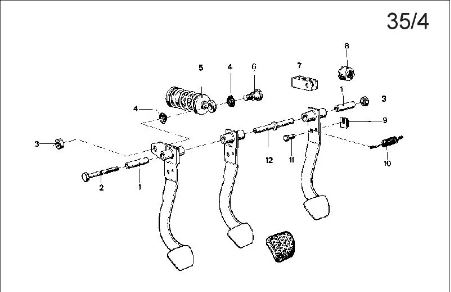

Hi everyone,
Would anyone please have a photo of this clutch spring (item 5), possibly a return spring? And how it is attached? I am reassembling a car and appear to be missing this item, and am not actually sure what accompanying parts it may require. 1972 RHD. Thank you.

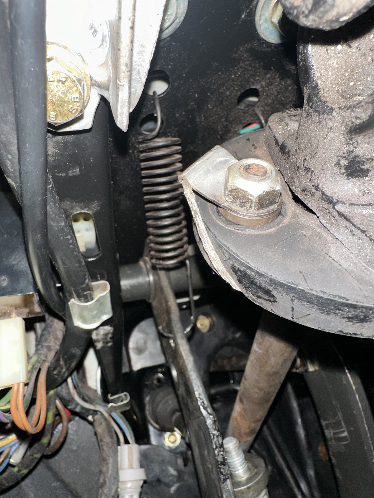

Interesting, I had not looked at this diagram for a while...
I have a 1972 LHD, the parts diagram on Real OEM is the same as you show above. I do not have a spring integrated with the clutch master cylinder, rather it is attached between the pedal assembly and pedal box as shown in the picture below.

You are looking for an over-under spring?
There are creases in the later pedal box wall that hold the spring in place
