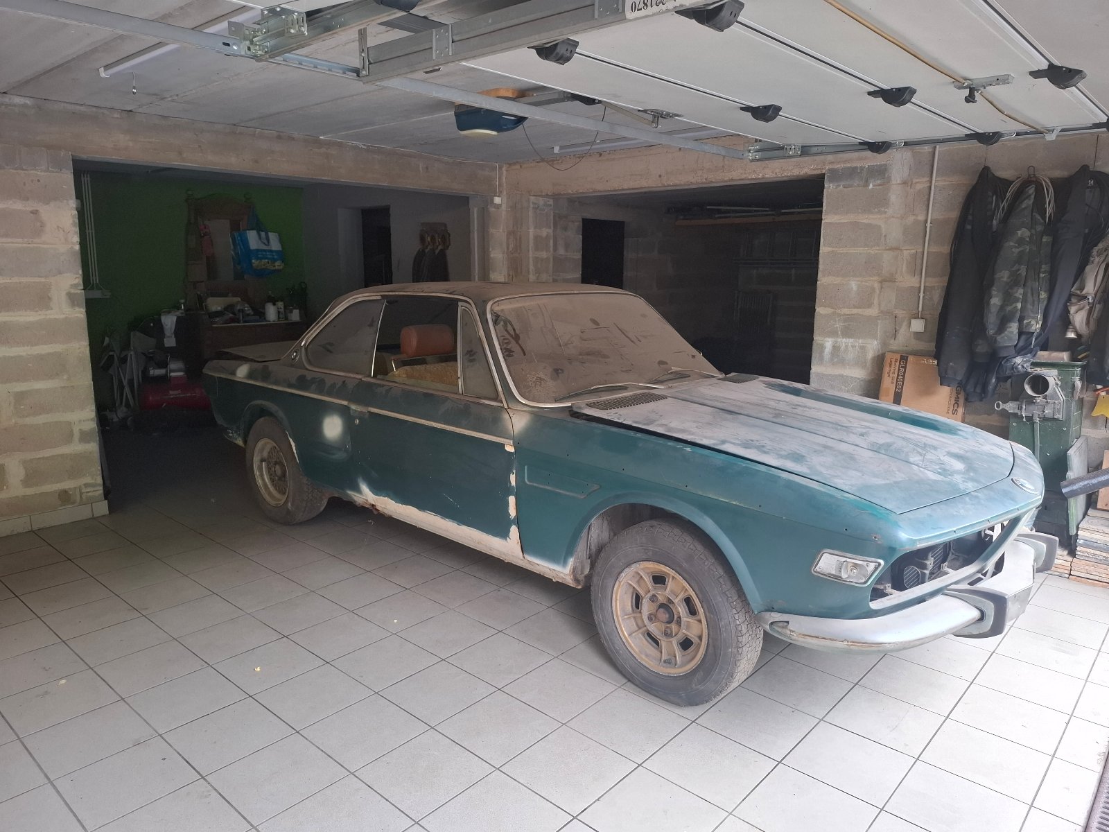

Hello and welcome to the restoration thread for my father’s and my restoration project: a beautiful BMW E9 2800CS, which, if I recall correctly, is a 1970 model in Agave Green. The car was a one-owner vehicle all its life until the passing of the previous owner (may he rest in peace). Now it’s our turn to bring the car back to its former glory. I bought it in August 2024, but my other projects took up too much time and space, so I had to finish those first.

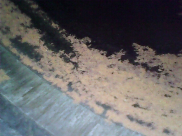

Before starting the full restoration of every component, I wanted to hear the engine come back to life after 41 years (the car hasn’t been registered since 1984, if I remember correctly). I removed the spark plugs and used engine oil and spray oil to rewet the cylinder walls, prior to which I inspected the cylinders with an endoscope. Unfortunately, I discovered flash rust in almost all of them. There also appeared to be slight scoring on some cylinders, but I’m not completely sure since the camera quality was quite poor
