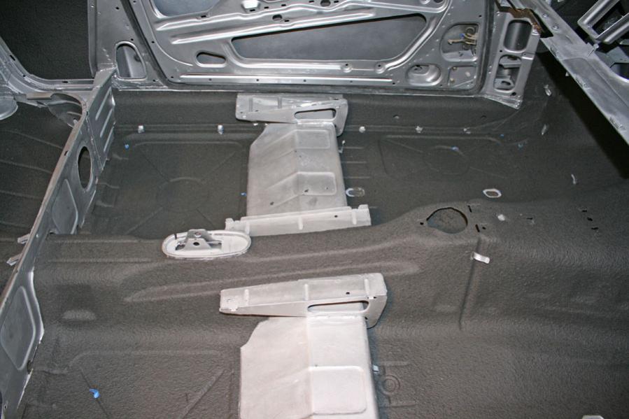

Here are some interior shots showing the sprayed on acoustic sound dampening (Lizard Skin), the wood dash/wiring, the firewall heat insulation and the rear seat battery setup.

Very nice. I'm maybe a few weeks ahead of you, and we went a slightly different way on sound deadening, but your setup looks very clean.

I used a similar product to Lizard Skin on the roof and the back half of the cabin as the renovations allowed. I'll be interested in hearing you impressions on performance having sprayed the whole thing all at once. Looks much neater than me brush job.

I did not spray the roof. I have a sunroof which already has a formed board and insulation on that - plus there are quite a lot of parts up there. I used the ceramic insulation over the tunnel area inside and underneath, and on the front lower section of the firewall (the area behind the reflective insulation). The floor will also have a 1/2" layer of the Dynaliner. I sprayed the inside of the doors area as well and may add a layer of the Dynamat extreme stuff.

My 2 gal of sound control and the spray kit have arrived and I'm almost ready to do the interior. Any advice beyond the instructions on the label on mixing or spraying? I have a ton of masking to do as the dash is still in as is the fuse block and main wiring loom. Pedals, steering console, heater/console and glove box are out.

It goes on fairly easy. Mask everything well. I would avoid spraying any tabs, mounting brackets etc. This stuff goes on thick and could affect tolerances for clips and other items mounted to the car (eg, where the glove box hinge mounts to the footwell or where the seat brackets attach, etc). It will cover any screw holes - so if you want to be able to find them, then tape those off as well. Plug the seat belt harness bolt holes in the floor and the holes for the plastic plugs in the side of the inner rocker. The high bosses on the parcel shelf should not be sprayed as the plastic clips will not work through the extra thickness.
