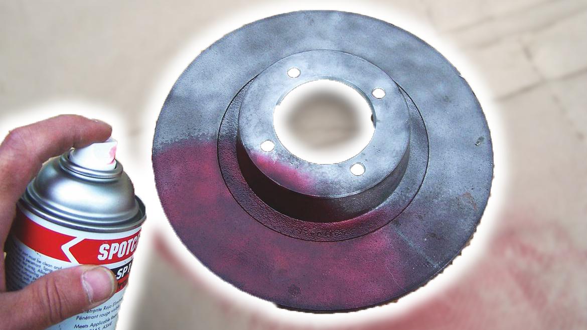

It also impossible to spot the pit corrosion by eye while polishing. The osolution is to check with these 2 stage Crack detection dye's; after you sand and polish, you spray it with a red penetrating die. If there are any pits/cracks, it'll pull in. Then you wipe clean, and spray with a white chalk that pulls the red ink out. If you have no red ink showing, then re-anodising should give you beautiful results.

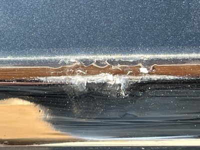

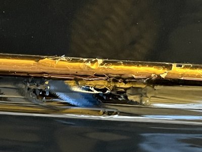

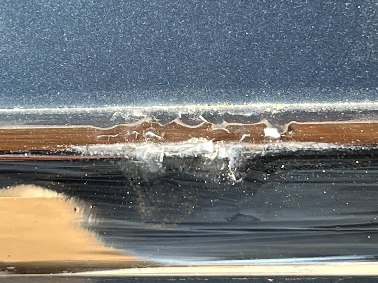

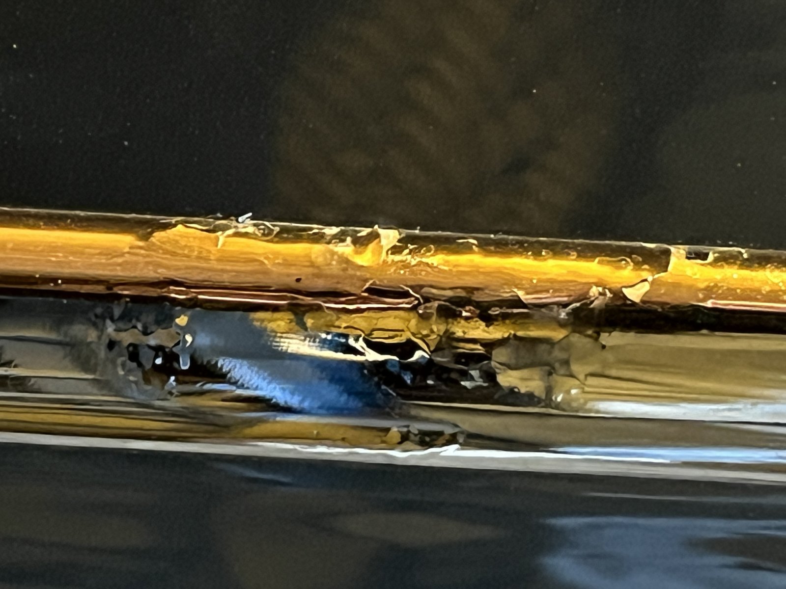

I chrome plated my old belt line professionally ten years ago. After about 5 years the chrome started to peel off. This is the result on all the different pieces.
True chrome plating, which is a three stage process (copper plating, then nickel plating and finally chrome plating) would never give you results like that. We have items chromed by the same company using the correct process from twenty years ago that still looks brand new.

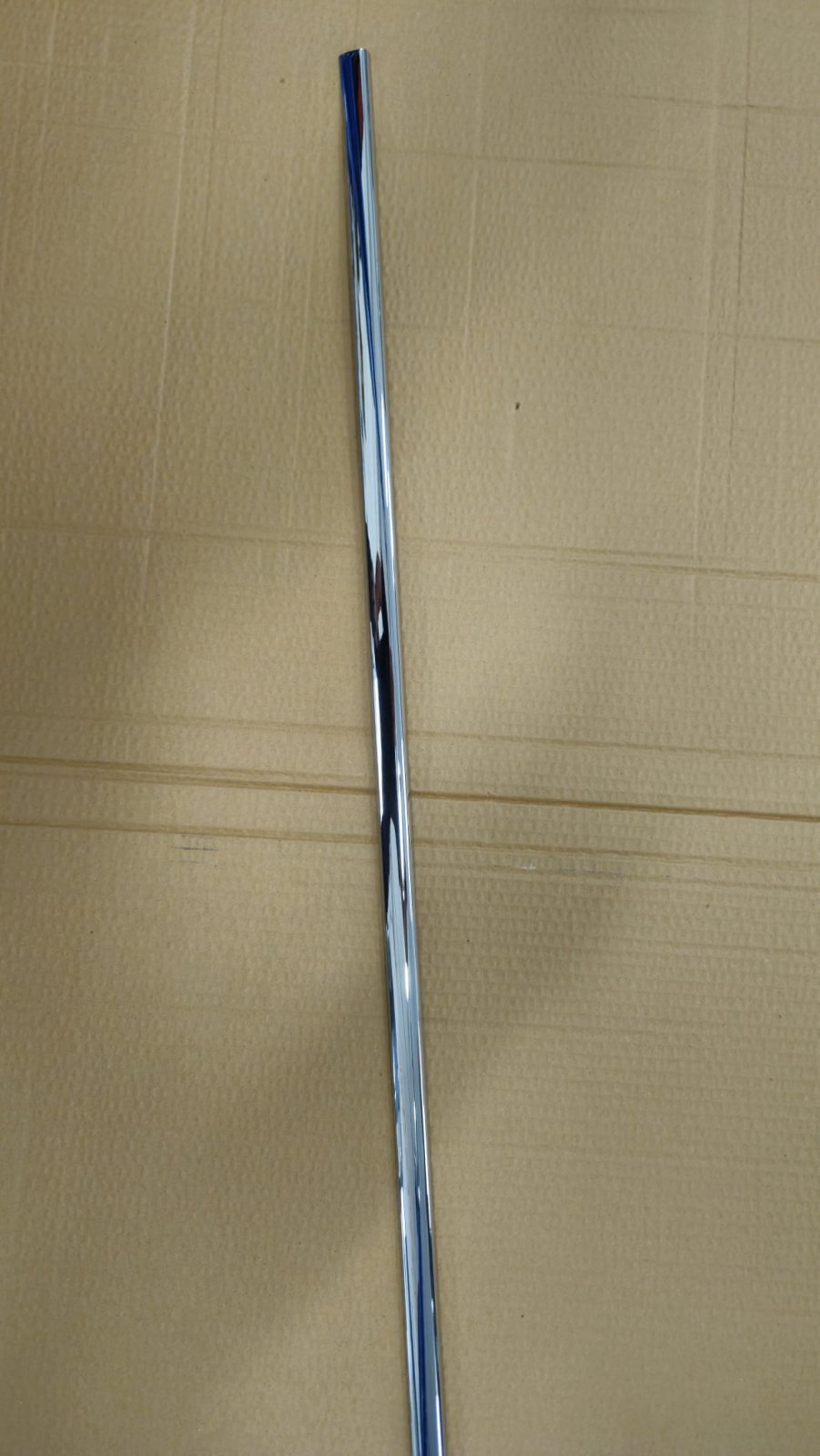

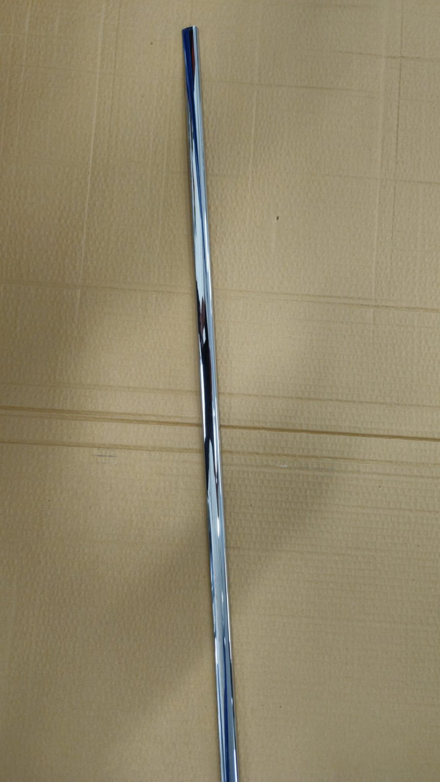

We had all of our new BMW supplied beltline trim chrome plated to match the rest of the plating on our car with great resultsView attachment 183857
Part looks mighty nice.
Curious; BMW sold trim parts that were I'll fitting, especially the rear L and R, in the corner where the wrap around the trunk.
When did you buy your parts? Did you test fit yours? How did they line up?
