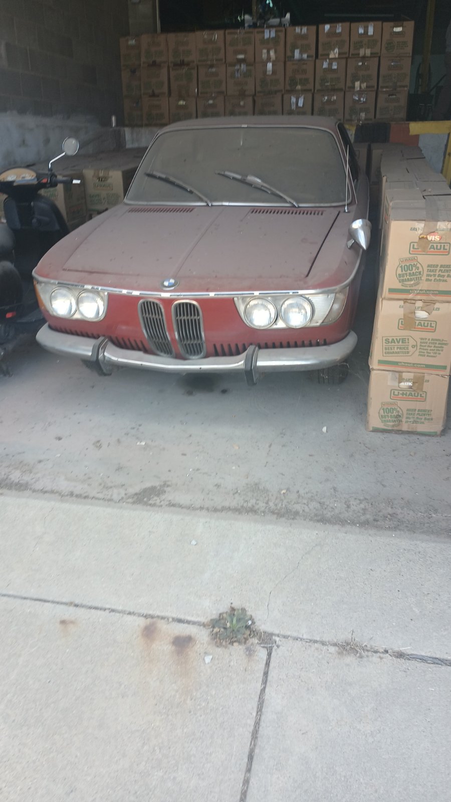

Three months and lots of money later... The body turned out to have NO SIGNIFICANT RUST, just some very minor collision damage, hooray! Anyway, I need to get to work on the interior. I guess the seat kits from World are a good way to go. I'm having a guy that builds custom pilot and co-pilot seats for West Star Aviation rebuild and recover the seats. I also need the original horn ring, a part I've been looking for for many many years, and the black cowling ring for the speedo, which I have misplaced. I pretty much have all the bits, but I need a new headliner, or my guy can make one if could find the right material. I also have no idea what the original rear deck looked like. I have the original speaker hole ravaged masonite, but I need to replace the the fabric with something as close to the original as possible. My rear power windows need work, as do my front crankers. I could go on and on. Does anyone know what the OEM radio was? I'm guessing Blaupunct but I need the model number so I can start my search. I want this thing to look completely stock. Also, were the the indents in the front trim piece above the grilles painted black, or did they use tape-like vinyl inserts? There seems to be black paint residue in the indents. My body guy wants to paint them with black enamel.
