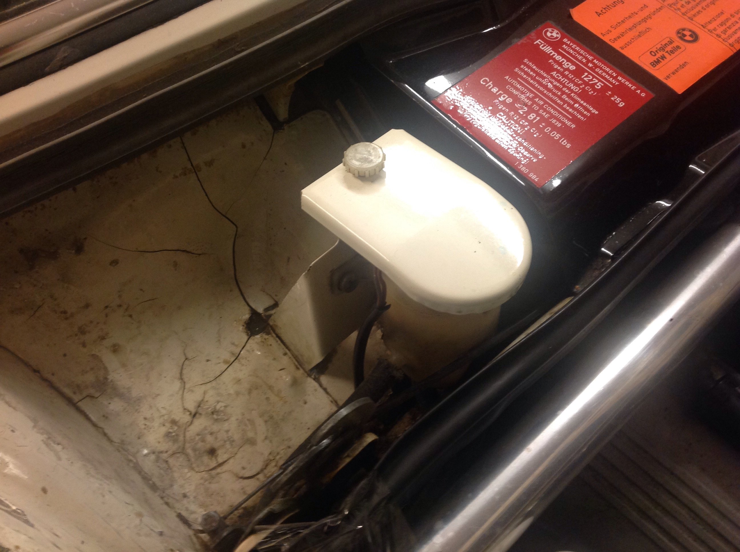

As the title says I need some pics from any RHD people as to the correct location for the brake / clutch fluid reservoir for a manual, including bracketry and pipe routing.
I have thought of locating it on the washer bottle bracket and re-positioning the washer bottle elsewhere. Maybe the battery site as my battery is trunk mounted.
Thanks in advance.

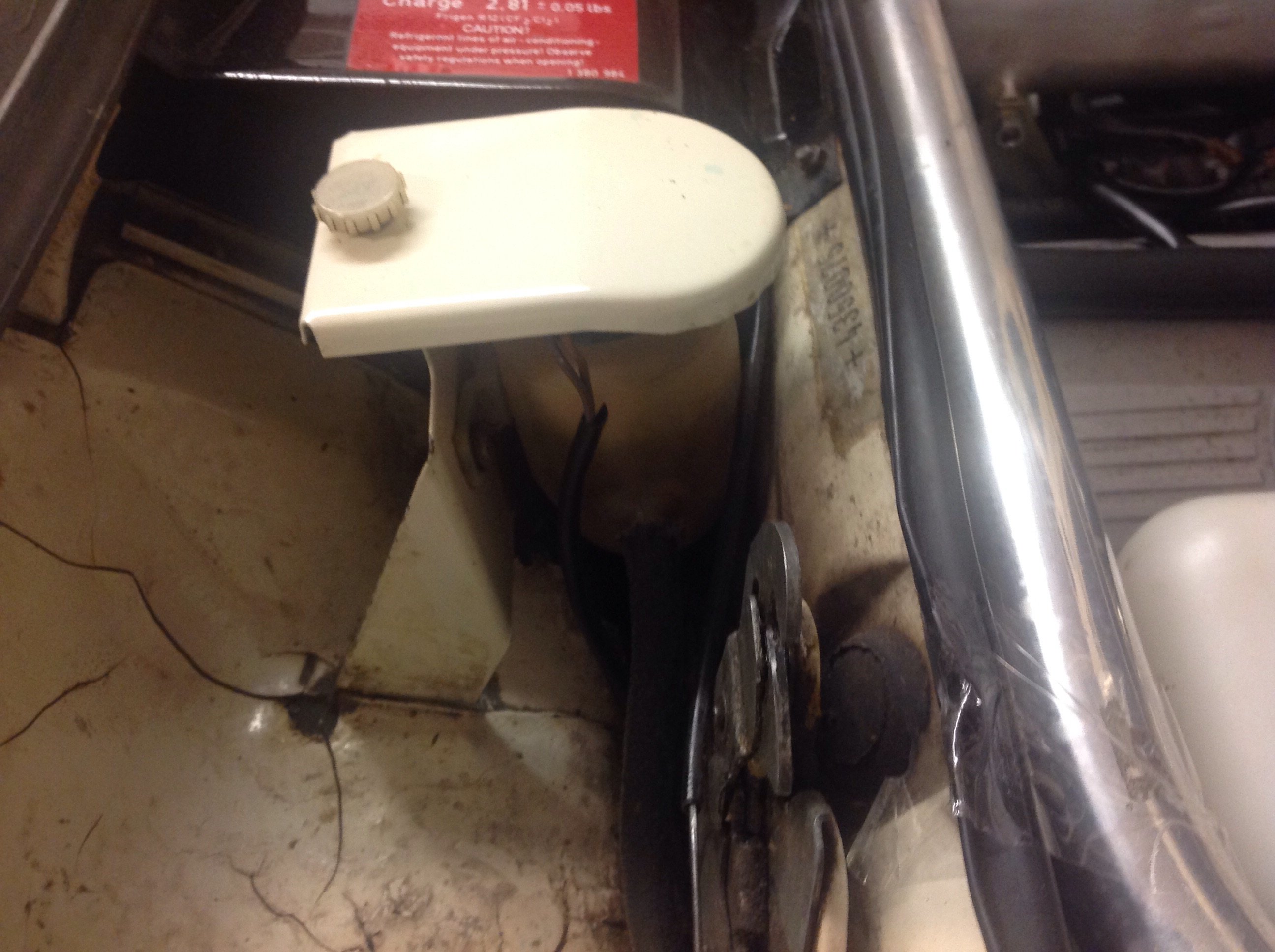

image.jpg image.jpg Here you go

That's a tight fit.
I will guess that the bracket is flanged and welded to the bulkhead underneath the sound deadening matting?
Not wanting to weld I will rivet mine in and waterproof the holes with bitumastic.
Are those radiused covers available anywhere?
