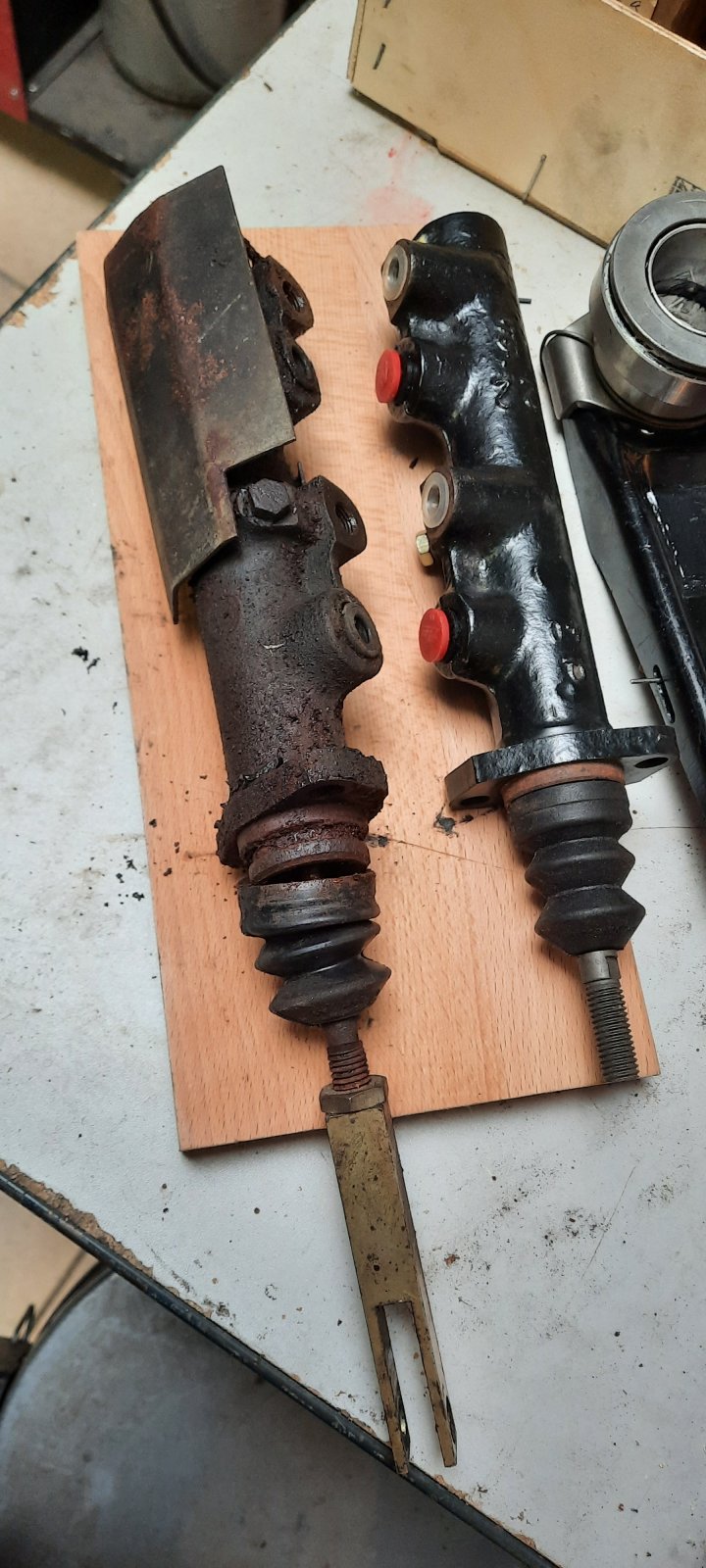

Hi guys, i need to refurb my RHD brake system completely as the car has been sat and theres no fluid in the system. Theres plenty of info on here so i have a good idea on the system and all the parts and lines. First step is to remove the brake master cylinder. Is that held in place by two bolts in the engine bay, and connects to the pedal? Kinda hard to see as it goes through the firewall.
Hi Scott,
I just removed mine last week and took that photo: 20230923_173756.jpg
First remove the bolt at the brake pedal, then the two other bolts. That's all!

Thanks Thomas, thats really helpful.
Im now intrigued where you sourced the new master cylinder from? Mine is completely seized.
To be honest, I bought it by mistake some time ago not knowing that I would need it some day! I even tried to sell it.
I will try now to find a new one for you!
Thomas
