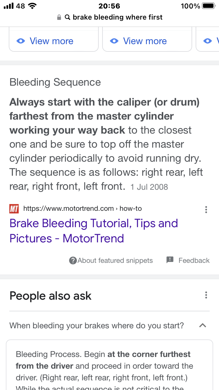

Hi there , I have not bled my RHD brakes yet as my car is still under restoration, but I always bleed cars by starting the furthest away from the brake pedal, so by that thought , I think you should not bleed your boosters first.
I think you should definitely start at the rear and work towards the front of the car.
But again I am just going by what I have done on other cars not my csi.
Also , the furthest from the brake pedal by pipe line distance is the rear drivers side as the pipes goes across the bulkhead to the boosters on the passenger side and then back to the brake pressure reducing valve also on the passenger side of the car and then on to each wheel. ( the drivers one is furthest along the pipeline).
