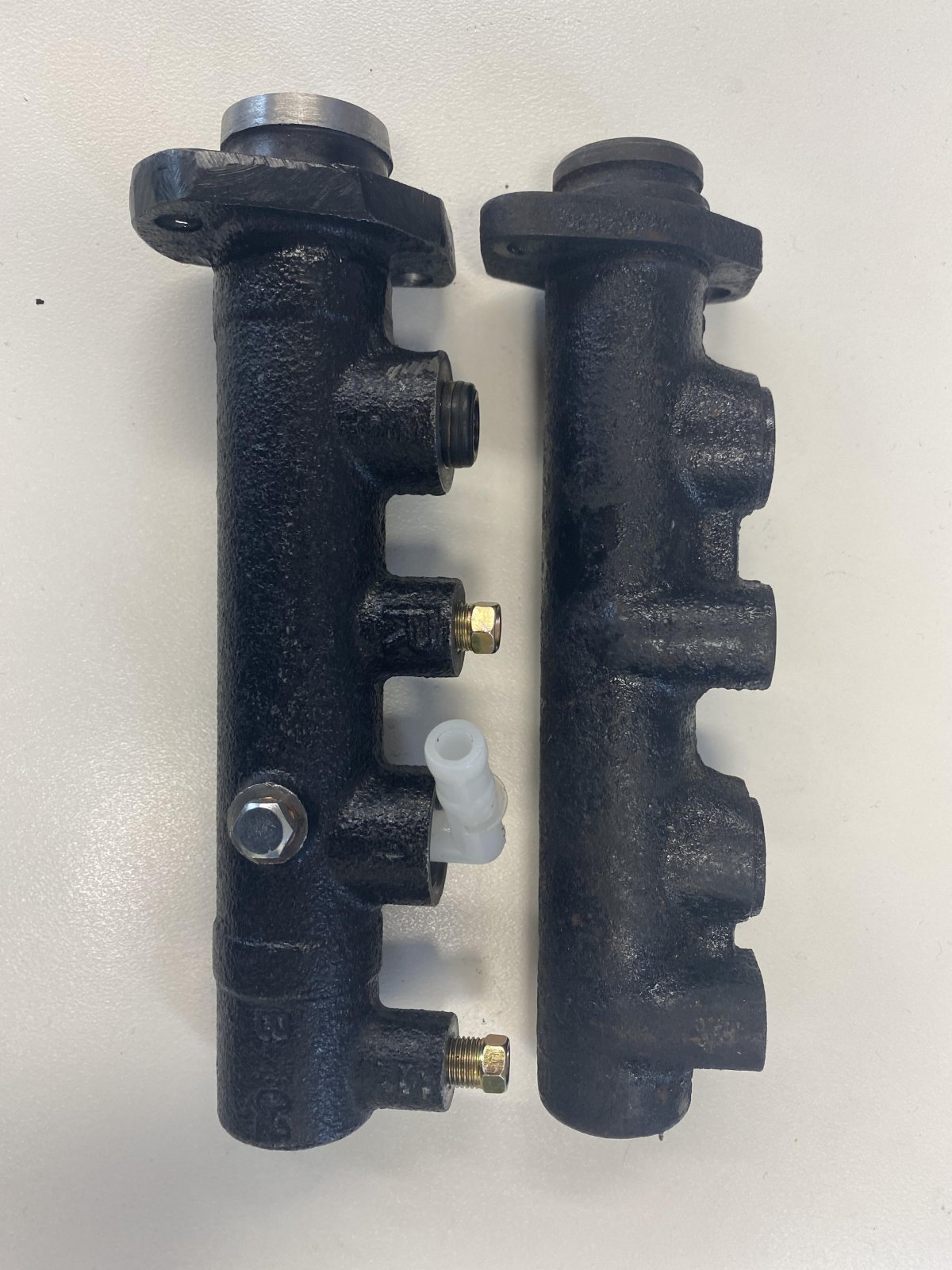

I needed a MC that looked original, used original mounting and had the same specs internally

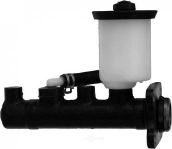

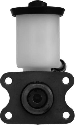

After much searching I found a Toyota Cressida MX73 MC is almost identical except for the mount, but the Toyota MC comes with a large square mounting plate that can easily be cut down and drilled to match the BMW. You can also use the original BMW fluid reservoir.
There are 3 mods you need to do

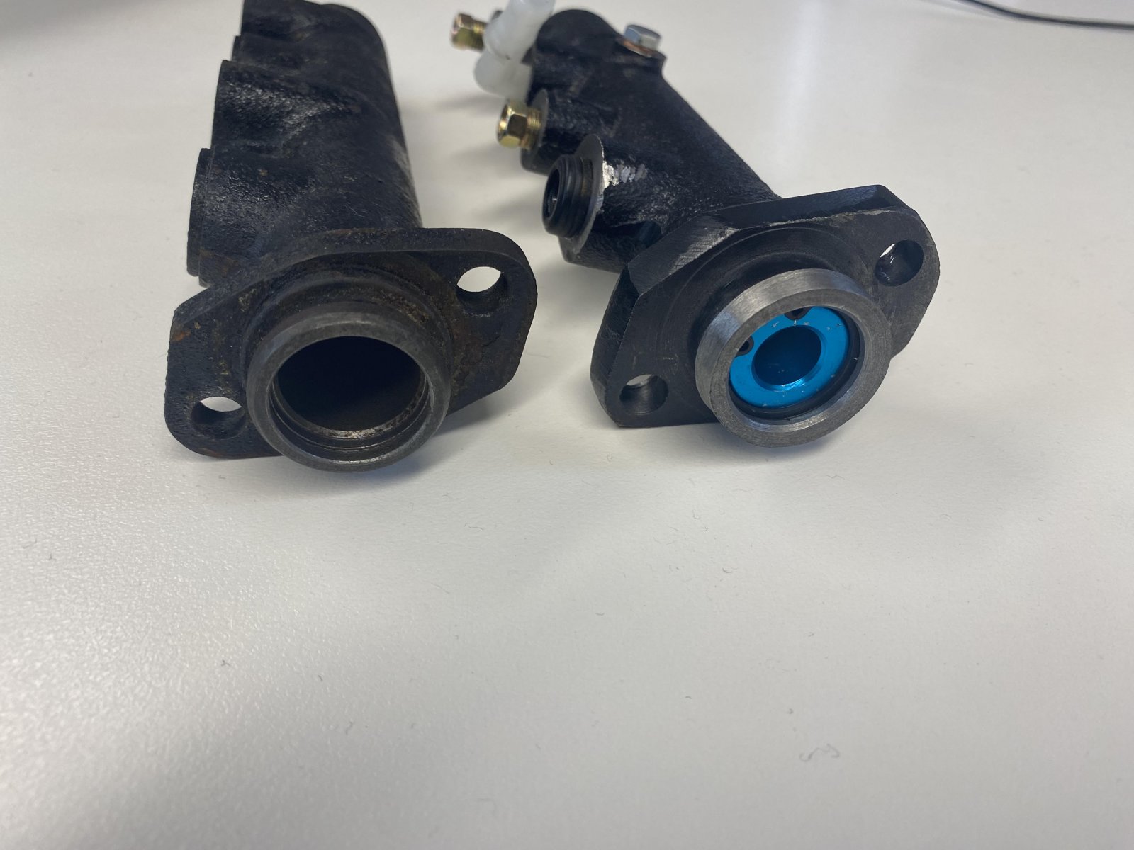

1) The end that goes through the firewall is a little large due to the casting having a lip, so I just ground that down on the old bench grinder
2) The mounting plate needs to be cut down and re-drilled- I just used a small cardboard template from the BMW and this was a simple modification- Plenty of material to work with
3) The Toyota uses double flare lines rather than BMW bubble flare- this was not an issue for me as I am making new lines anyway- but you can re-flare the ends quite easily or use adapters.
The other mod I did that may not be needed for everyone- The piston end on the Toyota MC is machined a little deeper than the BMW so when I mounted up the brake pin and forkhead from the pedal it was only catching by a few threads - I was not happy with that so I got a long 100mm high tensile m10 bolt and ground down the hex head into a small mushroom shape to replace the factory pin and used the original forkhead. The whole thing mounted up perfectly and to the untrained eye looks 100% factory.

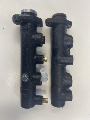

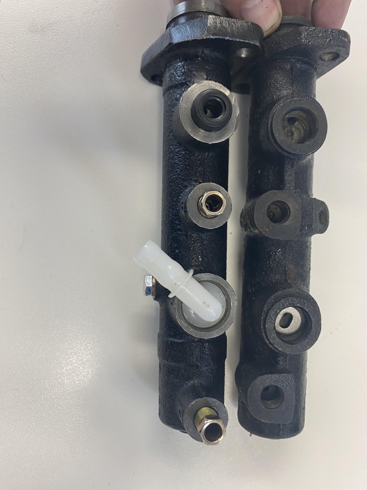

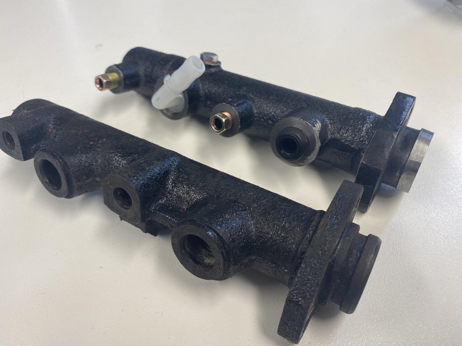

Anyway this is what it looks like with the mods, the last pictures are the master you need to buy- discard the reservoir that comes with it you wont need that. I paid about $120 AUD so I expect in the UK about 50-60 pounds
Hope this helps some of you- I have not road tested yet as I am working on an alternative to the twin boosters so stay tuned
