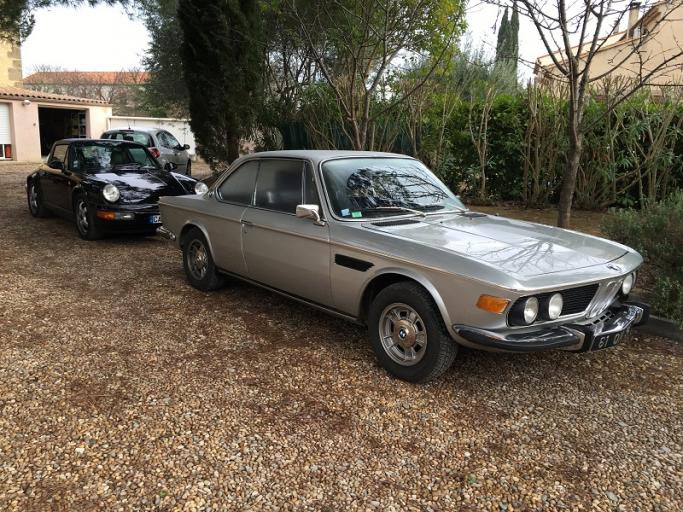

Below is a picture of how the car sits today.
I don't think any part was replaced when the car was taken apart at the body shop as it had been sorted out mechanically before that. I think I remember seeing the whole front assembly lying on its own, I don't think the struts were disassembled. The car came out of the shop sitting higher in the front, I don't know the reason.

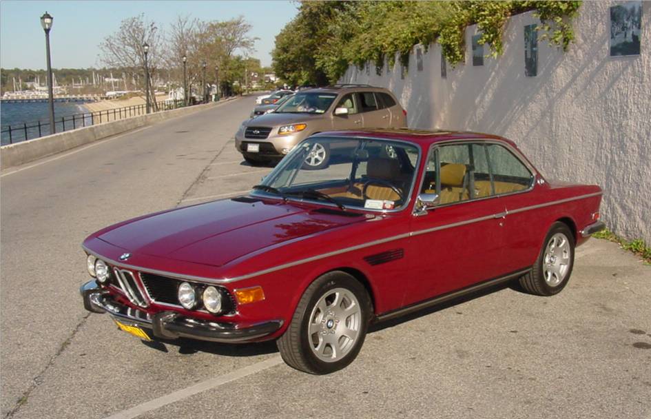

Unless you have lowering springs like the ones Carl Nelson sells, yes these cars look high in the front with stock suspensions which it looks like you have.

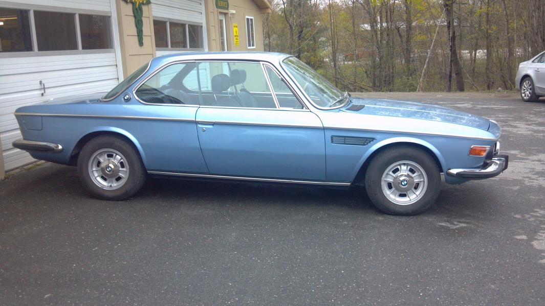

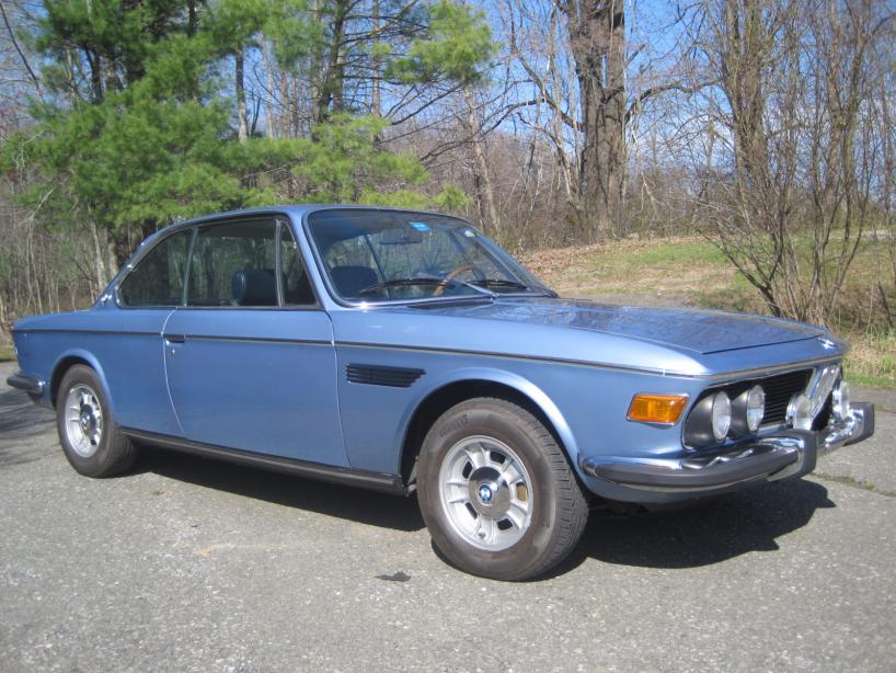

Here are pictures of my CSi, Athena, before and after adding front lowering springs, which lower the front 9/16ths of an inch.

Indeed, my front looks like yours before you lowered it. I'm now wondering if in fact the car came out of the workshop with a lower rear. But for sure, the stance is not the same as before it went in.
