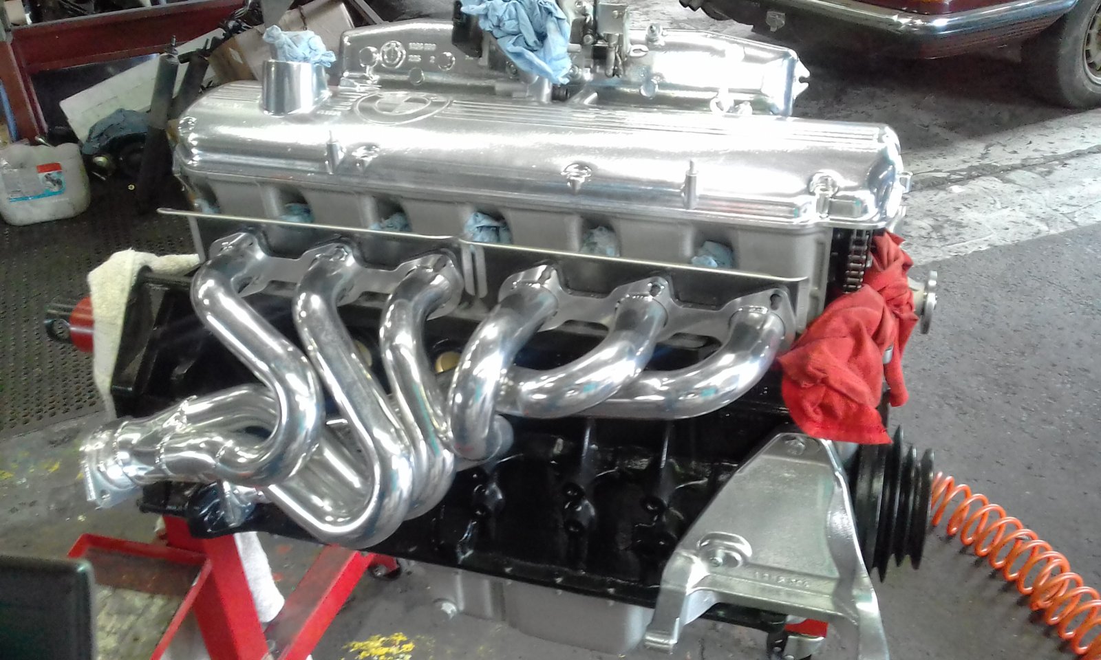

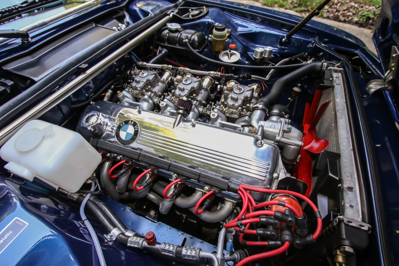

You could make a tray with 1x2's, line it with plastic and them get mineral sprits and clean with brushes. If you want to clean the aluminum surface you can use Insta Glo drain cleaner to remover the dirt and light oxidize the aluminum surface. Be careful stuff is hard on skin. Won't hurt inside either. It could be polished, vapor honed or powder coated.
If your good with a buffer it can be shiny aluminum.

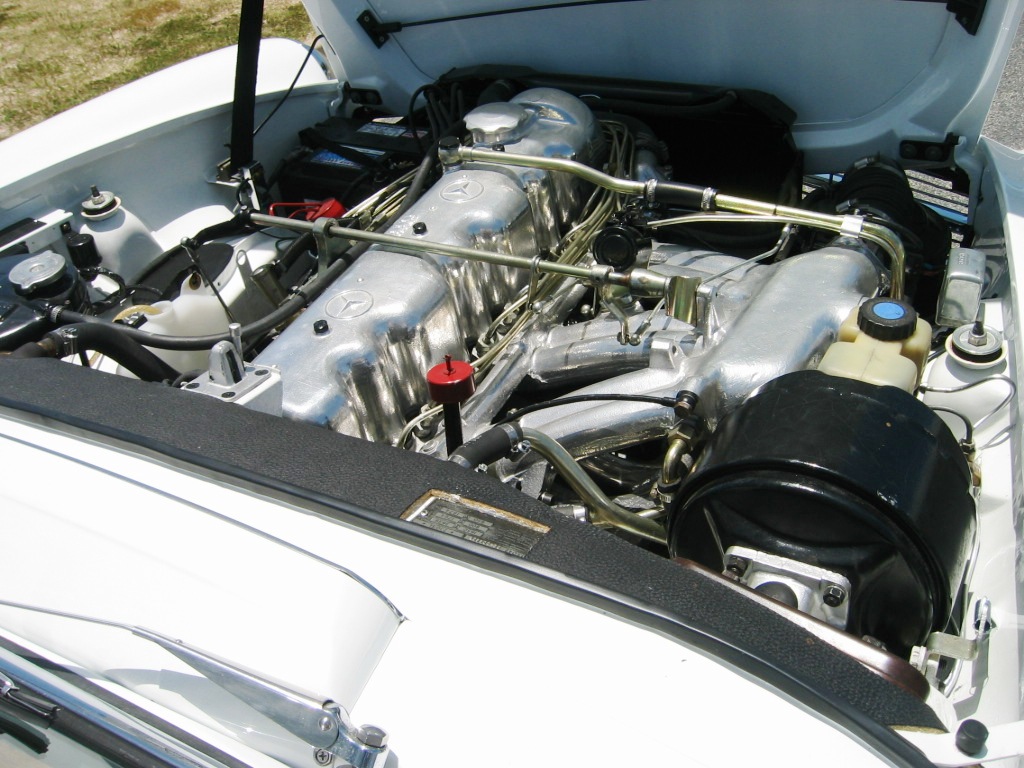

Take the parts to a Coating specialist........I had mine cleaned/prepped and ceramic coated in both the the E9 and the Pagoda Benz. E9 done 1 1/2 yrs ago.....Benz done 6 years ago and look like new today. $380 Aus each car. Headers on E9 dulled a little after getting a bit warm on the dyno
Never use steel wool to clean up as the tiny fibres that break off will stick in the porous casting and rust.
