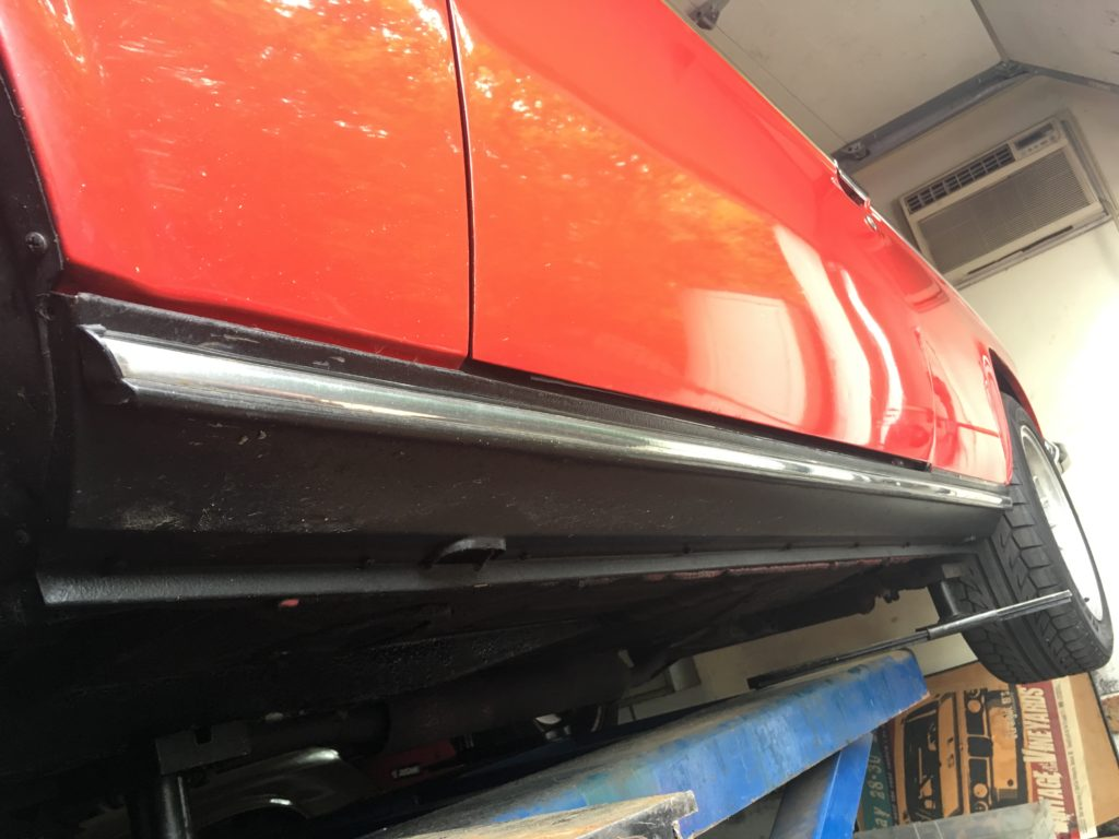

Rocker panel moulding, where to source?
These are ALMOST identical to the ones used on the e3 models. You can take the e3’s, flip upside down, remove the end cap, cut the piece to length, reattach the end piece, and install. Only a VERY discerning eye would be able to tell the difference. I’d give more details on the process but it’s been more that 30 years since I did mine.

I was told they are different in a way they do not need weak clips. They have screws integrated, which helps to keep them without drilling them through after some time. ;-)
