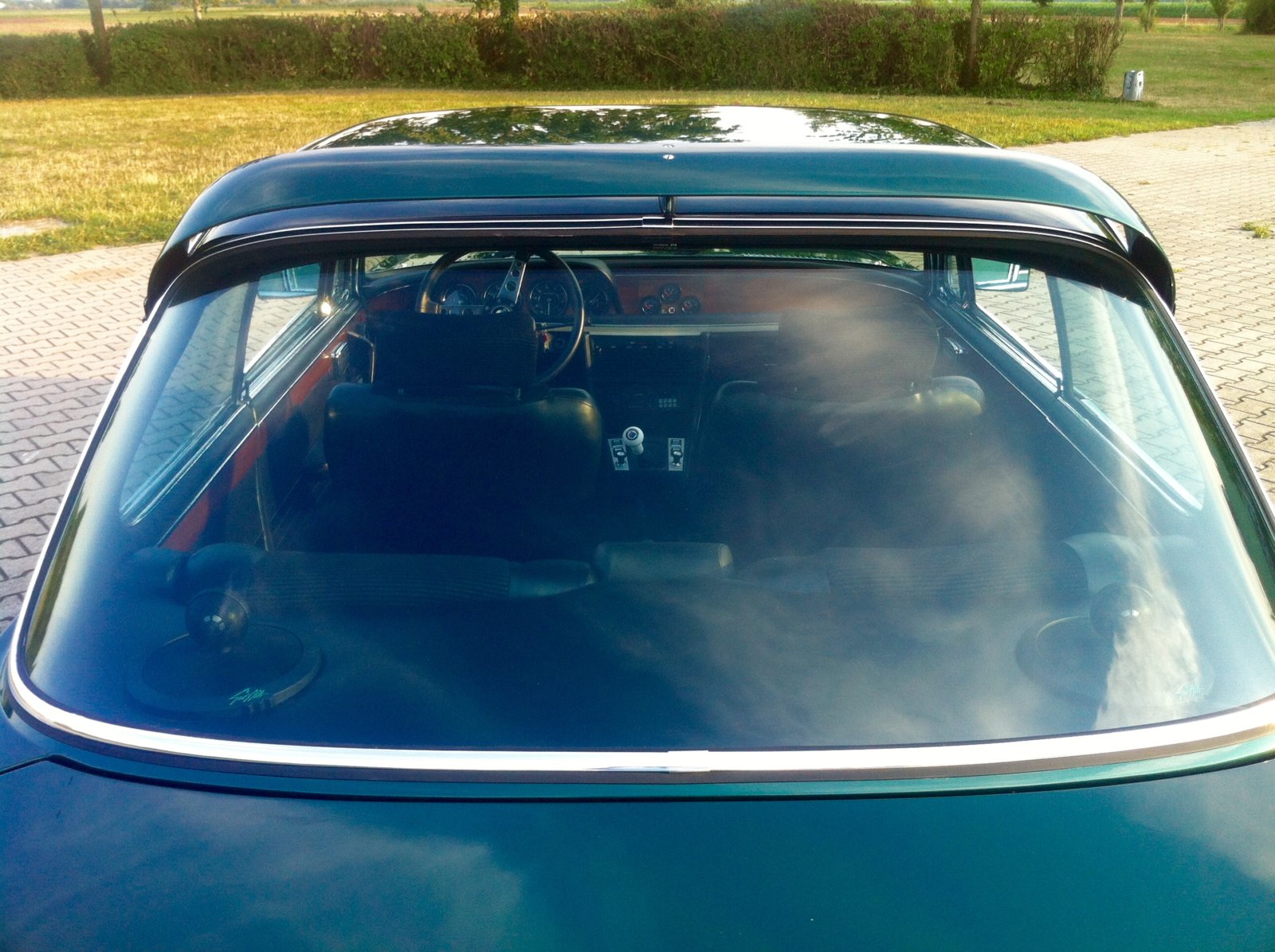

e9john Well-Known Member Site Donor Messages 159 Reaction score 72 Location Rochdale, UK. Jun 25, 2018 #1 How is the center support of the roof wing fixed to the roof, is it bolted or do you use adhesive ? Cheer's John.
Keshav Well-Known Member Site Donor $ Site Donor $$ Messages 2,976 Reaction score 3,119 Location India & Germany Jun 25, 2018 #2 Hi John, It’s bolted to the roof hoop (2 bolts/ screws) and a light double sided tape so it doesn’t move around on the roof and scratch it. Attachments 31708E77-FD67-45CF-8346-6A2EA292D2C7.jpeg 320.3 KB · Views: 182 Last edited: Jun 25, 2018
Ulrich 3.0 CSA Well-Known Member Messages 234 Reaction score 126 Location Germany Jun 25, 2018 #3 Hello John I only used adhesive Its called Sikaflex here in Germany. Its an window adhesive Regards Ulrich
