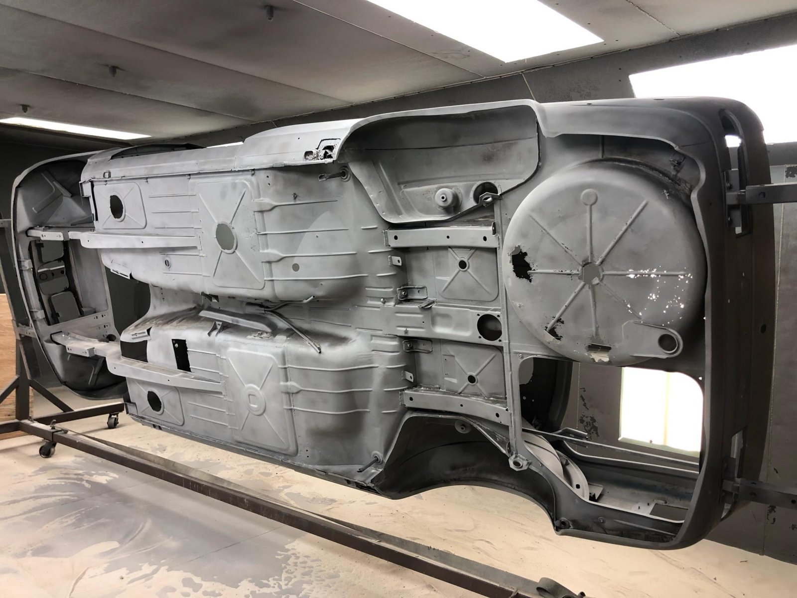

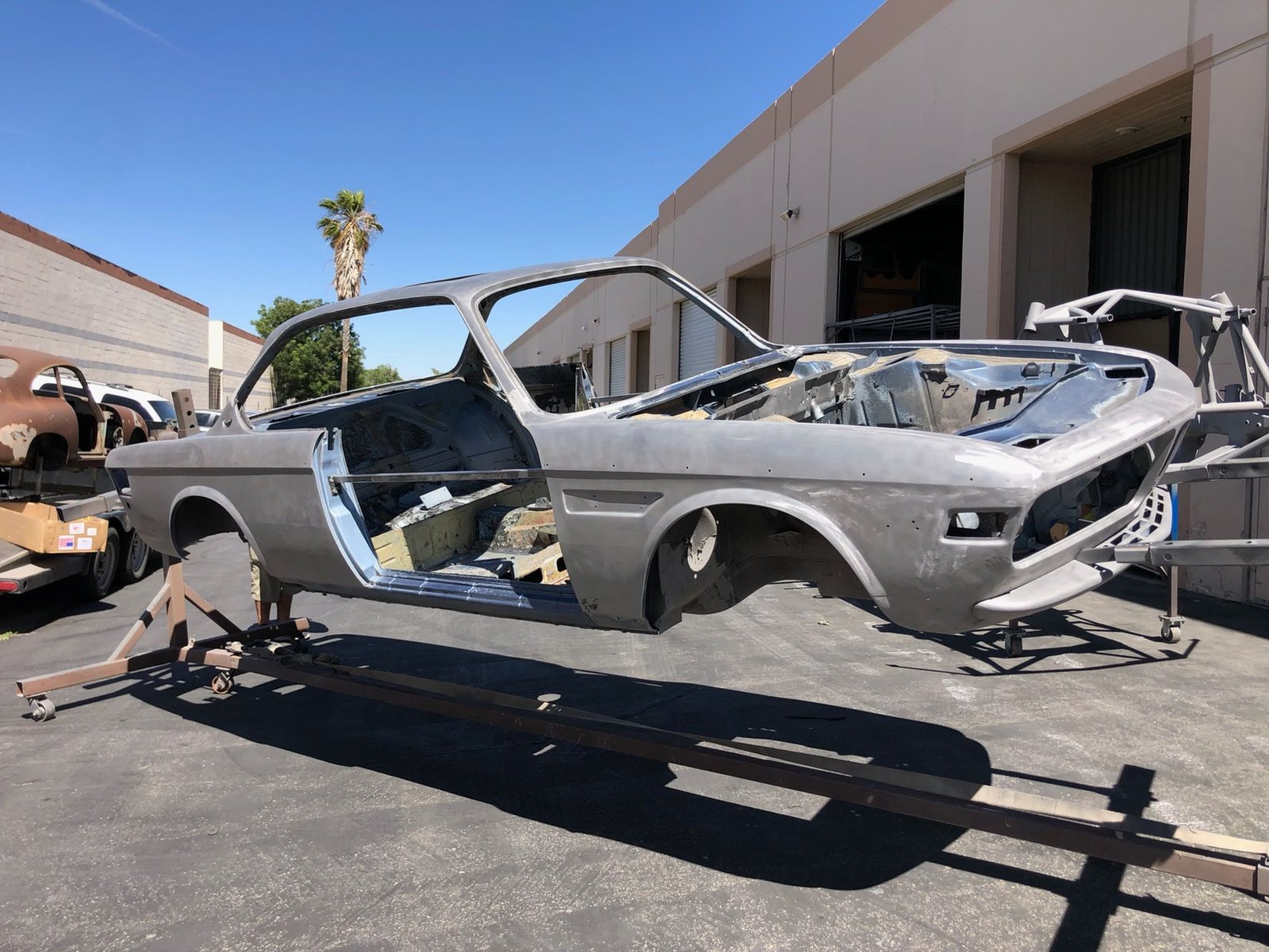

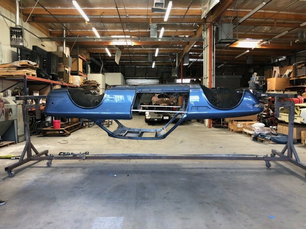

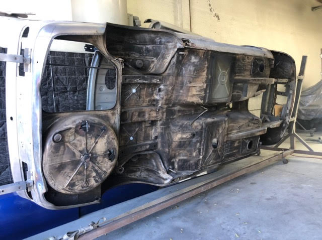

Anybody have some pics of how they adapted or "hung" the E9 body on a rotisserie? I had one on a rotisserie but the guy built a very elaborate rack I dont want to repeat, plus its no longer avail. So any pics would be appreciated, especially the underside. Please send pics to [email protected].
Front frame rails. Rear US spec reinforced bumper brackets with extra bracing welded to rear seat area.
Jeff, it fascinates me that this ends up being stiff enough to work on the chassis without adding abnormal stresses. You have a stronger constitution than I. Great access, though.
