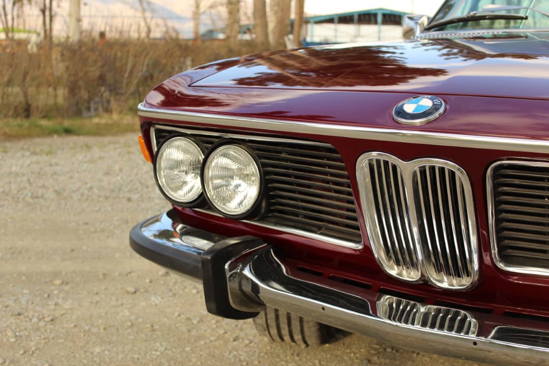

The hood Roundel originally had a base/socket as well but these are extremely hard to find. The one piece raised letter badge is 87mm. Walloth has several and A51145081747 is for use with socket and has raised letters it seems. I think I bought one of these.
The trunk base shown at Rogers is correct and it lists the Roundel as 51141872327. This Roundel should be 82mm.

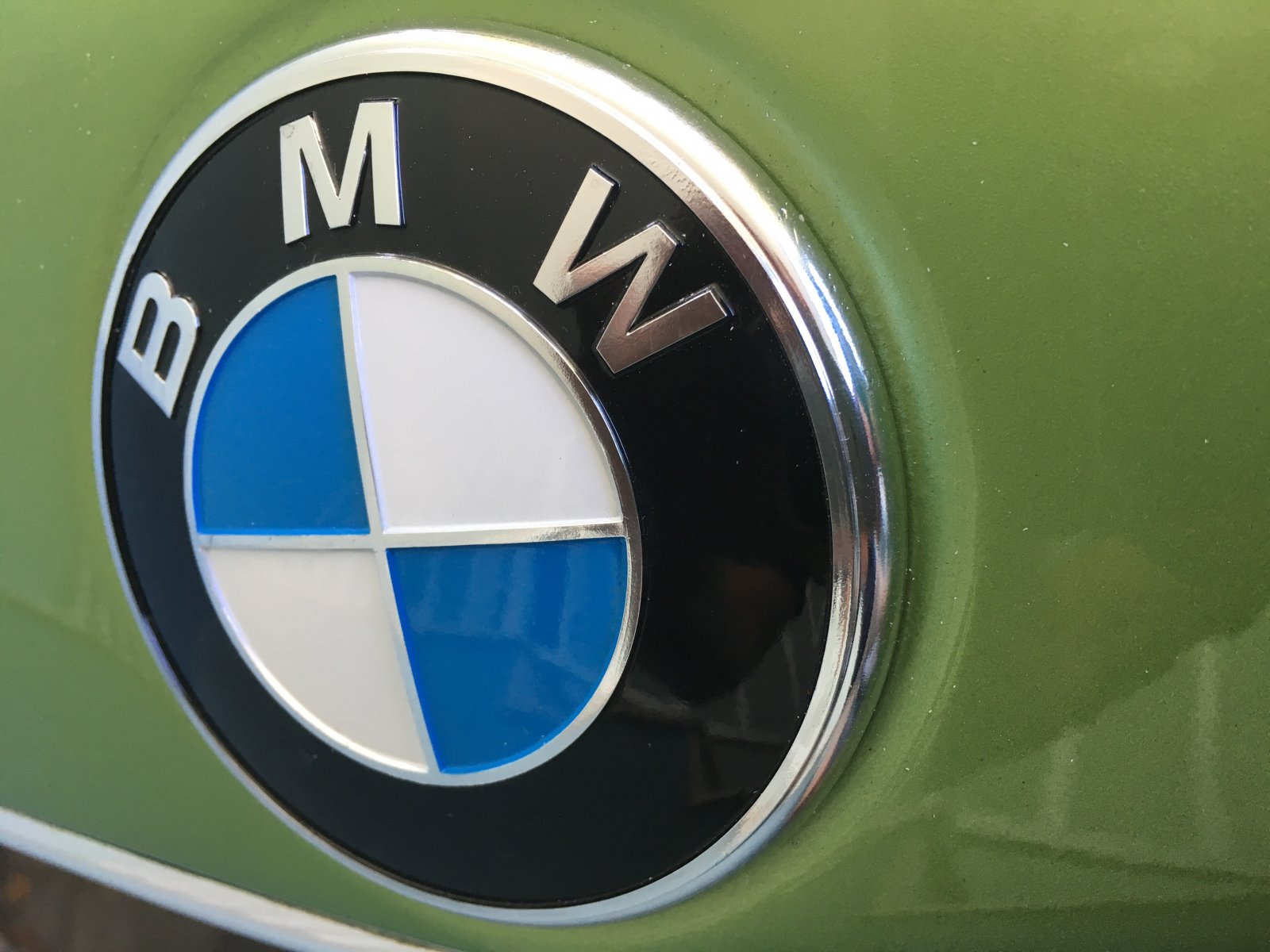

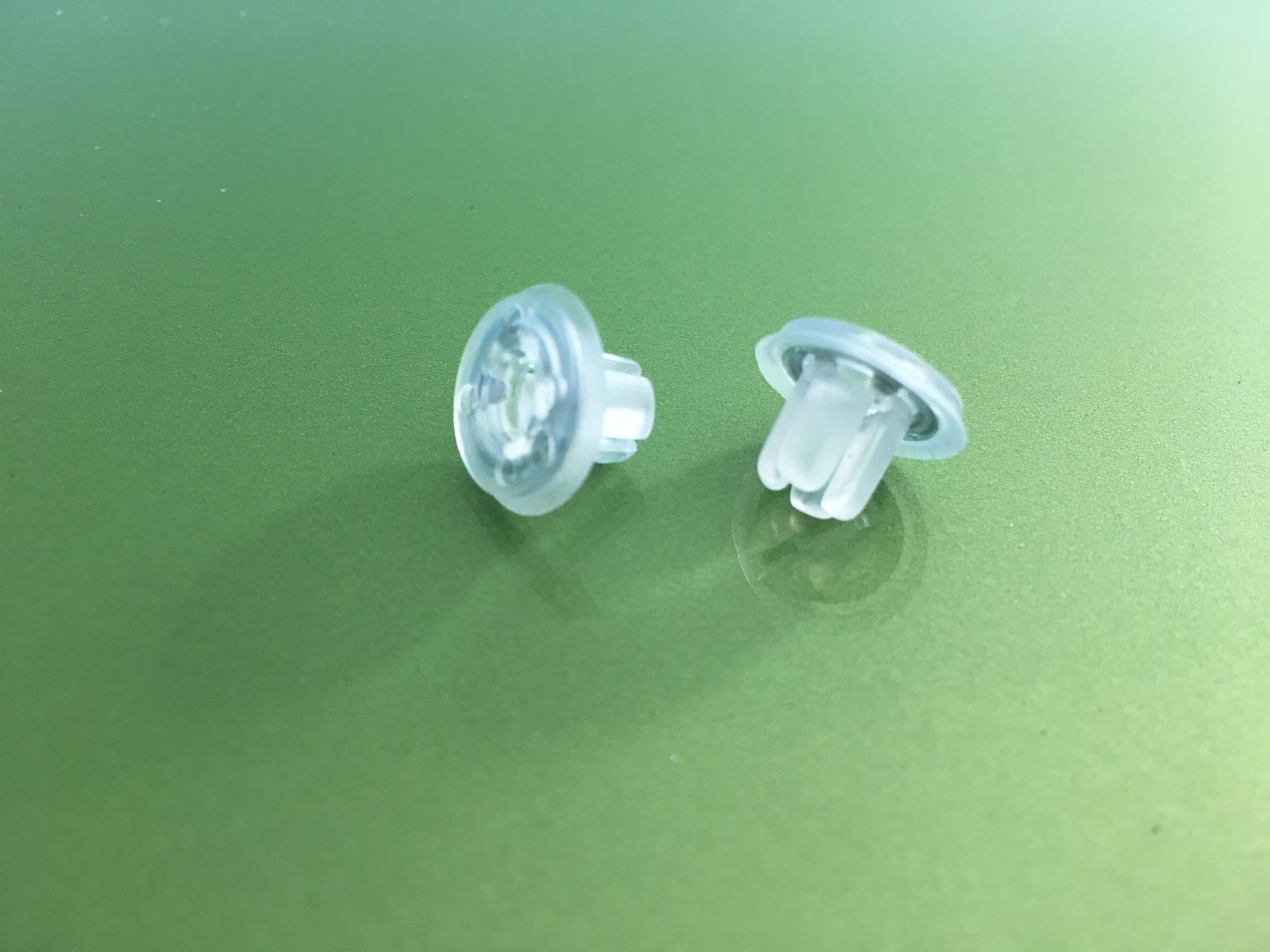

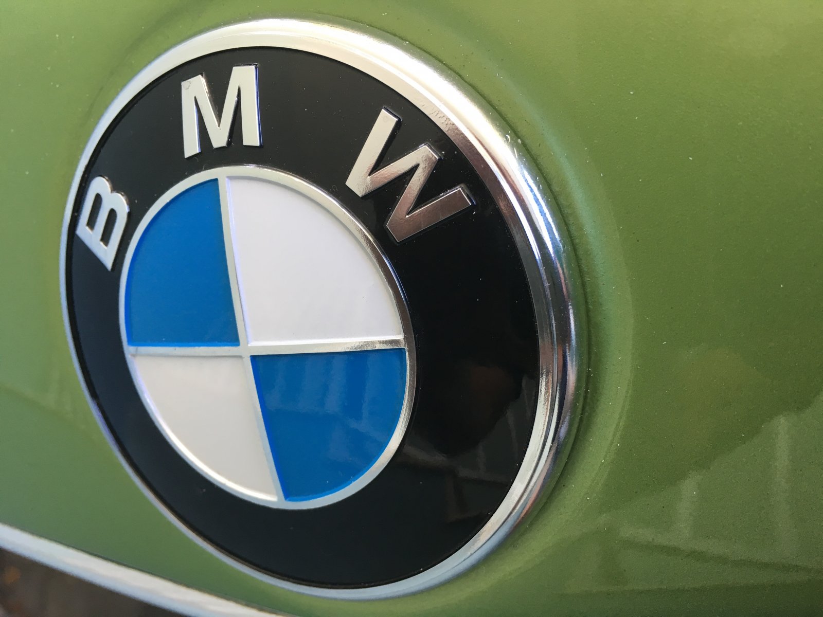

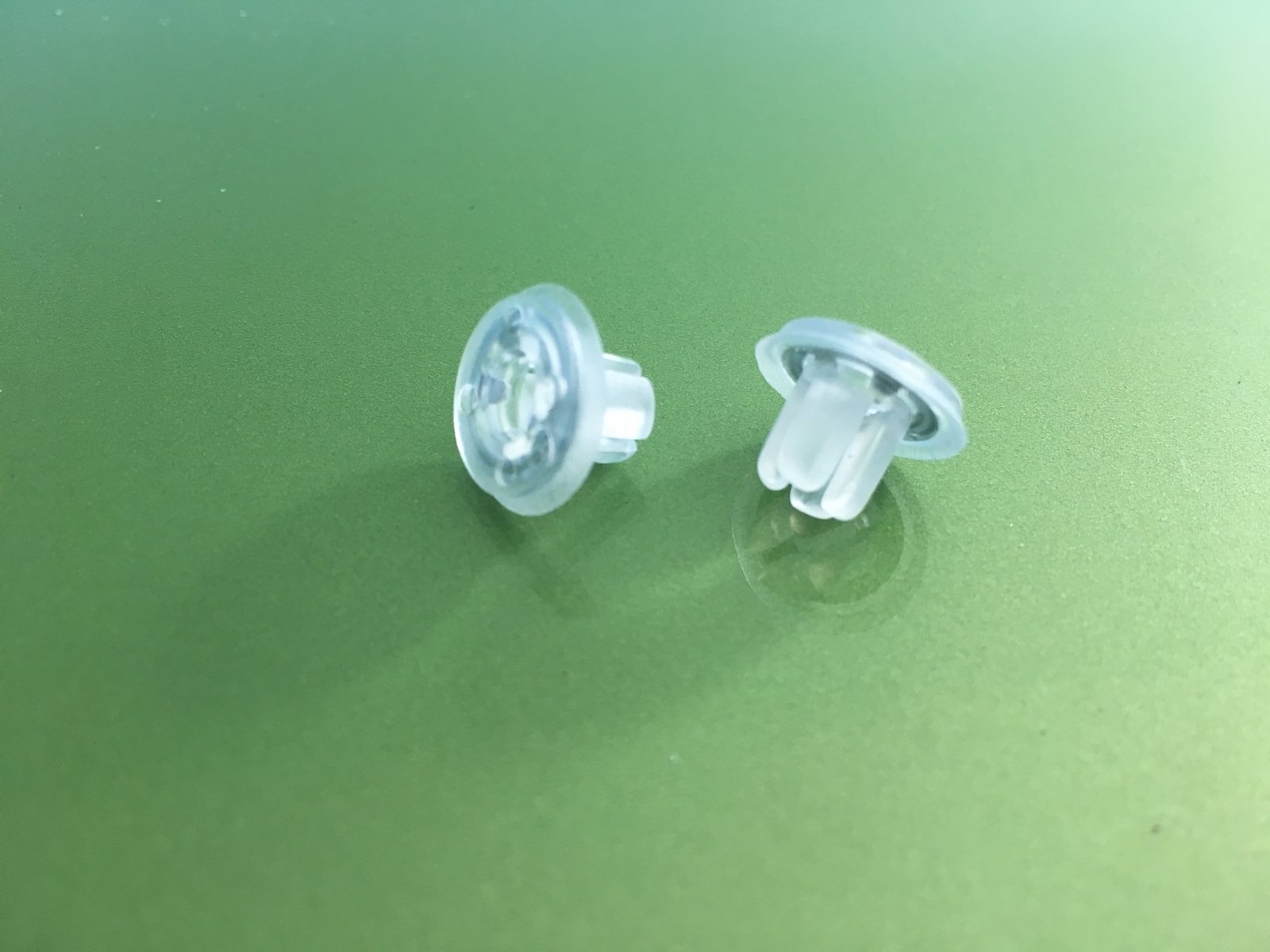

I recently replaced mine (hood and trunk) but with just the newer one piece without a base from W&N. I didn’t like the newer grommets they came with so I used grommets for an E30 that I got at the local BMW dealer pats department.
View attachment 82194View attachment 82195
Are you able to share the part number of the bonnet roundel you purchased from WN?
A51145081747
I also purchased one last year, very nice & well made badge.
Yes, that is the same part number I purchased for the bonnet. I also purchased the one for the rear trunk but only a flat version (no raised letters) was available.
