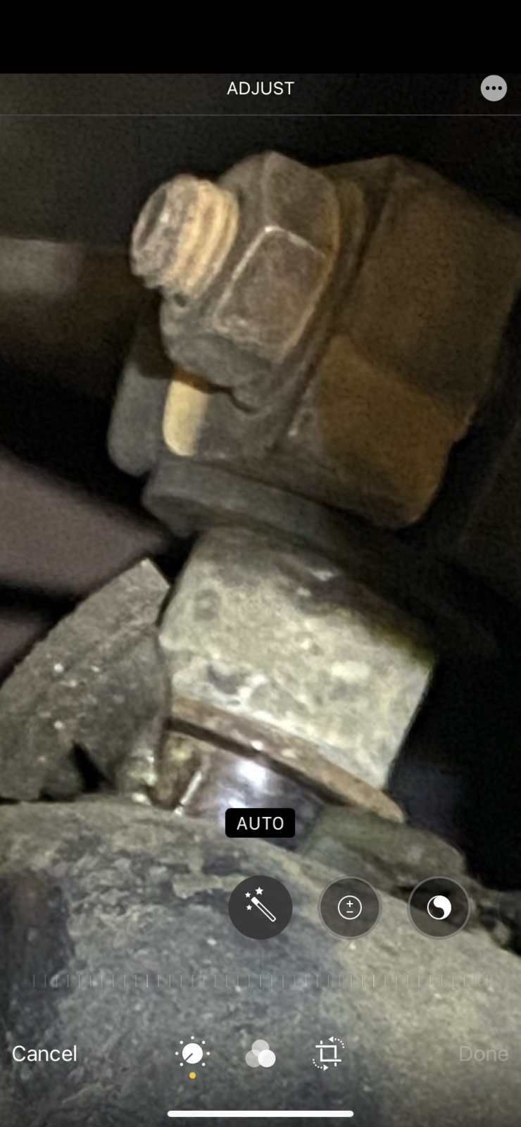

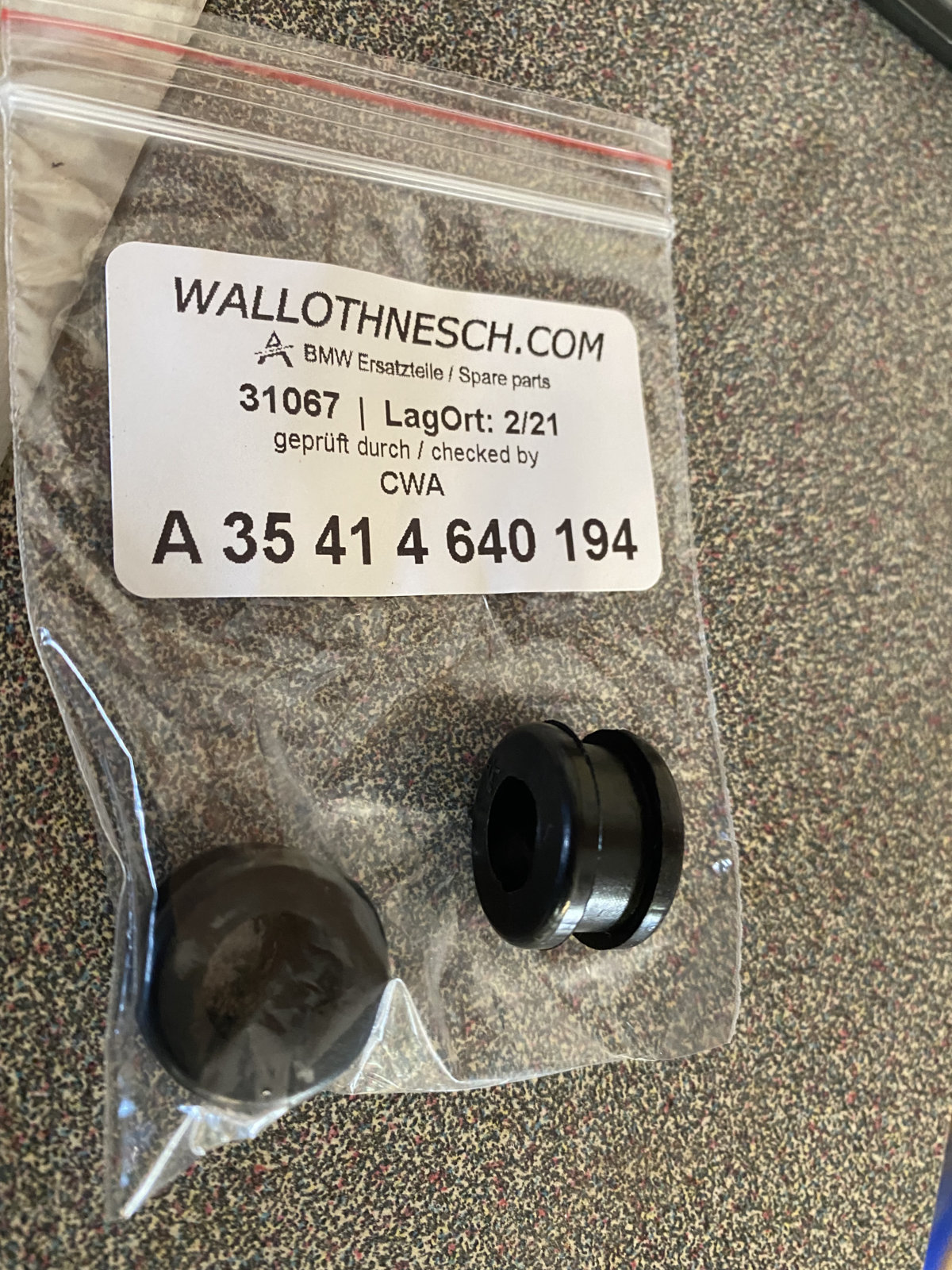

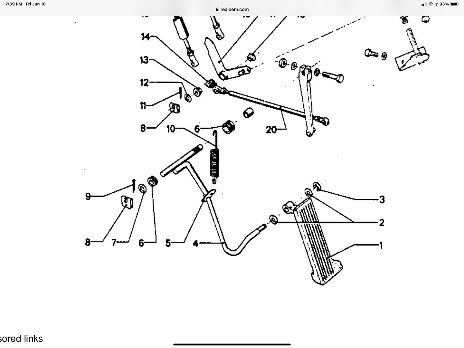

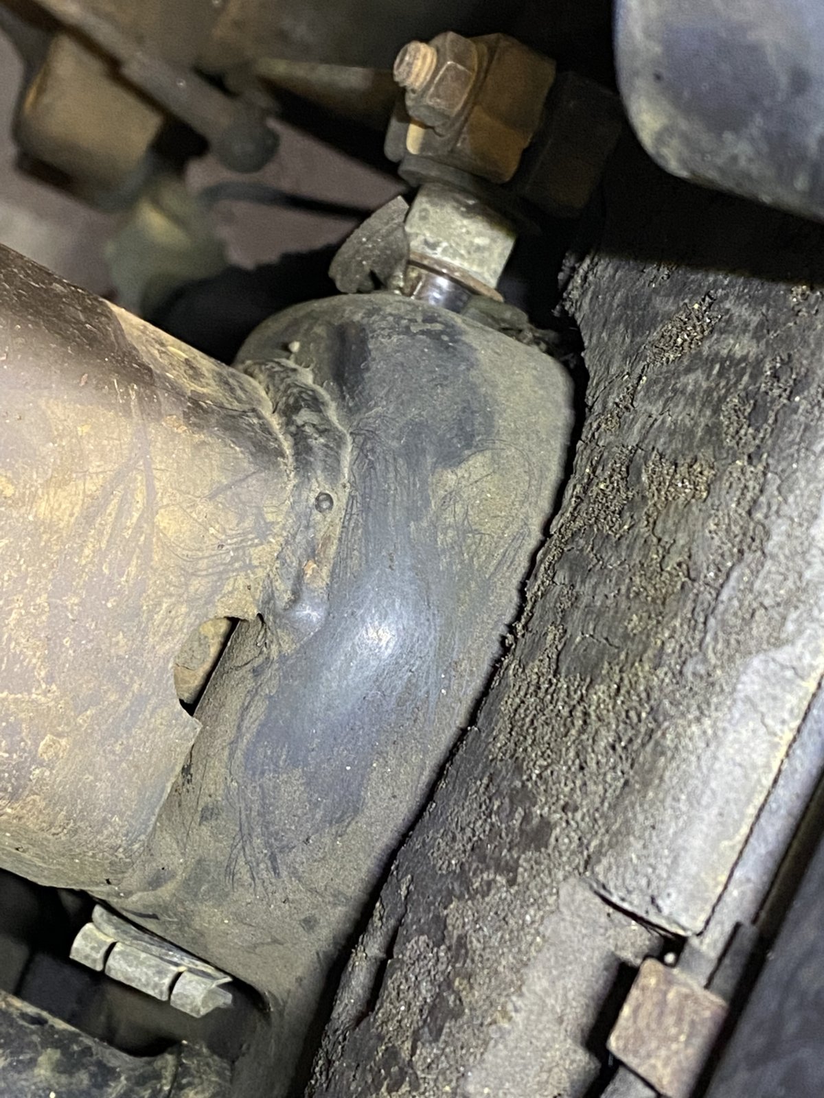

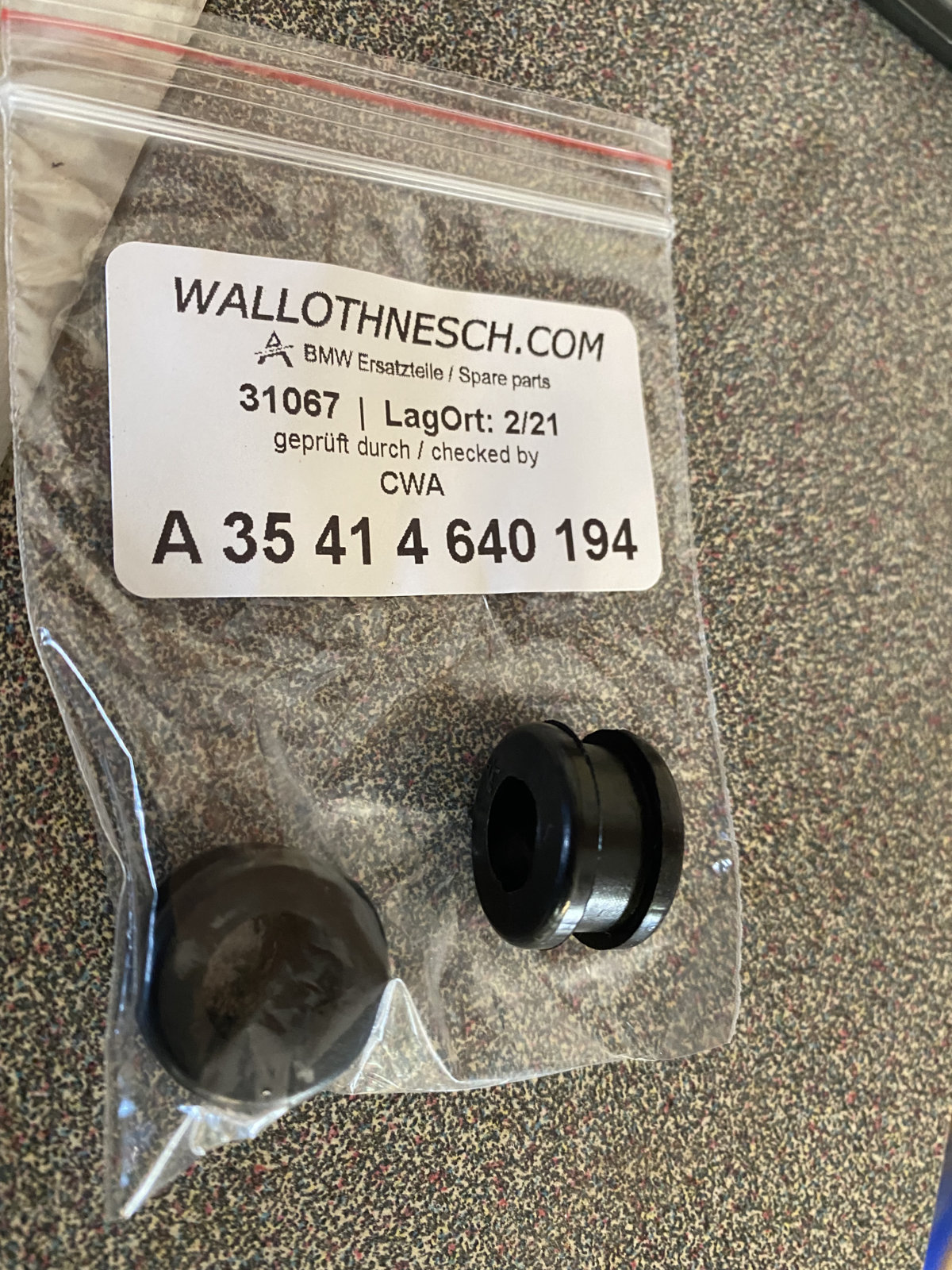

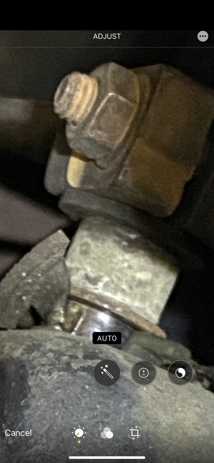

Driving the other day and gas pedal kind of hung up after a little looking determined that #6 bushings were gone and it was metal to metal…replaced those today what BD6CF896-97C3-447C-8E99-57009CD153F3.png78207C0D-841F-4F6C-89C2-44E8603B5746.jpegE4DC463C-FDDA-41D5-BF6A-DD11682A23C5.jpegA6AEA68D-A155-42AB-ABDF-CBE6345A51E7.jpeg a difference it made, looks like this was designed by same guy that designed the oil filter…
