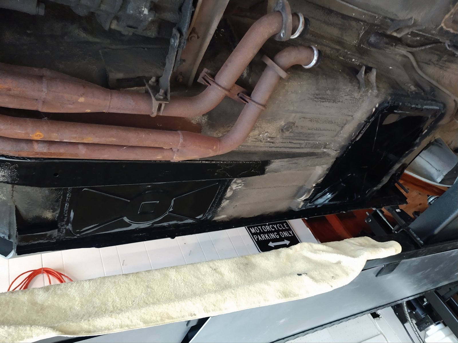

Wondering what y'all have experienced with this and maybe what works well. As you can somewhat see, my undercoating is cooked off above the headers.

Something about those exhaust pipes looks odd, like me. It seems they are a 3 into 1, and a 2(?) into one. Must be the angle of the shot.
Is that POR-15 on floor patches, or something else?
Exhaust is 3-1 for both headers, and yes it is por15. I plan to wait a few days before light sanding, then going to try the 3m undercoating over the POR. I also painted my arm and can say the stuff bonds well to everything. ;)
