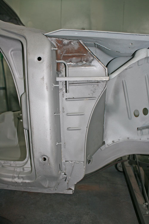

Areas of the chassis that rot from the inside out. Does anyone have pics of the box sections?
That or a descrption of exactly where they are.
A few photos of the exposed 'A' pillar. The box section is the vertical piece with the rounded corners.

Great thanks for reply. Are there any other trouble areas that are not visible (like the front box sections)?
The car is being taken to bits so most of the bad parts will be obvious, im trying to find out if there are areas that could be missed during a restoration.
