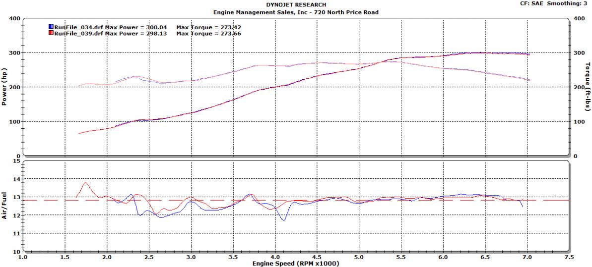

I also own a 1988 M5 with an highly tweaked S38 motor that I built in 2010.
At that time I had over $6000 in parts and head work to rebuild the motor.
It had a burned piston.
So an S38 rebuild now days would probably be $12000 or more depending on how much you want to do.
The biggest problem with these motors is that the valves seem to develop problems fairly easily. Head rebuilds are $1200 or more.
Never had a block problem and don't know anyone that has.
Here is the latest dyno run last fall and this is at the wheels. Add 17% dyno loss and you get E46 M3 Power and torque.
And the sound, oh the wonderful sound at 7000 rpm.
Here is the page about the build in 2010. I have since done a few more tweaks last year.
