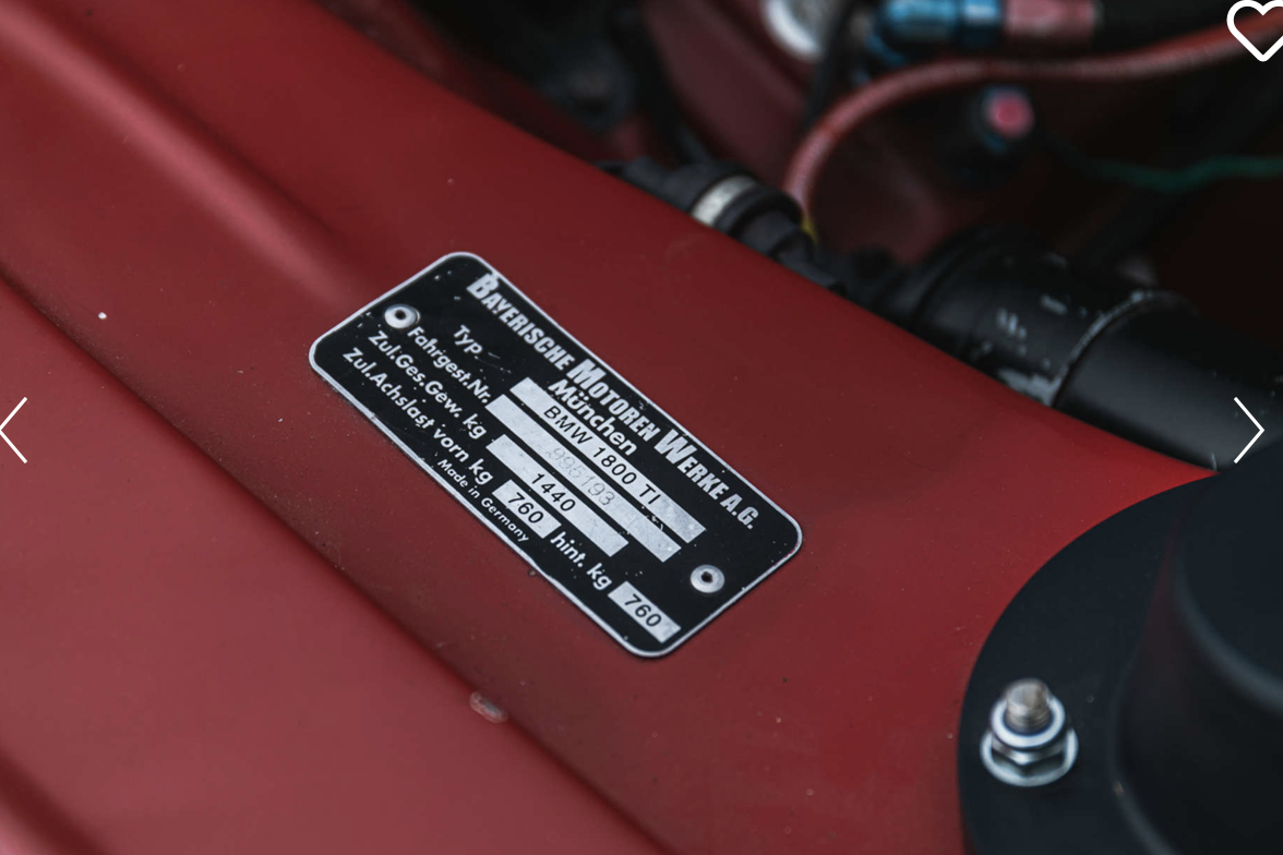

"An original 1800 Ti/SA that was fully rebuilt as part of Dieter Quester/Scuderia Bavaria's successful entry into the 1991/92 FIA Historic Touring Car Championship. Raced by our vendor for the last 17 years with even more success."read the ad in glowing words. Included was a prominent picture of the VIN plate:
Imagine my shock at seeing a car with the same VIN as the TiSA I have owned for 10 years!! And a car had such notable names associated with it, and such 'provence.'

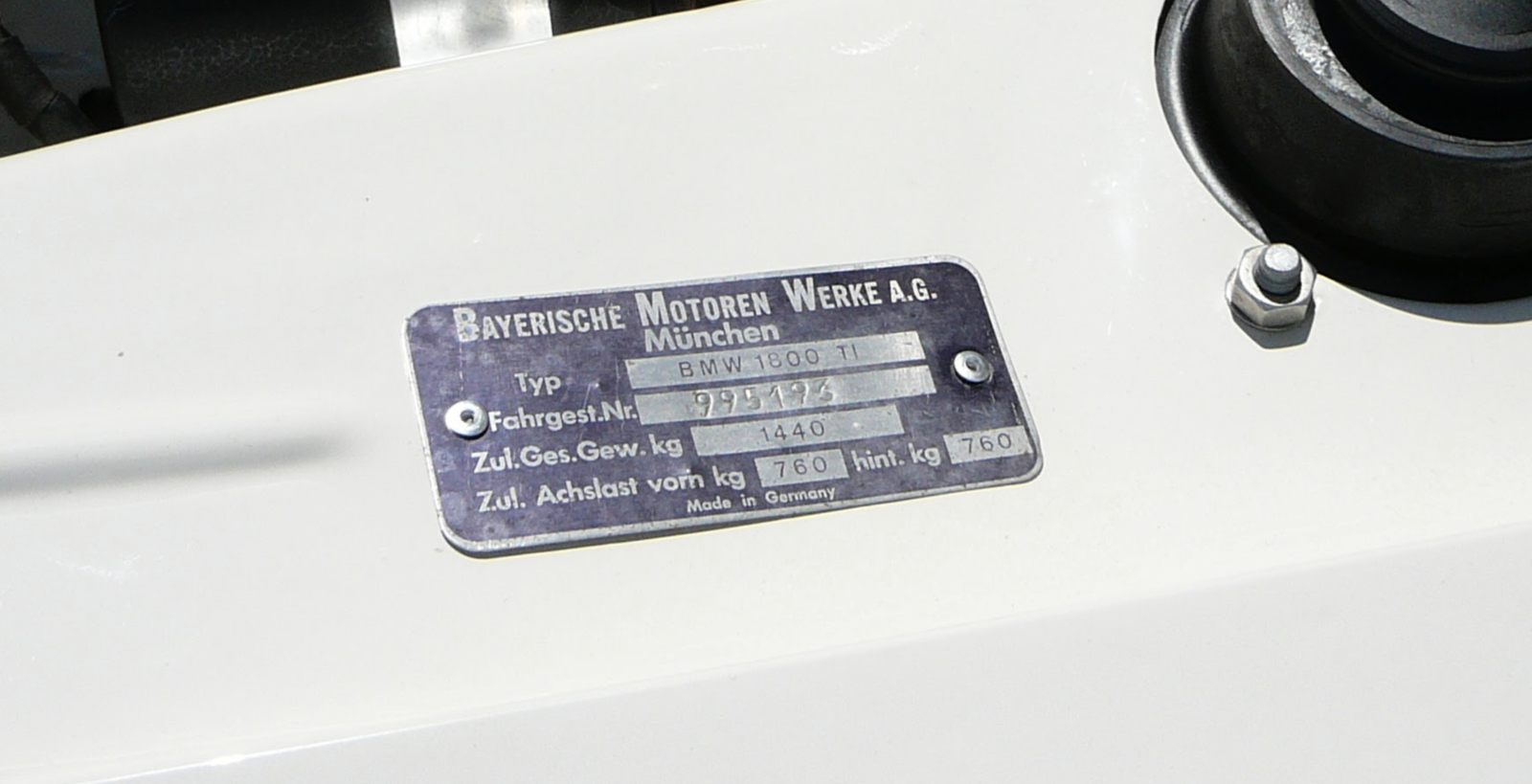

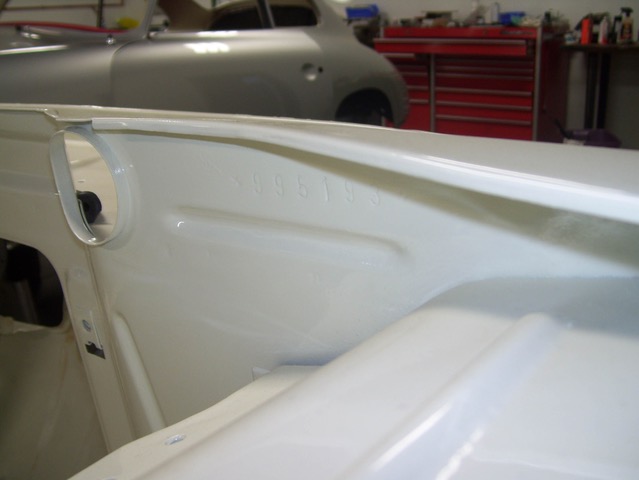

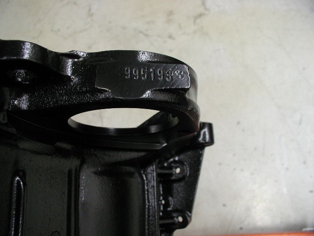

I immediately contacted the auction house and informed them that the car they were offering was a fake and that I had owned the original for 10 years. I sent along photos of my VIN plate, engine block stamping, radiator surround stamping, and Certificate from BMW and promised to put this information on every BMW forum I could find so that anyone interested in his car would readily find it with a Google search if they did not take immediate action:

An amazing story/warning. I assumed there was fakery from the start when I read your post. And then the VIN plate looked too "clean" to be attached to a car with this racing history. Or just too new for a car that age. Your photo of your VIN is what I expected. Good work!
