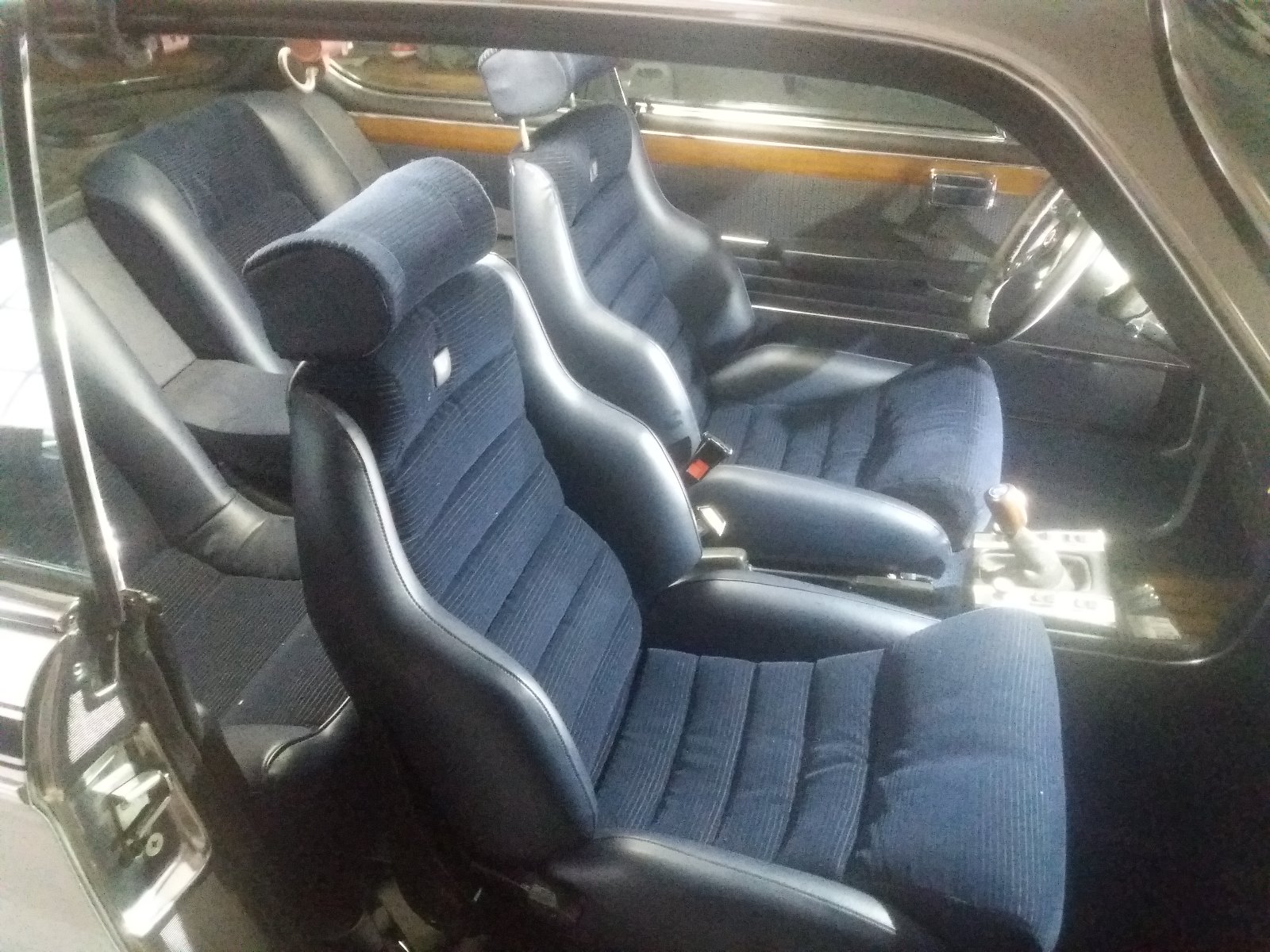

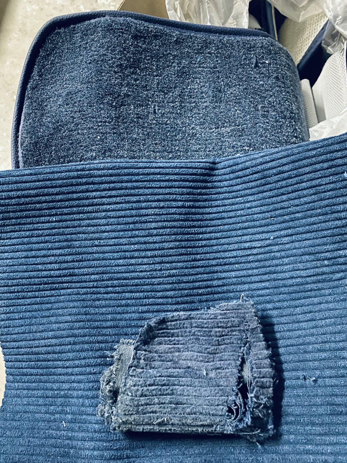

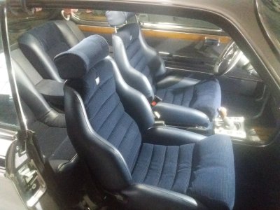

Background: I want to change my CS interior to "CSL style" with Scheel bucket seats etc. After searching for a long time I now have a Scheel 100 (first picture) and a 101 (second picture) in great original condition. I thought that the 101 type was identical to 100 except for the backrest adjustment feature. But putting one next to the other shows small differences in design. As seen in the pictures the 101 has rounder shoulders and fatter sides. The 101 is also missing a seam at hip height. Type 100 is slightly taller (third picture). I'm 99% sure that the seats have never been re-upholstered.
Now I'm hesitating, shall I start searching for one more seat or just leave it as is? Aaaargh, luxury problem!
If anyone with experience (or owning both type of seats) can confirm/deny my findings I'd appreciate that. Thanks!
PS! Someone told me that the Batmobile came with type 101 for driver and 100 for passenger. Is that really true? I doubt it. From old pictures I'm not able to determine that.
Scheel 100
Scheel 101
Scheel 100 (left), 101 (right)
I’d say that the 100 is newly done but the 101 is original. You can see it on the 101’s vinyl, more structured than what’s now available. I had some original seats too and the vinyl was like on the 101.

Hi, while reading here in the forum I stumbled over this old thread.
I can totally confirm your findings, Nils. My pair of a 100 and 101 is looking exactly the same from the extra seams on the 100 to the slightly different type of vinyl. I don't think that your seats have been upholstered yet. Sure my answer is a bit late, but it might answer upcoming questions.
Best René
Best René

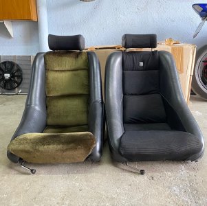

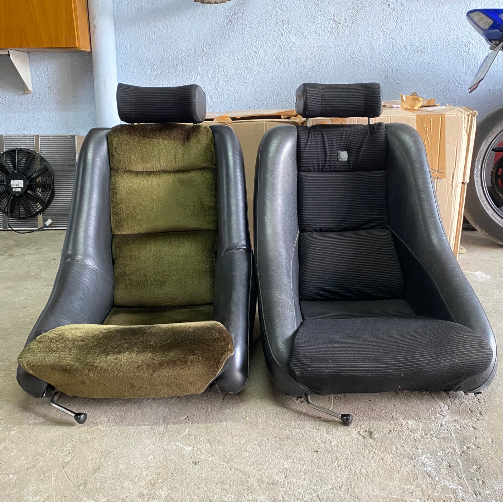

I have a scheel 100 question and thought I’d post here rather than starting a new thread.
I have an original scheel 100 in the standard vinyl (or leather?And corduroy trim, I have been searching for a matching seat.
both seats will be retrimmed so trim doesn’t matter, but the seat base should be the same!
So I found this one for sale, it’s completely corduroy, I haven’t seen that before but it looks original?
is it the same seat with different trim?
Any differences I should be aware of?
Appreciate any input. Thanks!
Mine:
The other:
Hi James,
the declared expert on Scheels‚ is undoubtedly @Gerrit. Send him a pm. My 2 Cents worth is, the Scheel 100 with Vinyl (never leather) is quite different to the ASS (no pun intended) seats which although they look similar in shape, were never officially used/ installed in a Csl from the factory. But being a jack of a few trades and Master of none, let the true experts speak ;)
