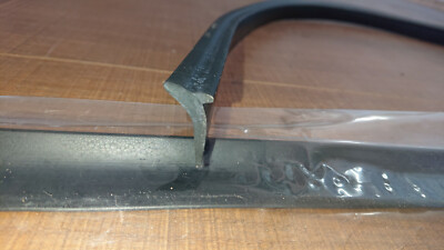

I have forgotten which way this seal faces, is this correct or should it be reversed? The concave side is facing the sill.
Well maybe we are both wrong because that is the way I installed mine!
Awesome paint, I'm blinded.
When I replaced mine I did not pay attention to the original ones I pulled out but chose the same orientation as your pic.
I have no idea but your orientation makes the most sense to me. Anything in the blue book by chance?

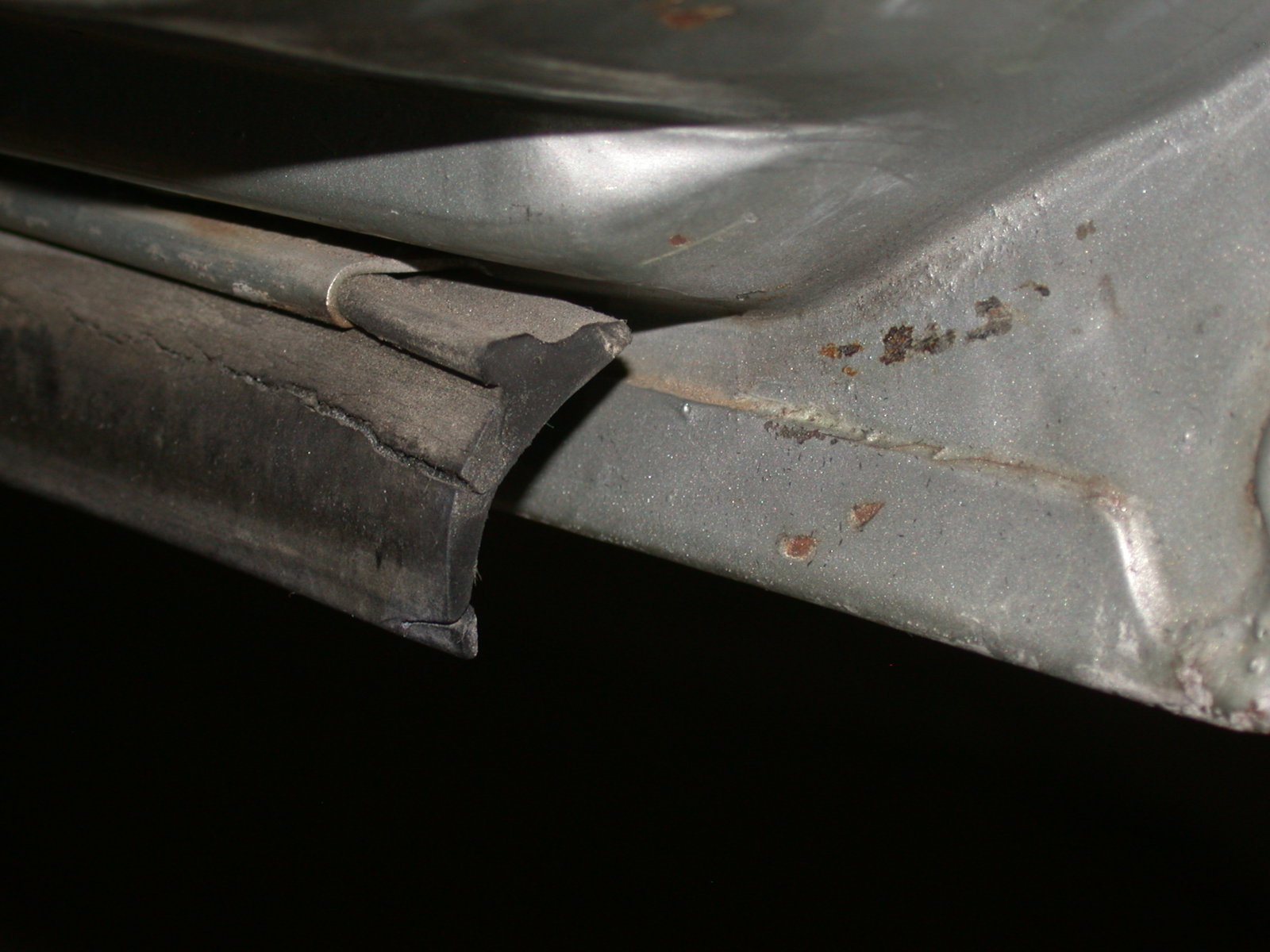

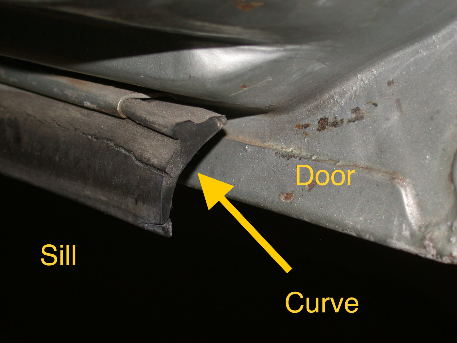

Chris, this is my RH door... original paint, and I suspect the original seal.
It extends over the channel on both ends...
