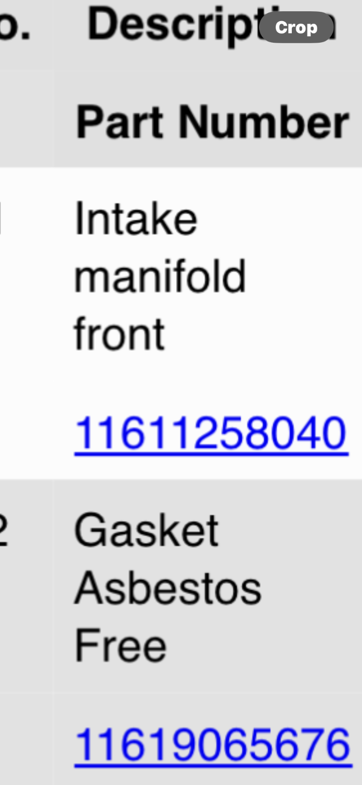

I’m looking for this manifold part number in photo underneath manifold usually has 7 numbers. Anyone have it or the pair if I must. Looked at 1970 2800 and carbs (webers) were much more level and linkage does not touch fuel pump.. please pm or just reply I will get back- I need this to work so it can get painted( no one wants to push car) and thank you everyone for your comments and insight.

Why do you not believe me when I tell you that you have the front manifold you are searching for in the rear position? It is the only one with the large vacuum port for the brake booster. The one with small port that belongs in the rear is mounted on the front, totally backwards.
I am aware, they are just mocked up, my issue is the part numbers are the same- swapping the manifold still results in the height issue. The manifold in the pictures are not mounted- I believe you- I just am trying to find a manifold that has the part number for front as opposed to two manifolds with same number. Perhaps it’s the way it is- however I looked at a setup that had two different manifold number and the difference is almost an inch and when installing the throttle rod it clears fuel pump by 1/2 inch as opposed to almost rubbing. I know most aren’t as concerned however the clearance is really close with air cleaner to hood. Sorry
