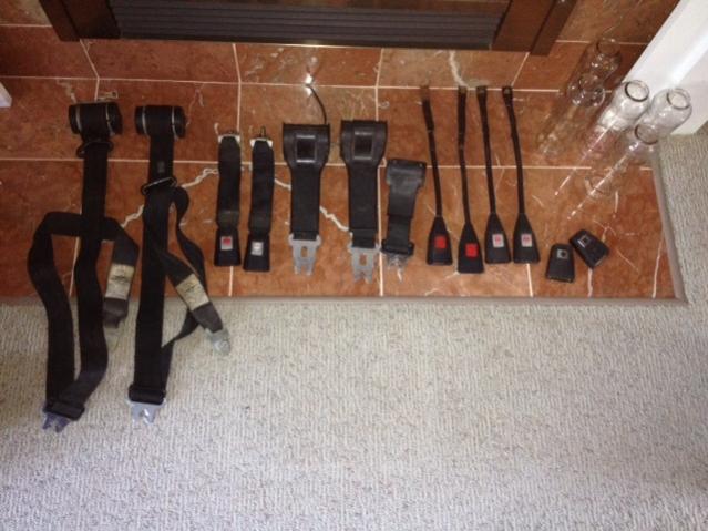

Seat belts
Can somebody help with identifying the seat belts in this photo. Trying to figure which ones for front and back for the coupe.
The two on left are front seat, next four are rear seat, all are Autoflug which is correct. You have four receivers for the front, only need two. However, the 2800CS has no mounting bolt on the roof in front of the grab handle so they won't help for front seats. Your coupe had a fixed shoulder belt mounted near C pillar and lap belt was separate which connected to the shoulder belt. Not very mobile and not comfortable. In 74 coupes got a retractor near C pillar that operates horizontally, most retractors only work vertically. The rear arm rests were modified to accommodate the retractor and had a slot for the belt to move.

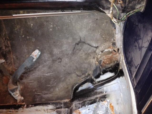

Back seat belts
I can not find the holes for back seat belts. I see where the inside holes are. But cannot find the outside ones.
See attached pic
Can everybody help.
