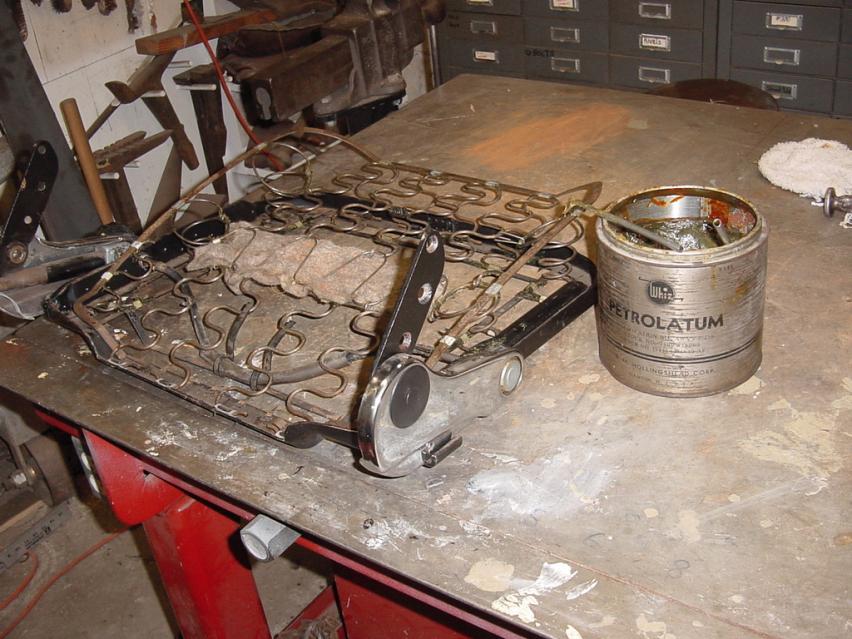

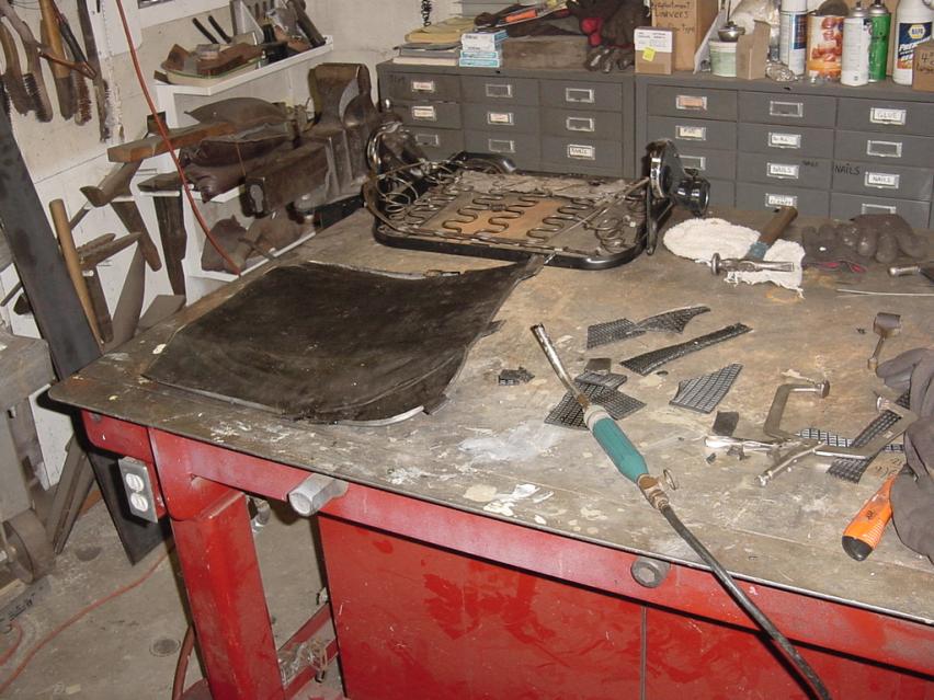

I’ve made quite a few seat pans for motorcycles but these are the first I’ve ever made for a car. I just figured the seat springs were always going to cut into the rubberized horsehair or foam rubber so this was the only solution that made any sense to me. Making these pans is what I consider rough work (they are hidden under inches of foam) that doesn’t have to be perfect enough to paint so it’s almost relaxing work for me.

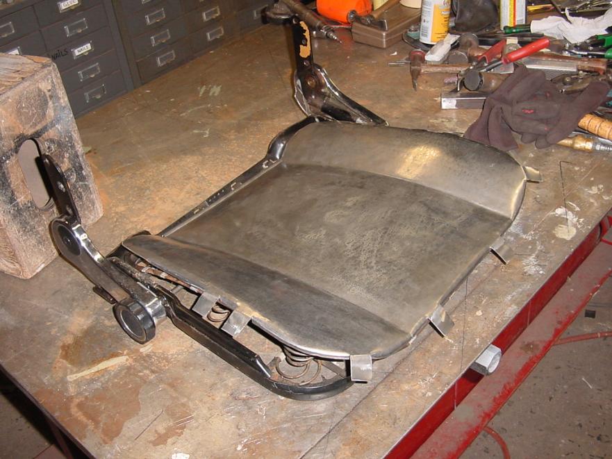

After I got them to be the right shape I covered the underside with torch down roofing so the springs can’t touch the pan & squeak.
I used an acid brush to push ultra thick tank track grease (seriously, my friend’s father liberated it during WW2) into all the clips and retaining points that hold the springs just to further eliminate any chance of squeaks.

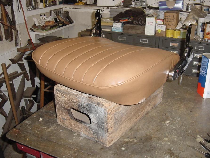

I installed the seat pans over the springs and bent the perimeter tabs over the springs to retain the pans. I installed the rubberized horsehair over the pan and covered that with a layer of new foam which I shaped with a sanding disc on a pneumatic grinder. The whole thing was kind of a messy crude job but something I don’t think an upholstery guy could handle --- well at least the seat pan part. I reinstalled the seat covers, they don’t look too bad considering I’m a metal worker, not an upholstery guy. ~ John Buchtenkirch
