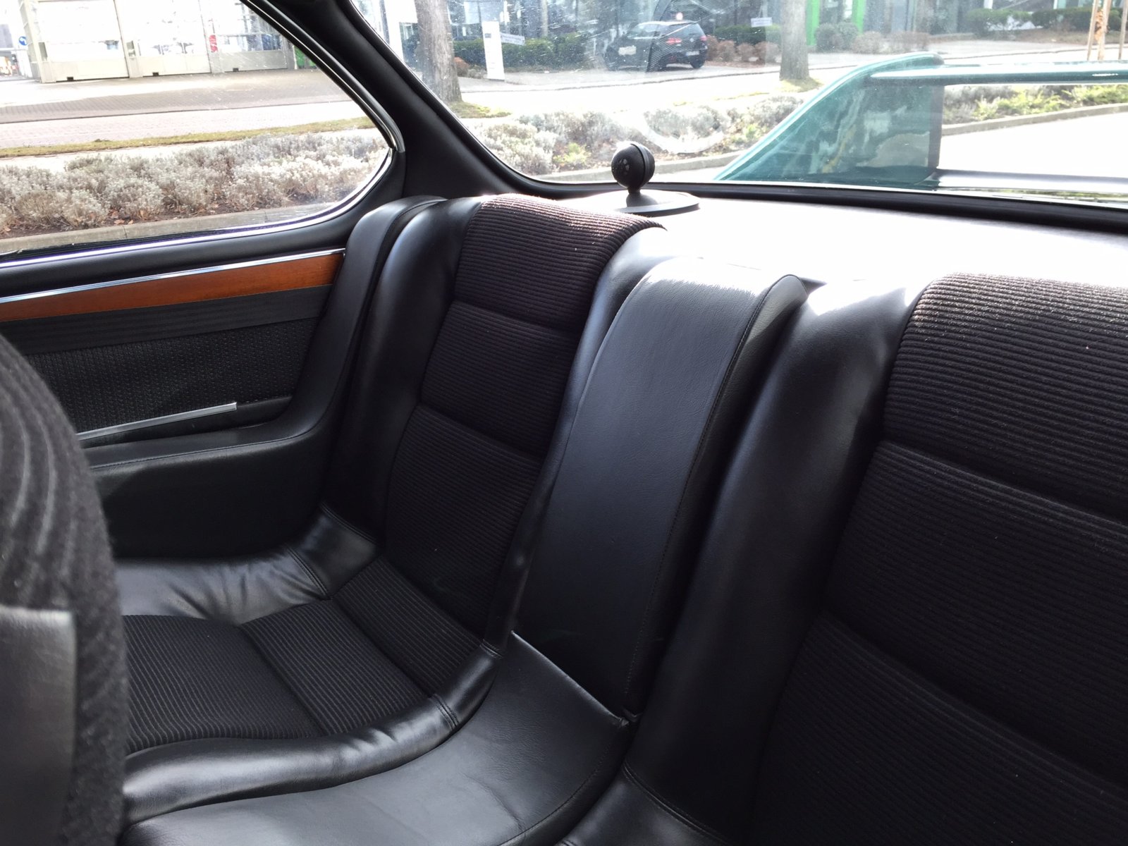

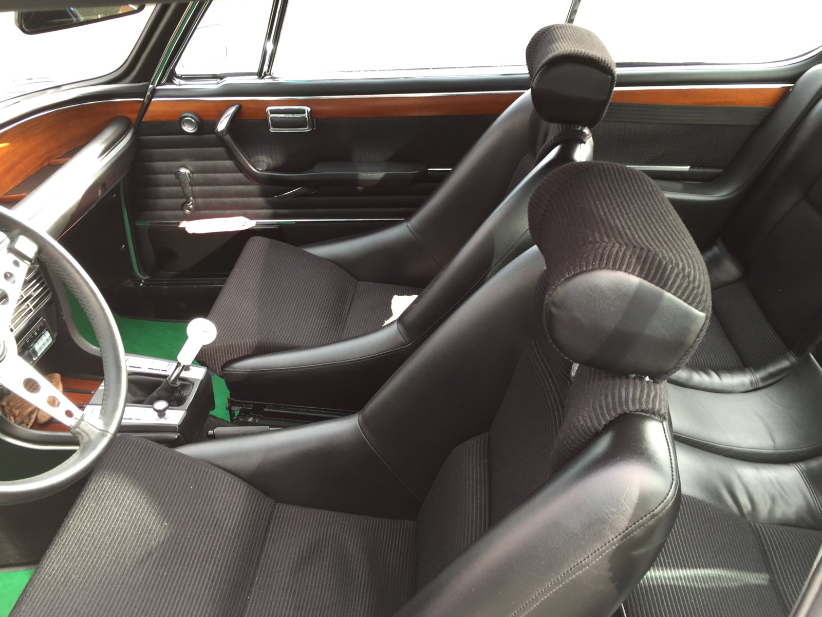

Will go well with green....my car has Scheel seats but you’ll get the idea.....
Gerrit is the Scheel expert and will be able to advise on how much cloth and vinyl etc (like Scheel emblems for the seats). If you go that route you might want to do an exact copy of the rear Scheel seats, different padding
