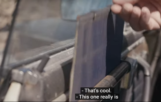

but my question comes to this odd feature/device: a door window retractable curtain:
my bet is for an invention/adaptation, but have you seen one like this before ?
here the video:
Window shade is not a BMW item when the cars were new, it was added much later & the brackets are attached to the door wood trim.

That shade was bolted on to the door. Not E9.

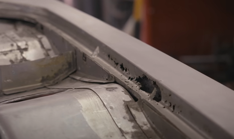

And they spend 5K at Walloth, but don't take the fenders off, nor attack the sill structure (well , at least it is not covered in this episode).
scary fenders:

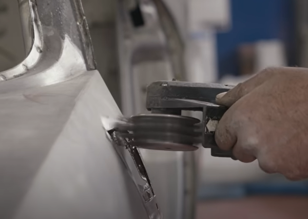

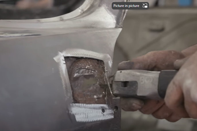

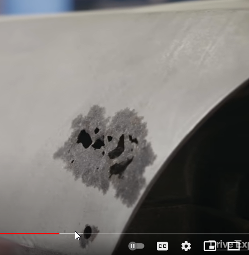

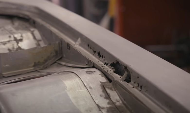

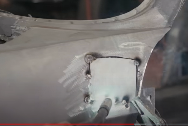

I am a bit skeptical as well about their repair method. For example:
In the front wing there are a few rust holes. They cut it out, and voila, they see rust in the layer underneath (in the Apillar). So they decide to cut that as well.
hole:
2 chops:
wire wheel the brown stuff away (-isch):
insert a plate:
But what happened to the brown stuff that's just around the corner, the inside of the fender and the A pillar?
I get a feeling they are skipping a ~30 K bill to do the fenders and sill properly....
Or i might be surprised in a second episode!

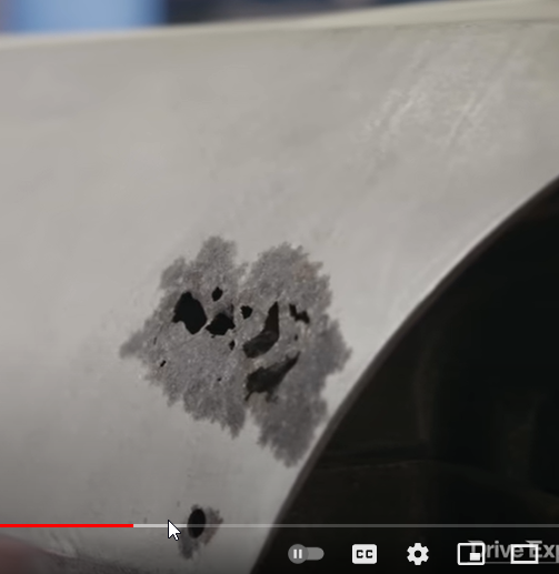

scary fenders:

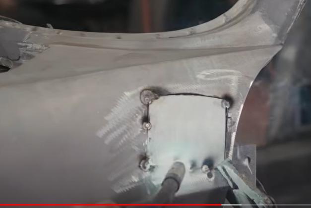

I am a bit skeptical about their repair method:
In the front wing are a few rust holes. They cut it out, see rust below (in the Apillar), so decise to cut that as well.
hole:
insert a plate:
