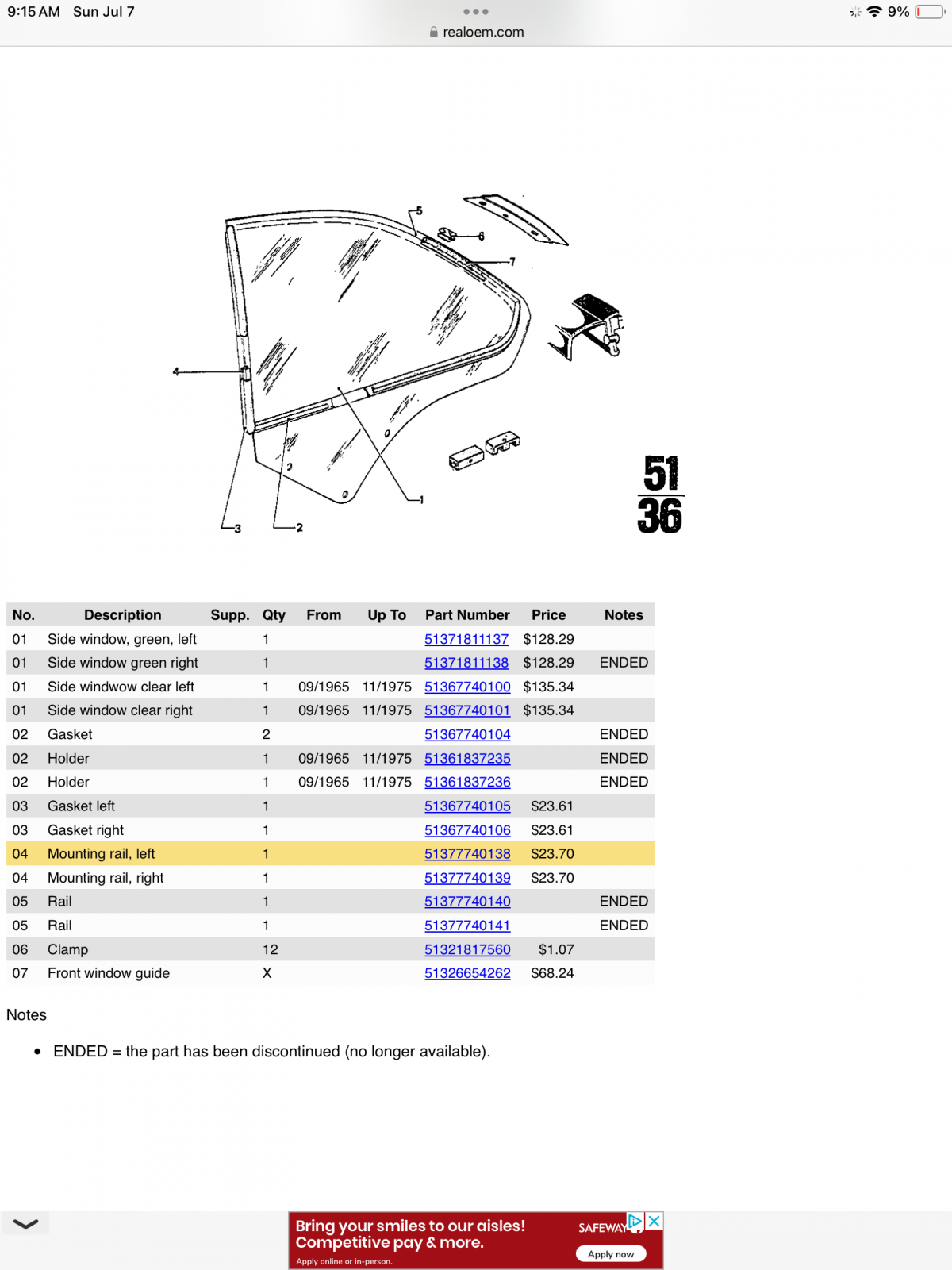

Seeking vertical silver piece between the front and rear window's (see pic below with red for my 73 3.0 CS - cannot find on real OEM, Maximilian, etc
