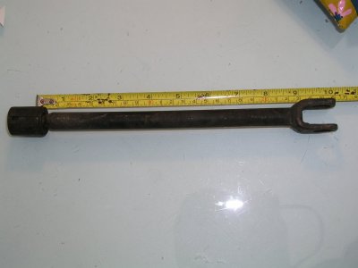

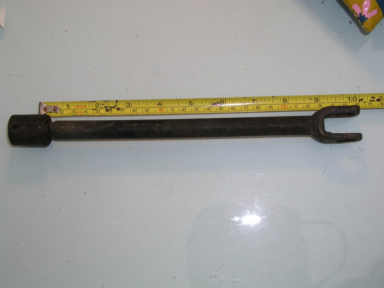

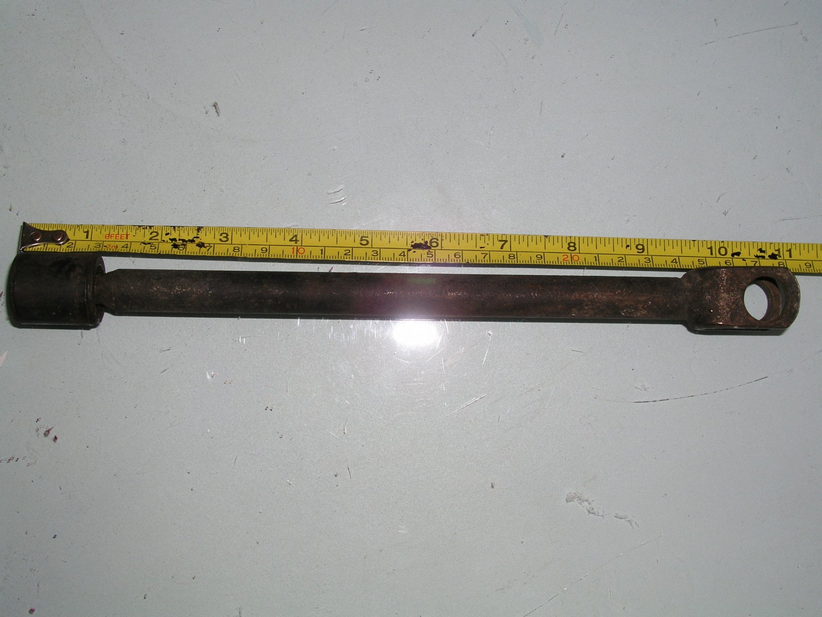

Is this an E3/E9 selector rod? I am prepping for a manual conversion and wondering if anyone has measured their stock 4-speed selector rods. My understanding is that there were two lengths/versions - #s 25111203569 or 25111202277? The one that I have is 247MM in length (center of front pin center of yoke hole out back)

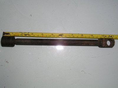

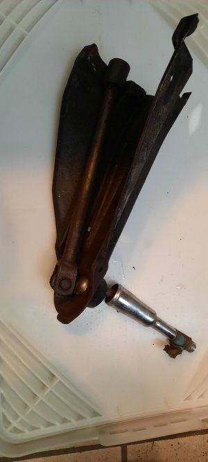

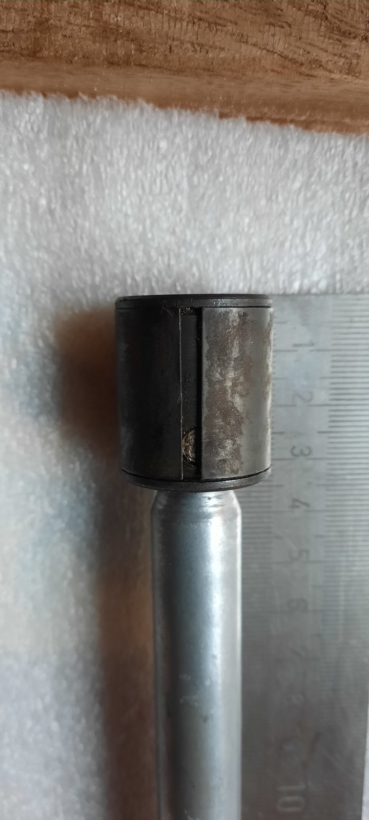

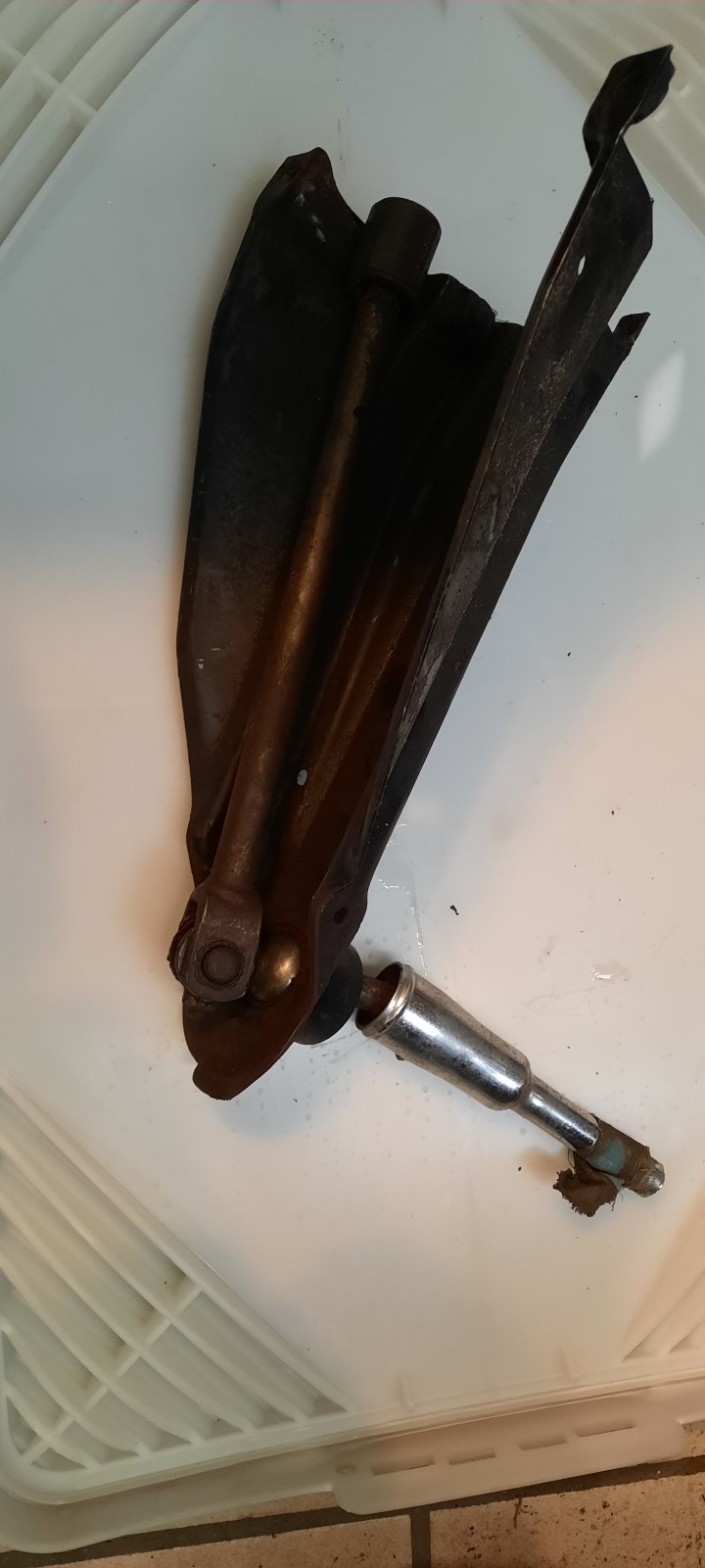

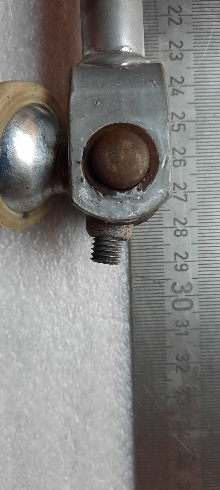

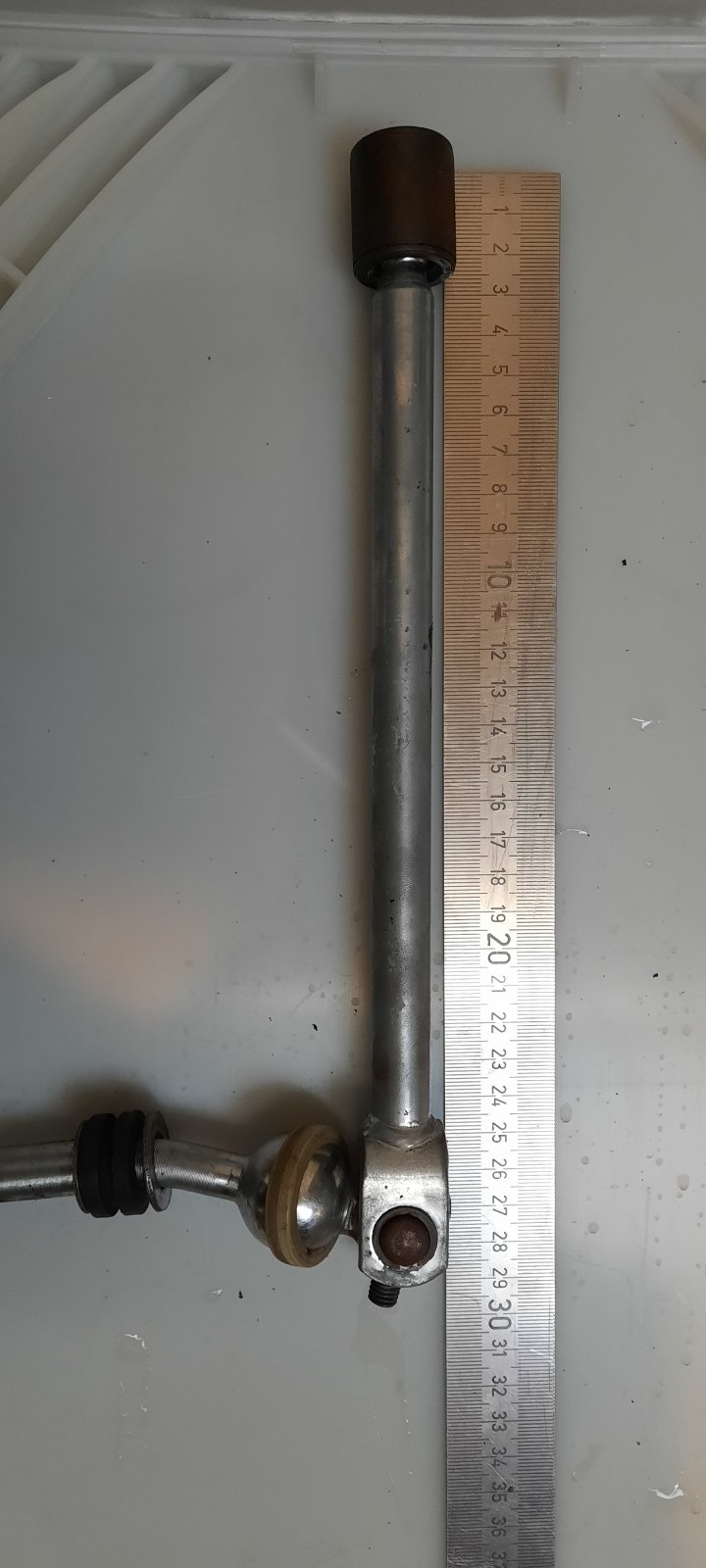

Mine is 10MM shorter at 278MM overall measuring like Thomas. Maybe its from a 2002?
