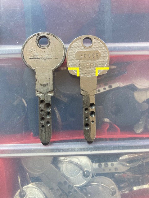

- you may convert the service/valet key into a general key by just cutting off the edges:
Source of picture: Gerhard R.
This would allow the service/valet key to slide as deep into the trunk/glovebox lock as the general key. (In fact the length of the inserting is the interlocking, not the seventh hole)

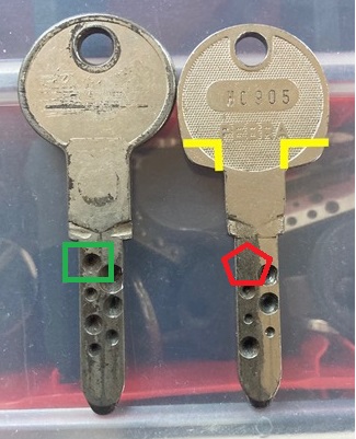

I think the length that stick inside the lock is actually defined by the shoulder (the step just above the red and green shapes in the pic below), and not so much by the begin of round circle/grip section (your yellow lines).

As to the point of the location of the 7th dimple: I do think that the 7th hole is always in the same location on the key.
Any master key that I have seen, always has a hole in the the top of the left row (green square in my image). In the service key (right in the image), that space is never occupied by a dimple (red pentagon):
So this may be actually in line with the pics from Gerhard and both our observations as written in the previous posts.

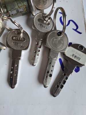

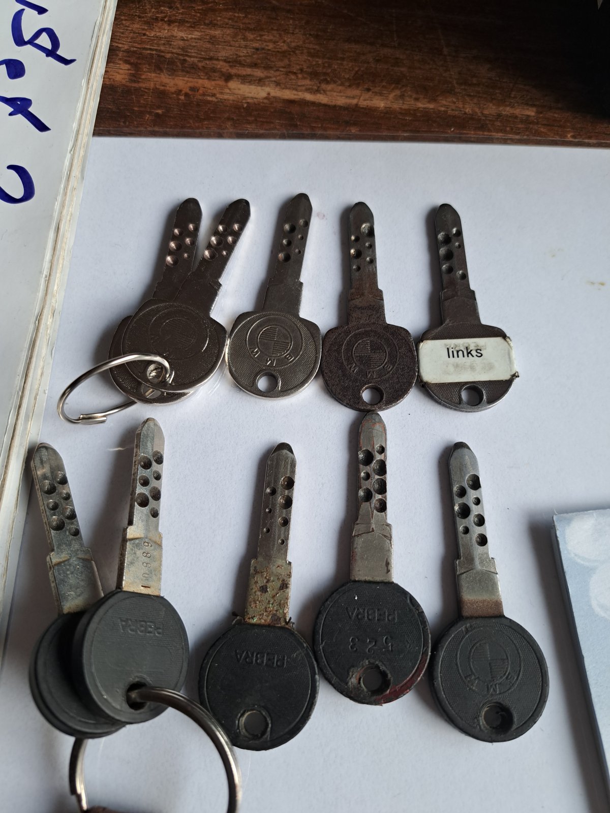

....all service/valet keys except the very left one do have a hole on top left position
It could also be that in your pic you effectively have 3 master keys, and one valet key (the left one)? I base this then solely on the number of dimples.
Conflicting, yes, as for an original master key I would have expected them to have the rubber cover.
They appear to have been made from blanks with the shoulders indicating them to be a valet key. Possibly they were cut like this as spare/replacement parts?

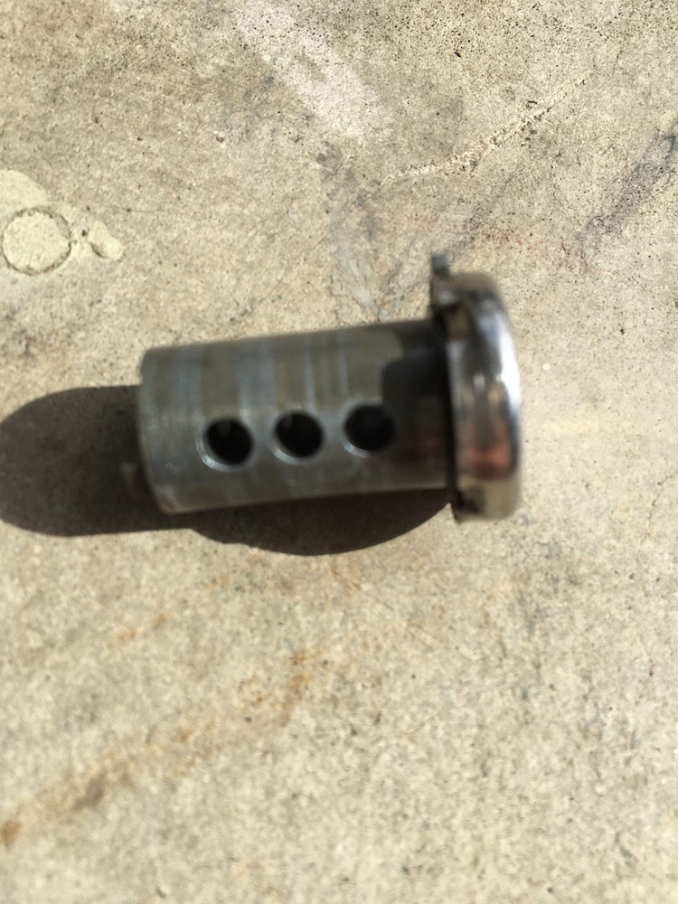

fyi; this picture from a member here actually shows an ignition barrel, and shows to have space for 7 pins:
one side 3 holes, 1736873402934.png and other side 4 holes:
. OP also found just 6 pins:
Now this would confirm my theory that even though it has 7 holes, only 6 of them are filled with pins.
source:
Thanks @Dick Steinkamp for sharing your disintegrated cilinder lock with us back in 2020!

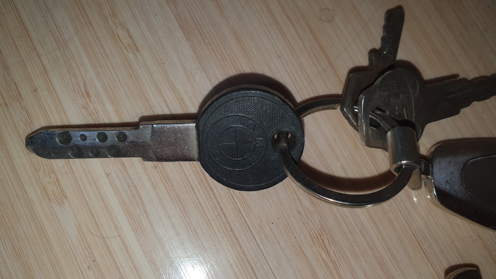

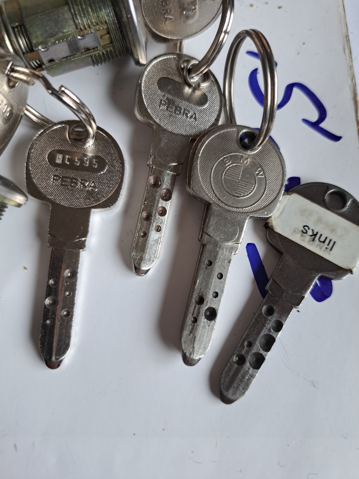

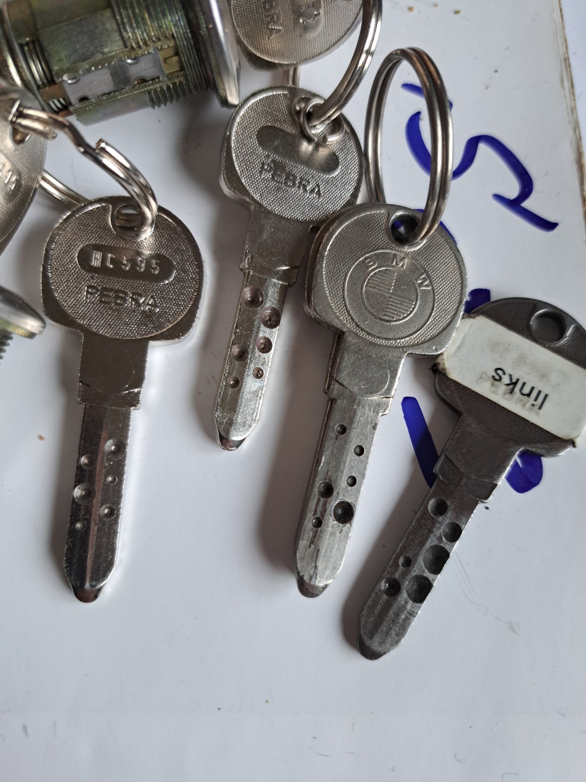

Got a just 2 preowned car with original keys as it seams.
With rubber all
w/o rubber service key.
Notice that just last week after I would show the car to a friend and picked the wrong key. :-(

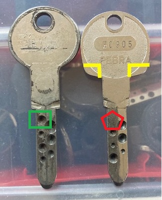

I'm going to take a look at the few locks I have on my workbench in my garage this evening.
As to the point of the trunk and glovebox also having just 6 tumblers; could it be that they have 6 tumblers, but one position is left empty, and an additional 7th position is used in those cylinders?

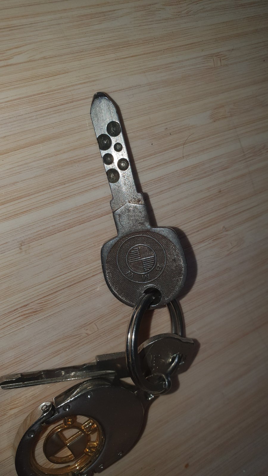

Unpacked a new set of keys and thought should post picture. The valet is undrilled at a different position than expected. Maybe they just randomly picked a spot?
