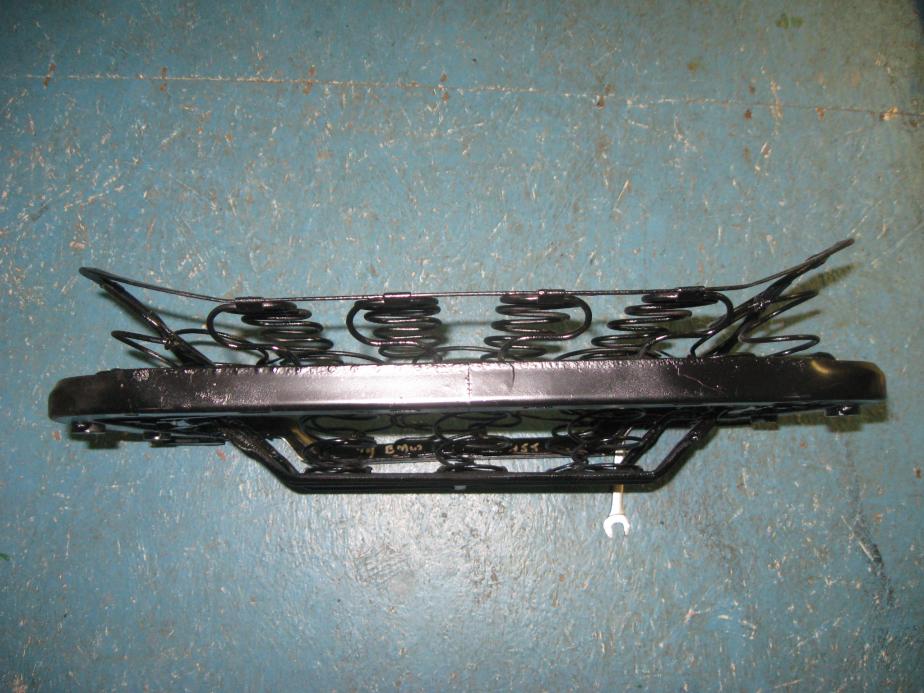

Here's a shot under the stock seats from my '69. They've been recovered but I assume the rest is original.
