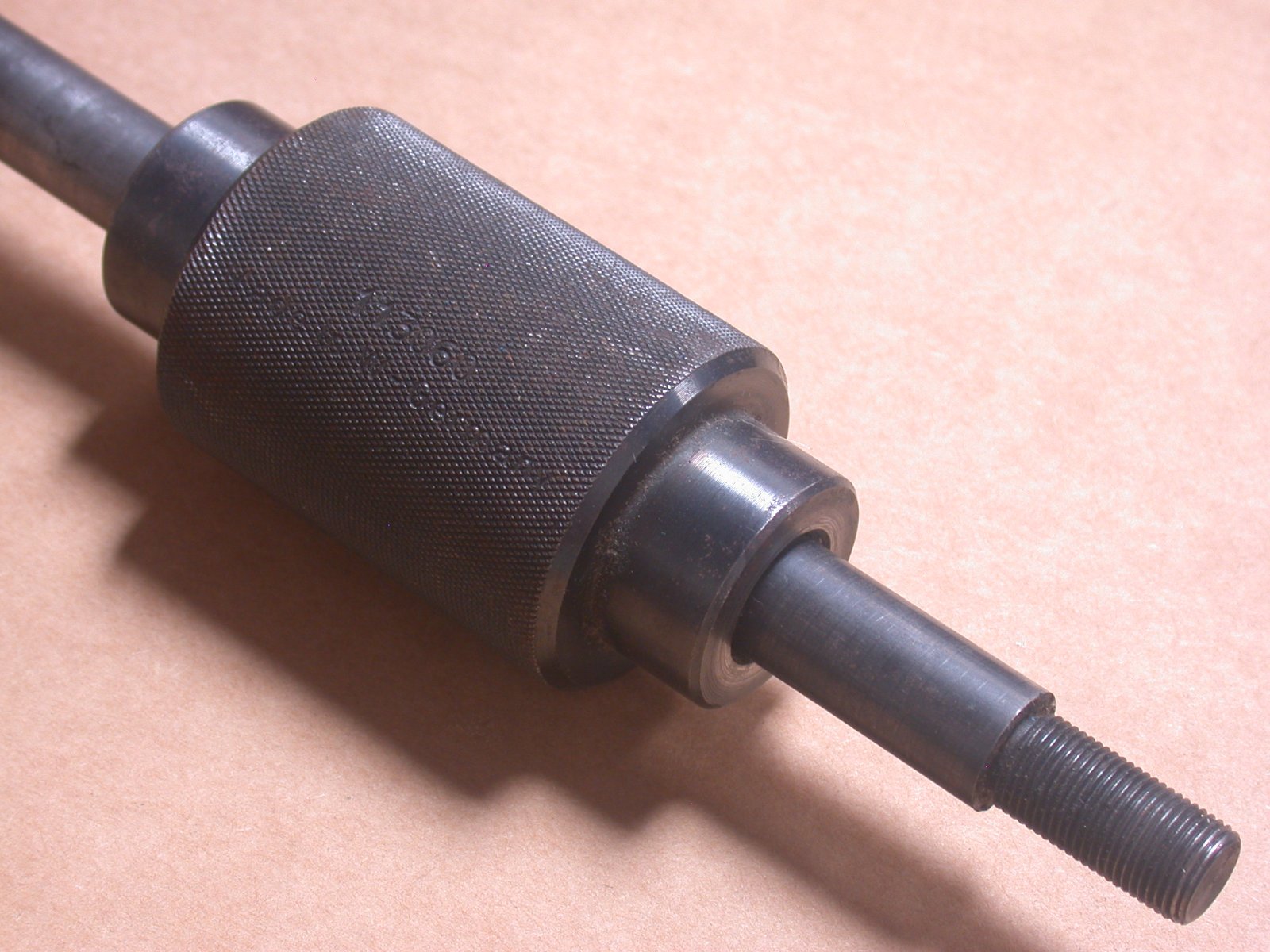

Wladek is correct, M12 x 1.00 mm, a very fine thread for M12 hardware.
McMaster-Carr has threaded rod in this size... https://www.mcmaster.com/95245A233/
The factory slide hammer tool...
