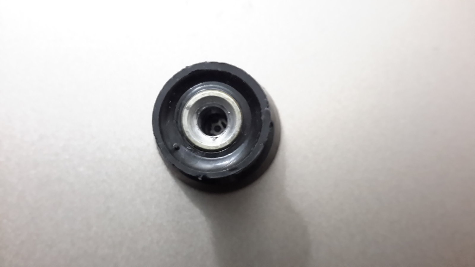

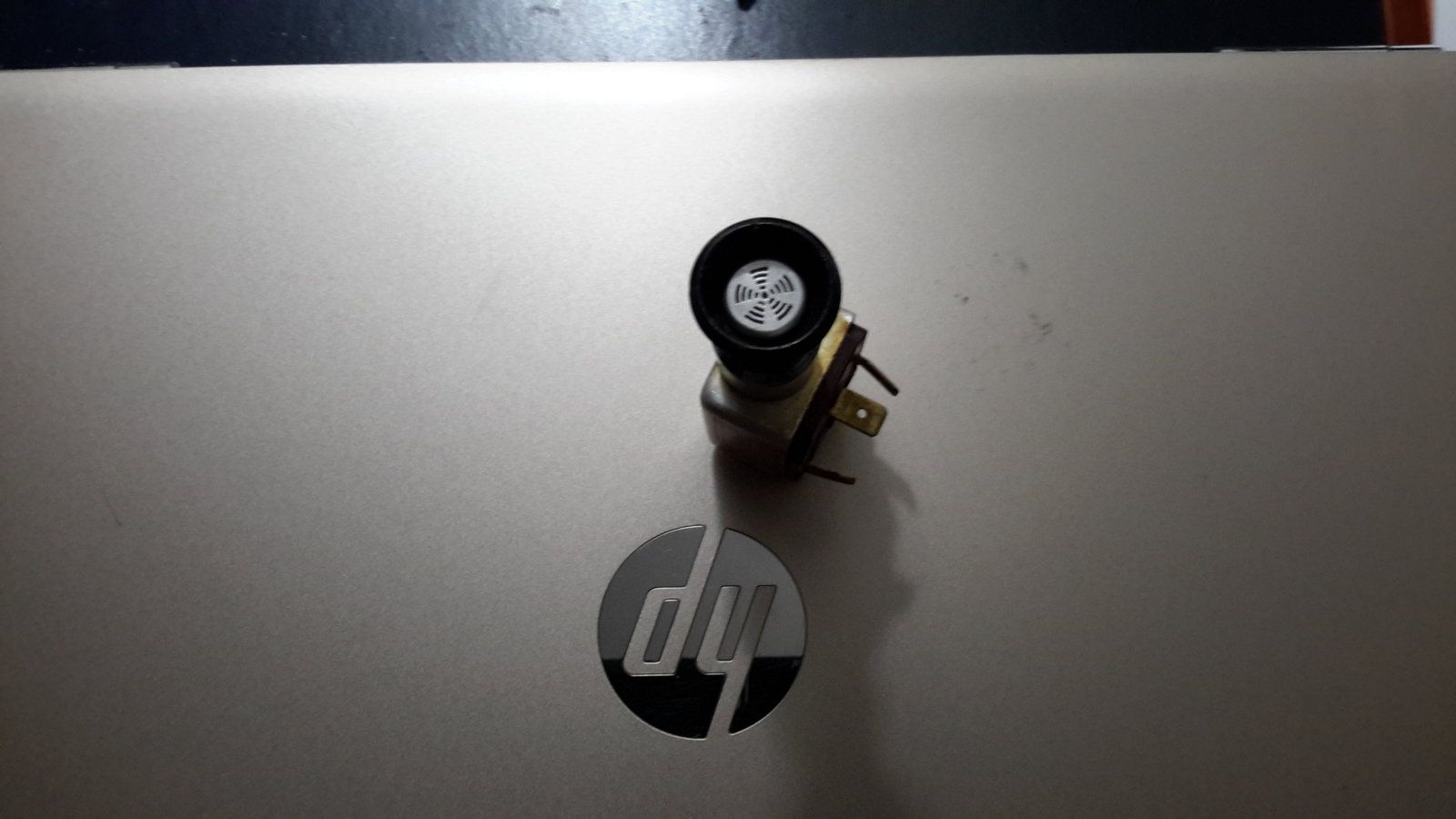

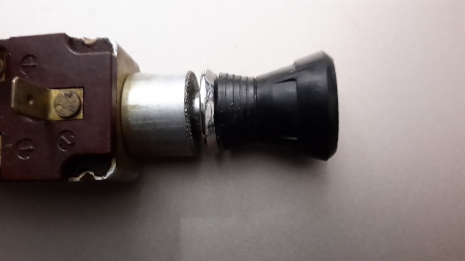

I recently found an early 2002 3 prong fan switch with the small style knob that looks very much like the hard to find odometer knob. It is a screw on type but can be made into a knob with a hole drilled for a 5x3mm set screw. I forgot to mention it has the fan decal in the center of the knob which will have to be covered with one without the decal or removed and replaced with one without a decal.

Here are the photos of the knob that could be easily made into an odometer knob.
