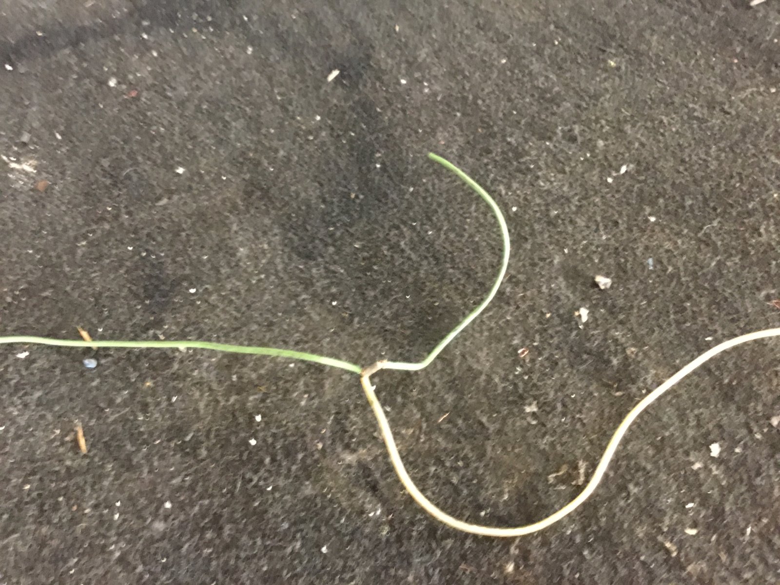

Lloyd- I’m at the shop...come by if you want or I can ride over.
Have more resister wire or can show you the point where green wire turns into resister wire.
Bottom line - filet your harness back from coil, remove burnt wire, inspect other wires, find crimp at green to resister wire and remove/replace with all green.
