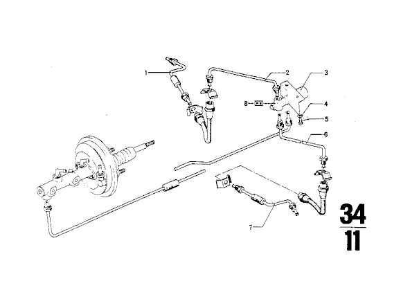

It sounds like your brake bias valve is leaking. It is located at the back of the car up above the diff. Number 3 in this picture:
It is not available new, but La Jolla Independent sells rebuilts on an exchange basis.
Andy, I can't favor that the bias valve is poor, if he is getting fluid from all bleeder ports on all calipers. This means that pressurized fluid is flowing to all calipers, theoretically carrying any air with it.
His symptoms are EXACTLY the symptoms of a bad bias valve. You still get fluid to the bleeders and everything bleeds out like normal. It just leaks internally under pressure resulting in a spongy pedal. I chased my tail on this one for a couple of months before figuring this out. It's not just some WAG I threw out there.
